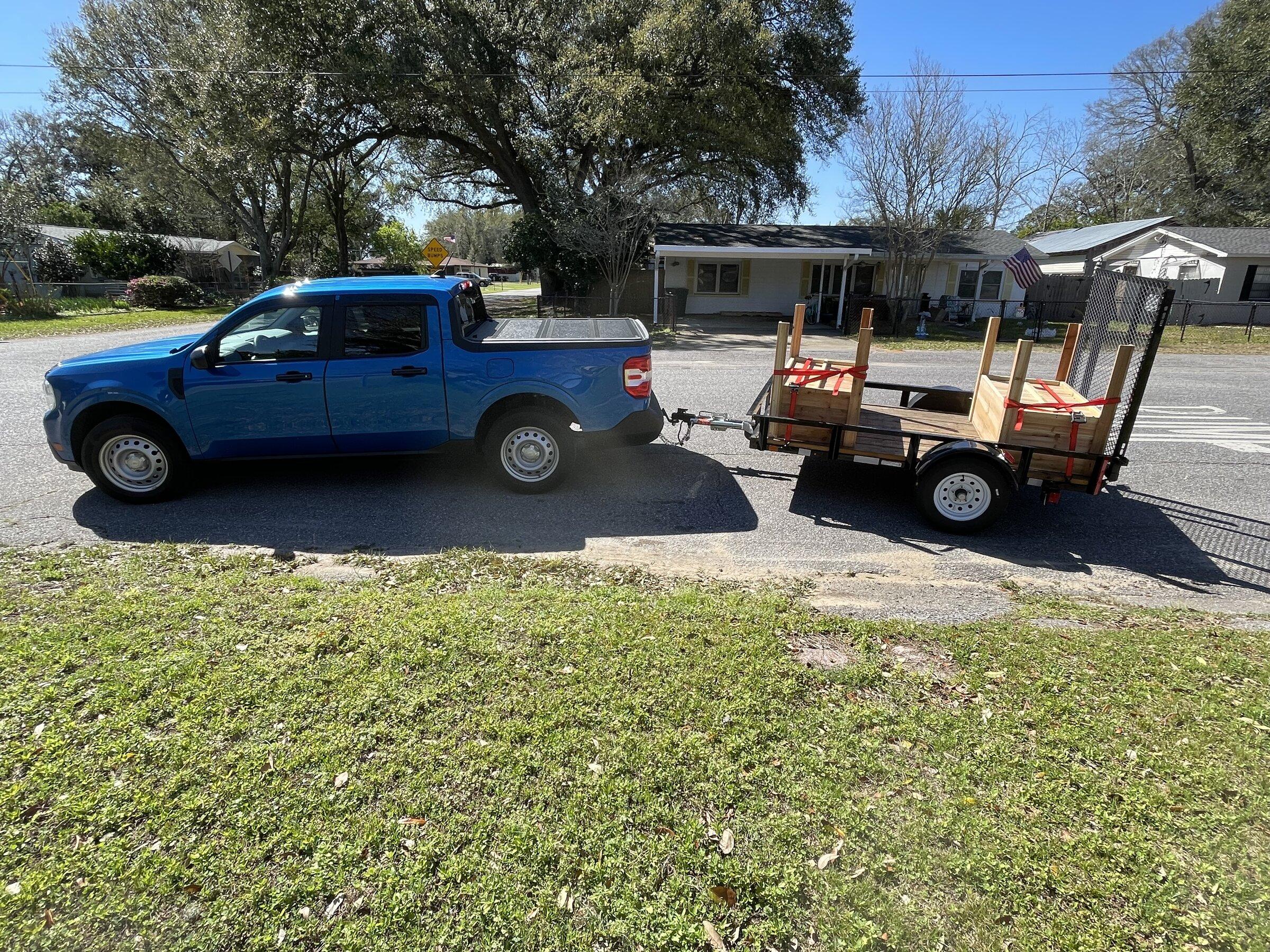

Yes, I purchased it at etrailer. I’m not electrically nor mechanically inclined, so I had the hitch shop install it.
Thats cool @RonR1959 , glad you got that sorted out!! Would love to see what you eventually tow. Success is so much more gratifying after all your efforts!
