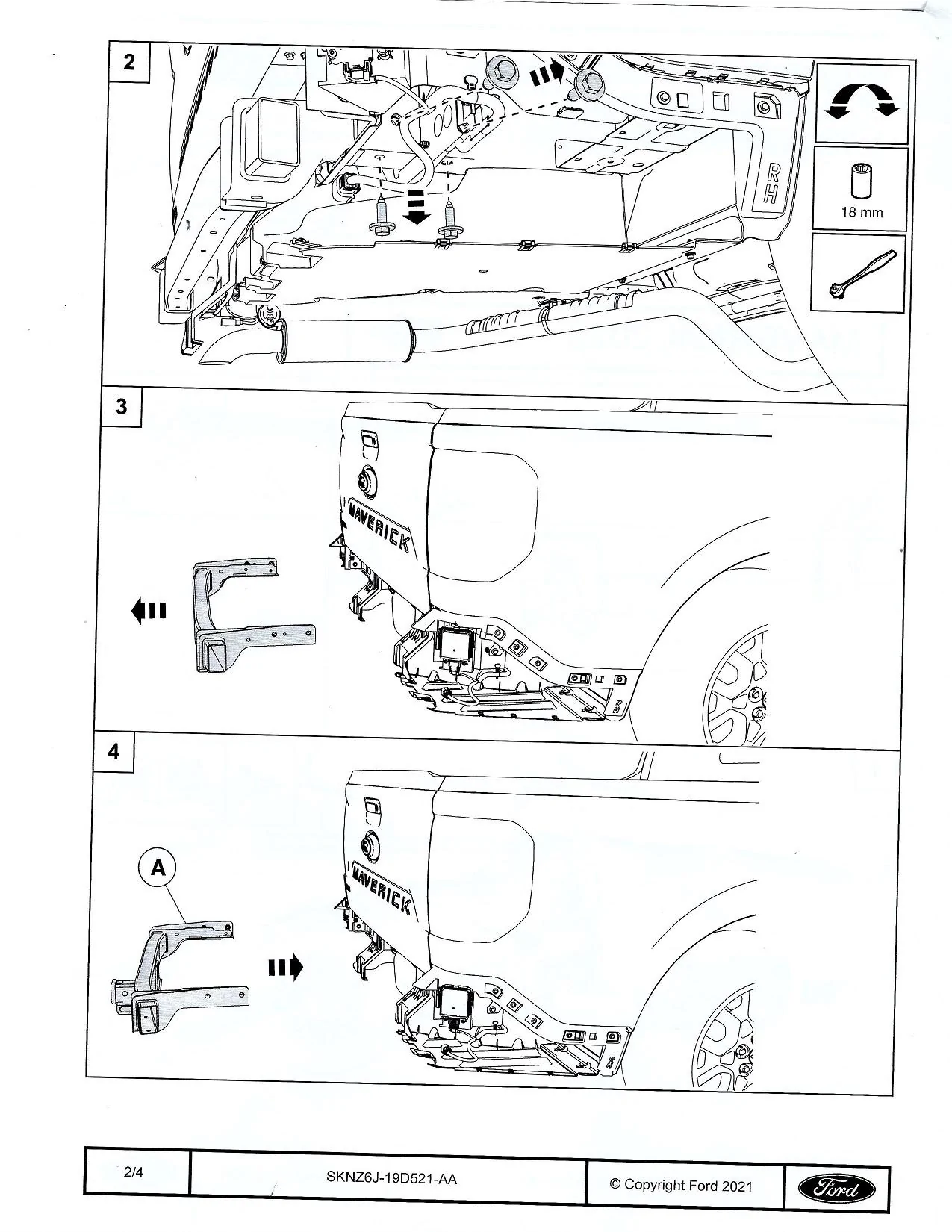

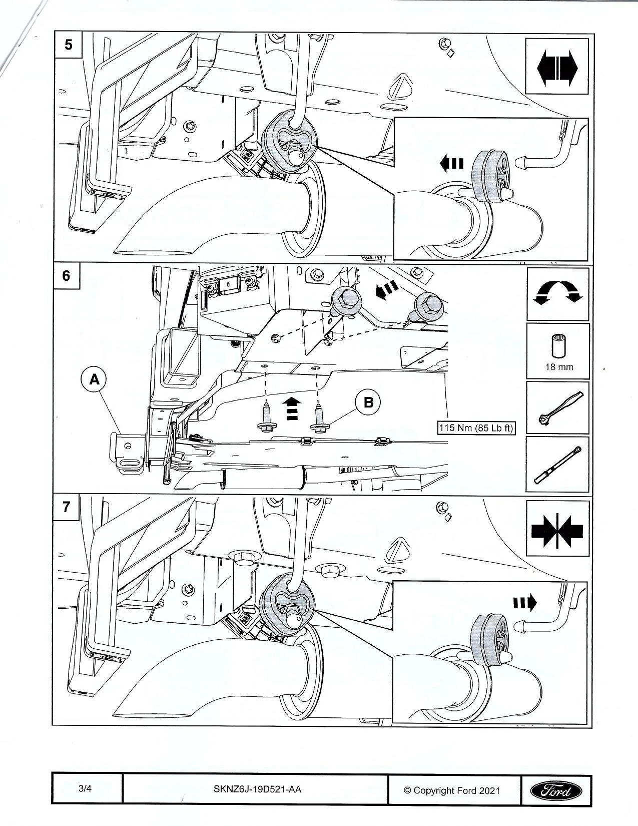

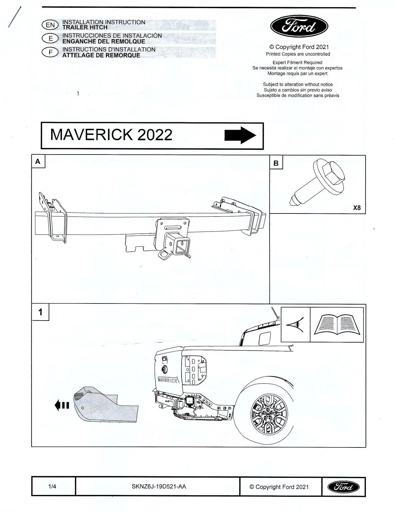

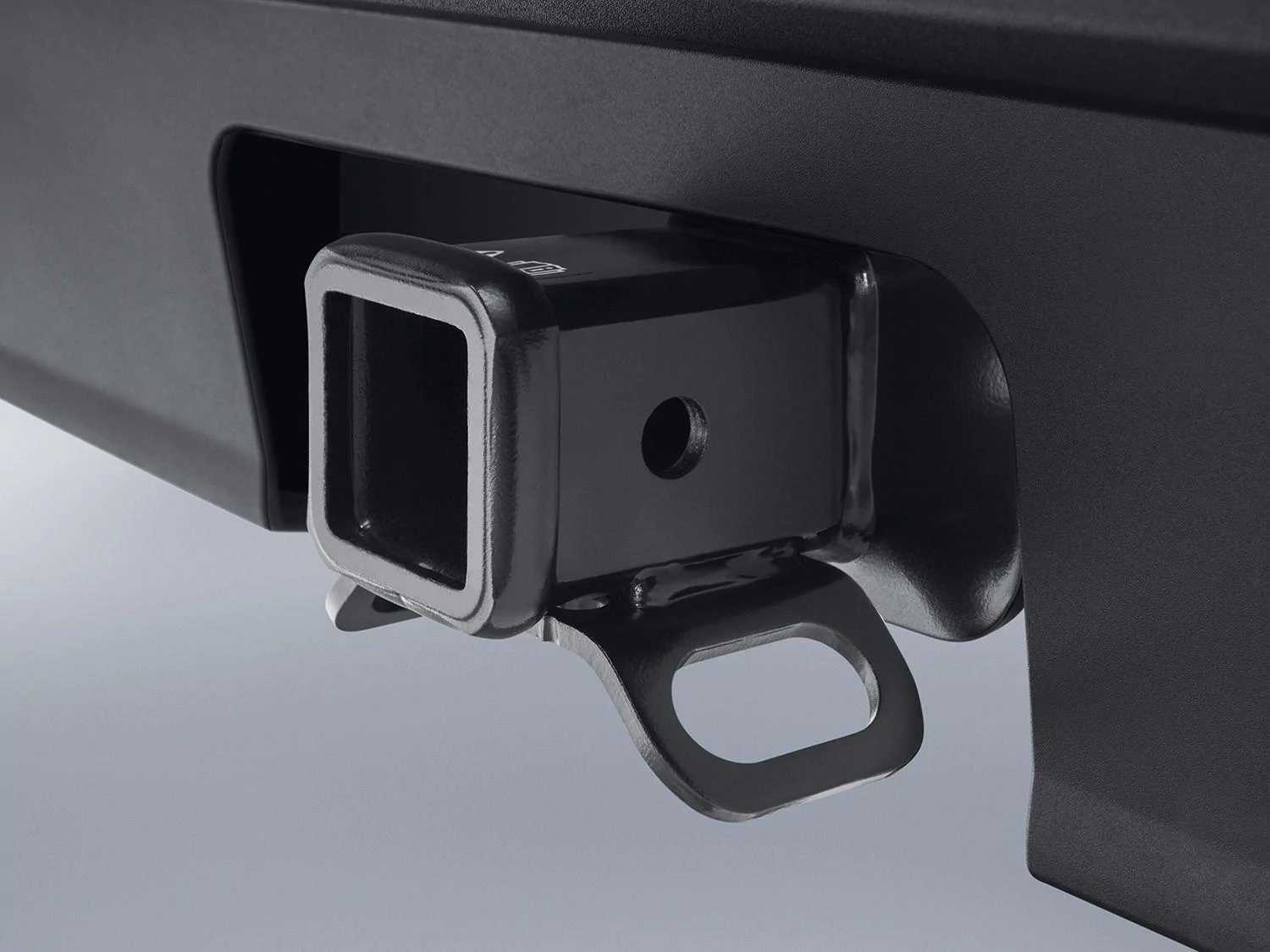

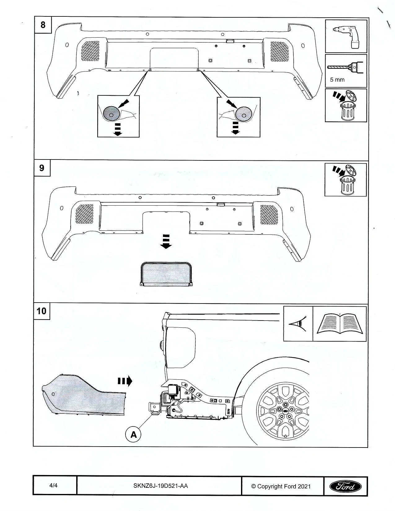

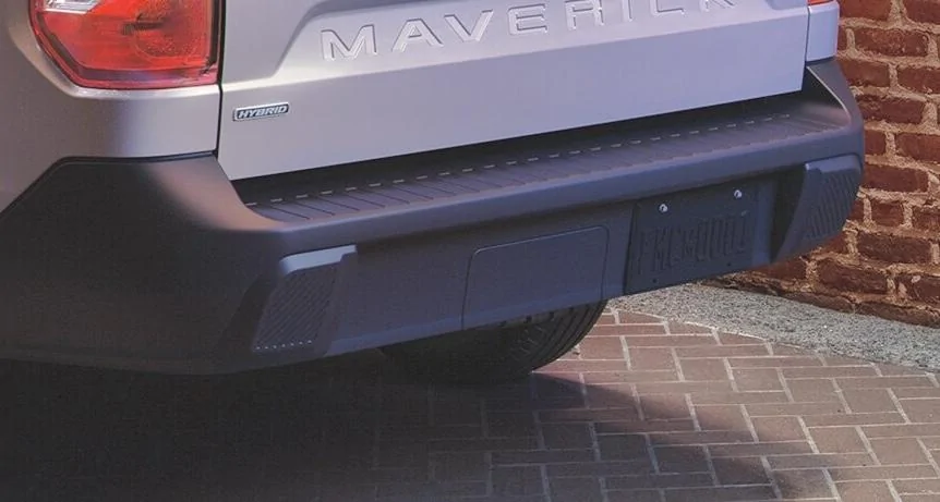

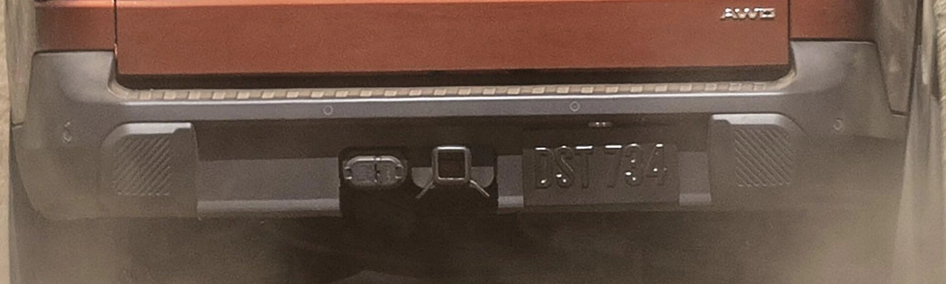

My truck did not come with the receiver. I looked at the Ford Accessories and they have one for $295. It says no drilling or welding required and says it uses existing holes to install. But from looking at the underside of my truck, there aren't any holes to bolt in to. Does anybody know how this bolts on?
