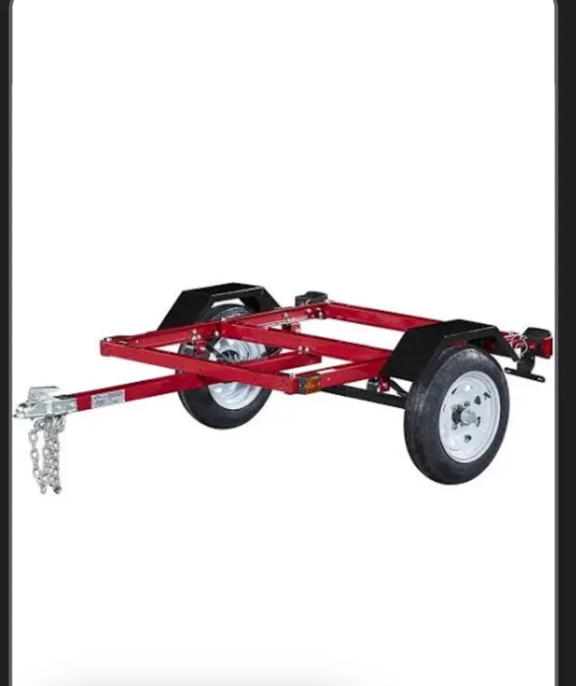

Something like this you can buy today with a 1 7/8" sure.
Ford Maverick Receiver trailer hitch tow "hook" IMG_7367

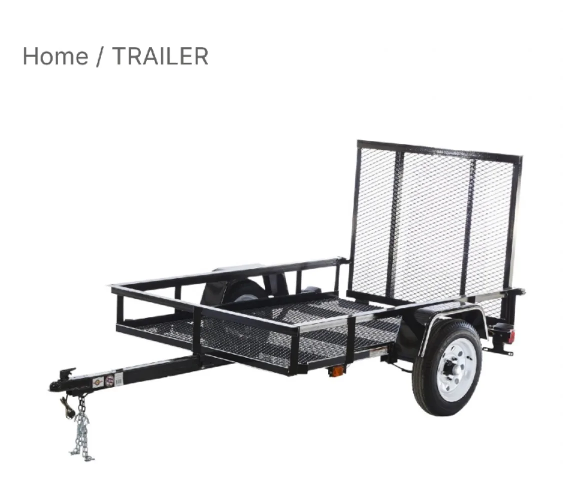

Like this and above, almost always will be 2".
Ford Maverick Receiver trailer hitch tow "hook" 1772000658537-gq
Because why not?
There is no advantage to using 1 7/8 and there is no disadvantage to using the much more common 2".
