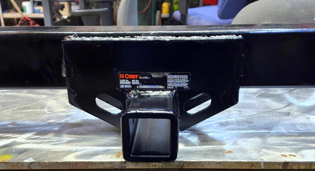

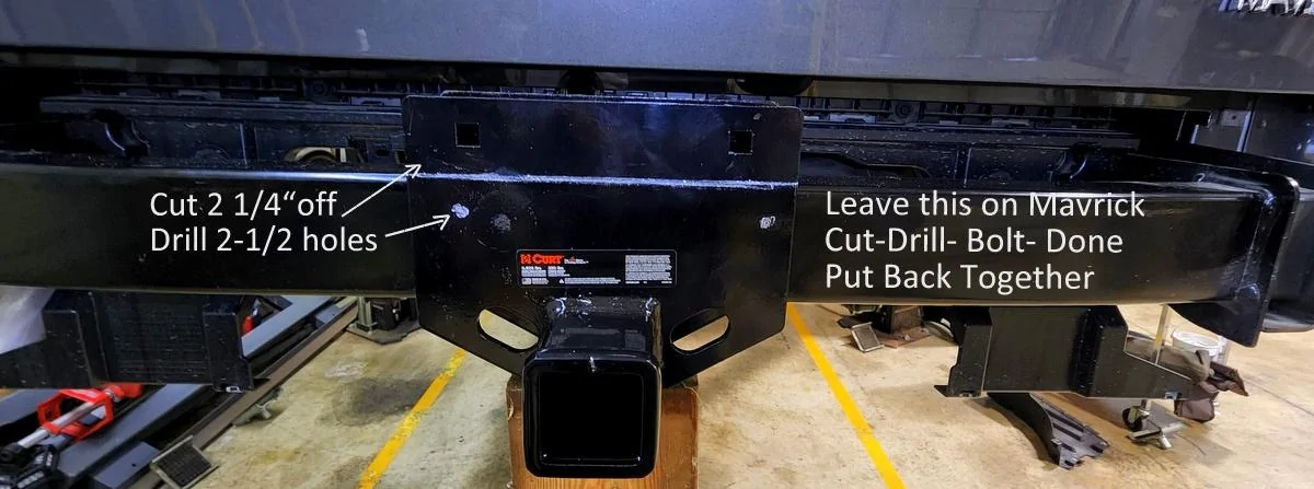

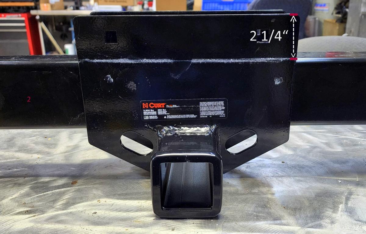

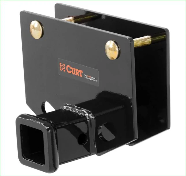

I am curious, if the receiver is just welded on to the crash bar, why doesn't Ford just offer the receiver itself without the new crash bar? For that matter it appears as though the receiver has holes in it for bolts to go thru, so why can't the existing crash bar just be drilled thru and a receiver be bolted on?
