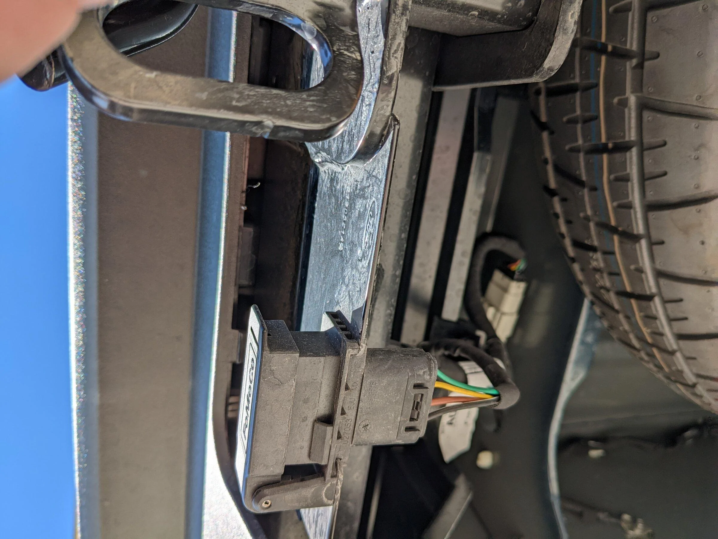

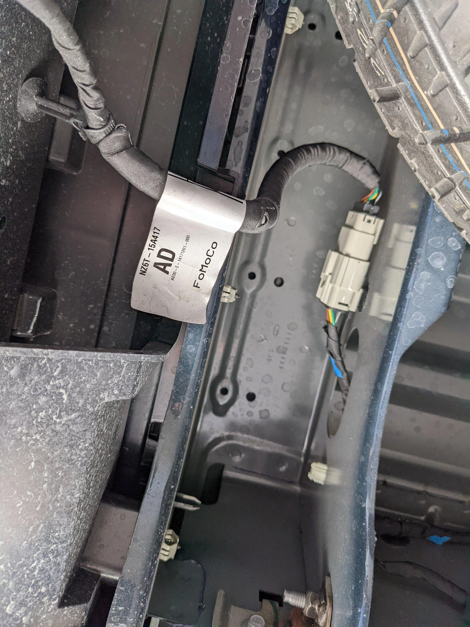

I see where there is a pigtail coming off of the 4 wire connector and plugging into a socket close to the spare tire. I am assuming that is there even if you didn't get the hitch factory installed. Should be pretty simple.
The picture is much appreciated. If I may impose, can you take a picture of the tag on that harness that would show the part number?

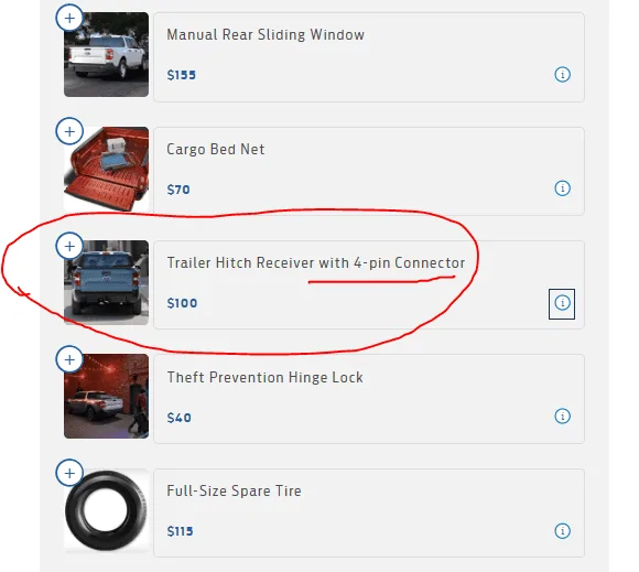

Does this answer your question?...
No, Please elaborate on your reply. Does the 4 pin connector come with PT# NZ6Z17D826C? It is clear that the hitch includes the harness if install at the factory but this is pertaining to purchasing and installing the tow package after production.
LOL NO..... that's a pic of the Maverick ordering guide. A question is whether the 4-pin pigtail comes with the receiver hitch when ordered seperately as an accessory....
