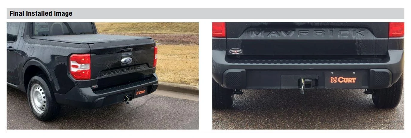

Don't you think that by the time you remove/reinstall the bumper cover, and modify/drill/sleeve the crash bar, doesn't the $200 extra to put the full Curt # 13504 on just make more sense?
HRG
From looking at mine. All I will need to do is lower the spare so I can drill it out then remove the small plate on the bumper cover where the hitch will be located.

I was hesitant about bolting without sleeving the 2x3 box. Sleeves would keep from crushing the tube or allow movement which would eventually elongate the holes.
fair point. like I said, we never even got to the ''what needs to be done for bolting'' stage. he went for the welder right away. and, yeah, I also don't like the other aftermarket lower position hitch option. especially on my truck, which sees brutal construction sites every day.

If that is the one that hangs down below the bumper, NO. That hitch is not an option for me.
Me either. It looks so aftermarket and when you used bed extender, bike rack or a cargo basket it just sets too low. If the bolt on work for jeeps and RVs without sleeving and worry then I'm sure it will be fine for my needs. It's a hybrid after all total tow capacity limited to 2klbs.
From what I can find, it looks like the Draw-Tite and Reese branded ones hang below the bumper and the Curt branded one sits at the same height as the factory installed one.
