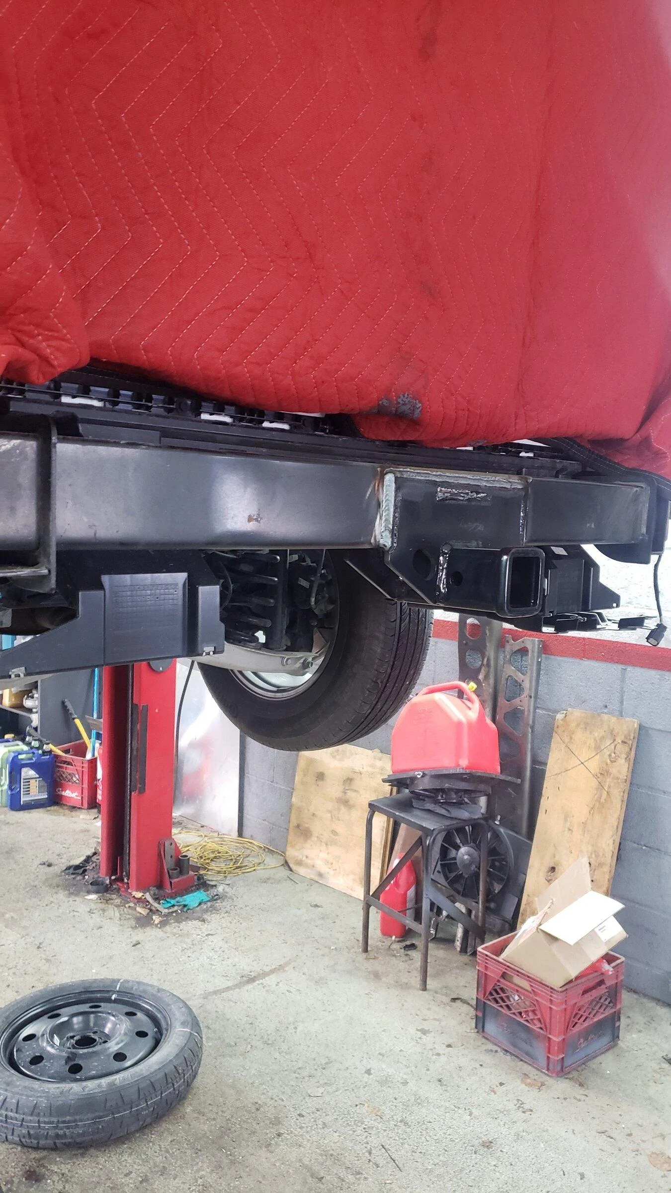

installed the curt hitch adapter/bronco sport harness. welded on, crash bar not removed from truck. everything went smooth, thanks to all that contributed info to this topic. also, we ran power off the 12V pigtails off the bed sides. nice and easy. again, thanks to all that contributed info. total cost including curt adapter, bronco sport harness, and labour was under $300 U.S. took about 3 hrs to do everyhing.
What are the dimensions of the factory crash bar tube? I'm looking for this curt hitch but just want to drill and bolt.
I believe the crash bar is 2 1/8 by 3 something. Not sure of the exact height. I plan to do the same thing. But you need to cut a bit off the top and redrill the receiver if you want it to fit right on it. Otherwise it would be lower and have a gap between the bottom of the crash bar and the receiver
No idea on dimensions. I happily took other members info/know how and applied it. Bolting should be ok, just have to drill and use proper grade bolts/nuts.
I was hesitant about bolting without sleeving the 2x3 box. Sleeves would keep from crushing the tube or allow movement which would eventually elongate the holes.
Don't you think that by the time you remove/reinstall the bumper cover, and modify/drill/sleeve the crash bar, doesn't the $200 extra to put the full Curt # 13504 on just make more sense?
HRG
If that is the one that hangs down below the bumper, NO. That hitch is not an option for me.
