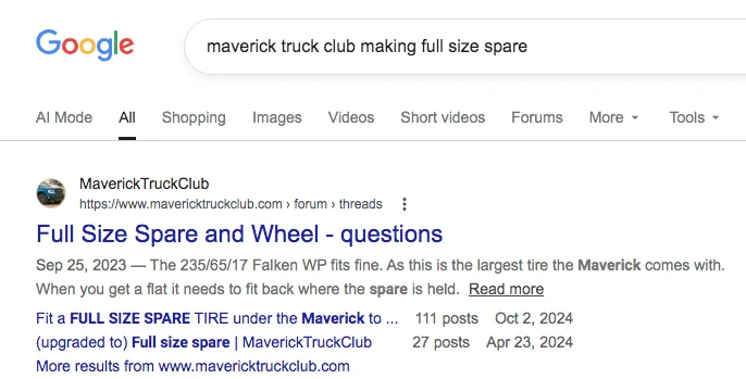

Really…. These new questions that have been asked and covered over and over get old!
If there wasn’t the internet I could understand
I have an idea …. Google?
And yet you take the time to read and respond to a topic that you are bored with.....
OP wanted to ask actual people, not the internet with it's boiled down answers, about a topic. That's why we're here. Novices and "experts."

Actually - the idea is the Google search function on MTC throws you to the threads with actual people.
Actually a search of Google for MTC does the same.
I'll bet the 2nd link is great!
(perhaps title is a tad long)
And it's not even in the 5 similar below.
