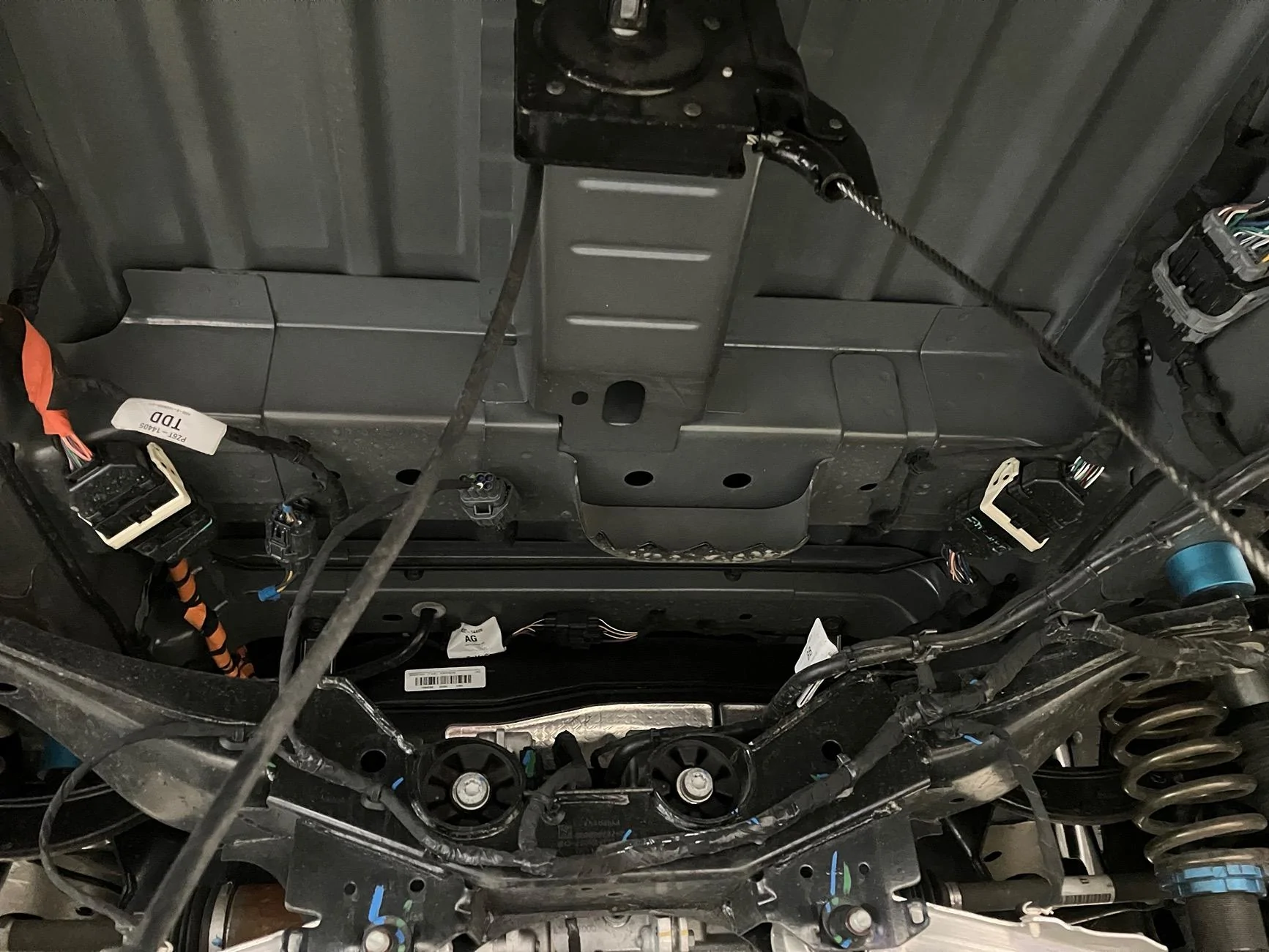

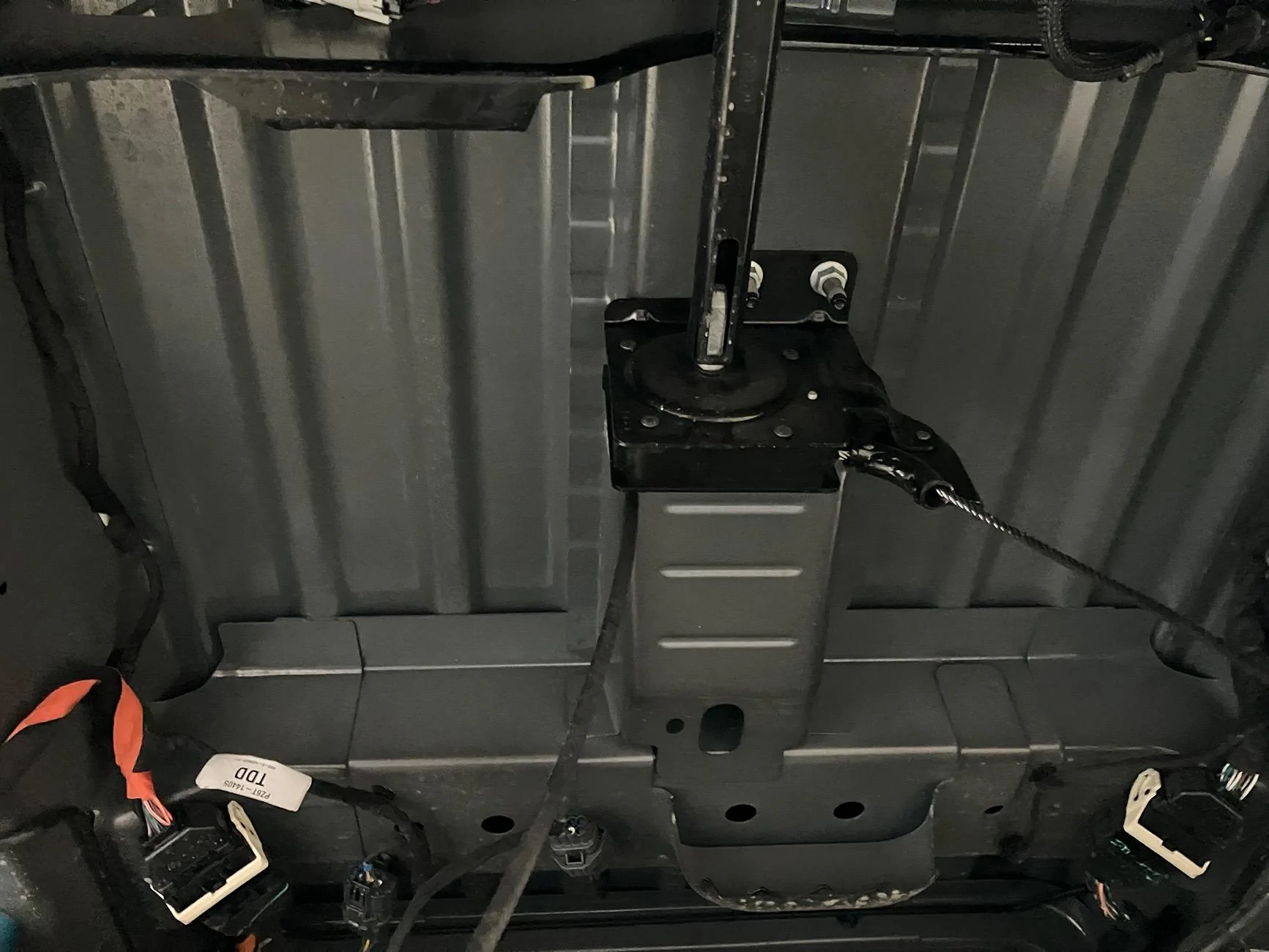

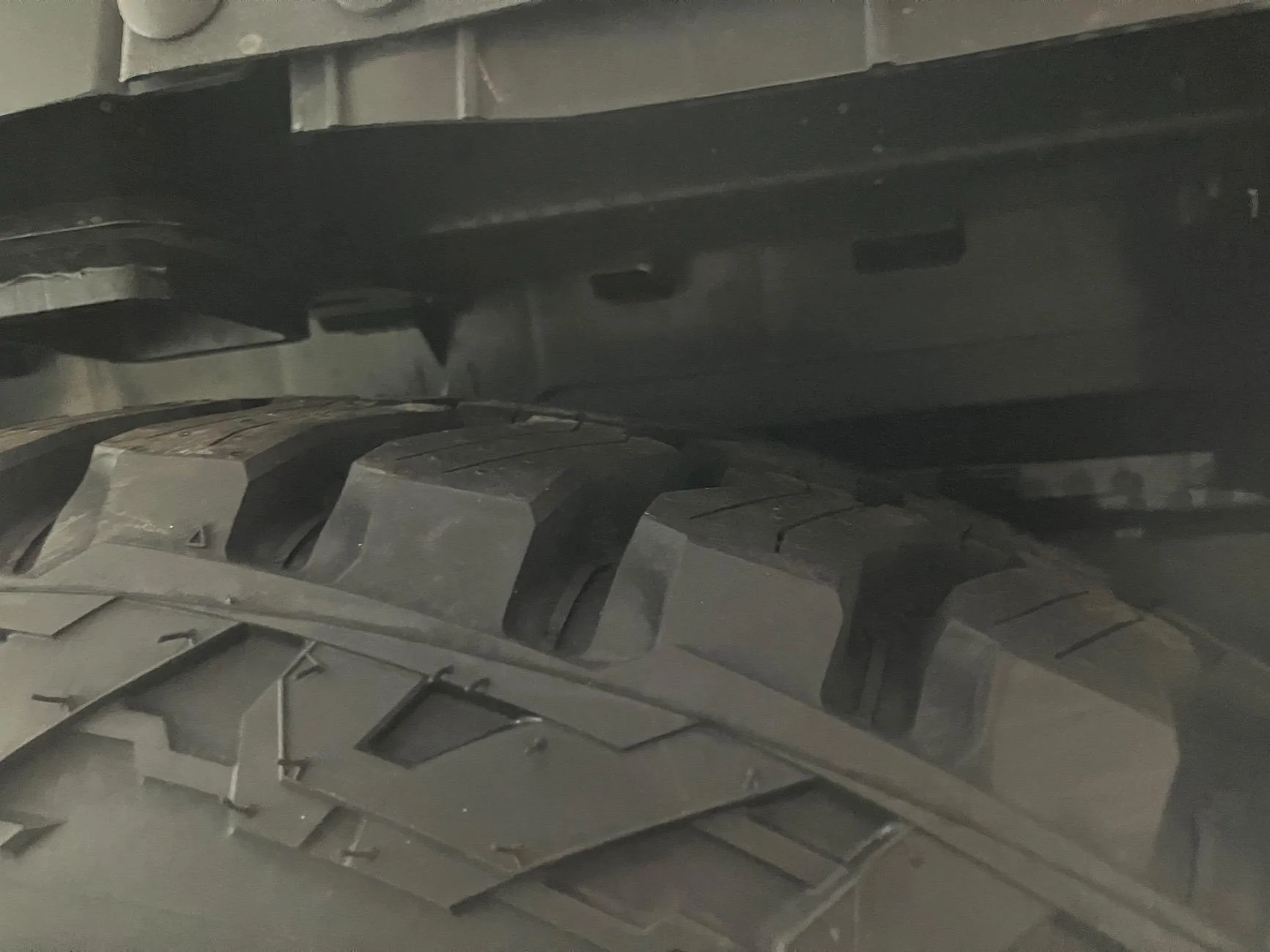

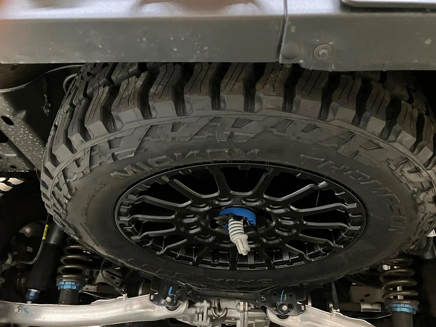

I added a 245/64/17” with matching wheel for my spare tire. Fits, but tight. Front sits on front teeth bracket. I also, carry small lightweight floor jack and breaker bar for my long trips.
I did remove OEM exhaust and have an AFE side. Not sure this would fit with OEM exhaust.
Awesome! I've got a 225 slung up under there and it is also tight, especially if you don't coax the tire rearward as you hoist it up. I don't like my spare anywhere near pointy things though and will be cutting off those teeth soon.

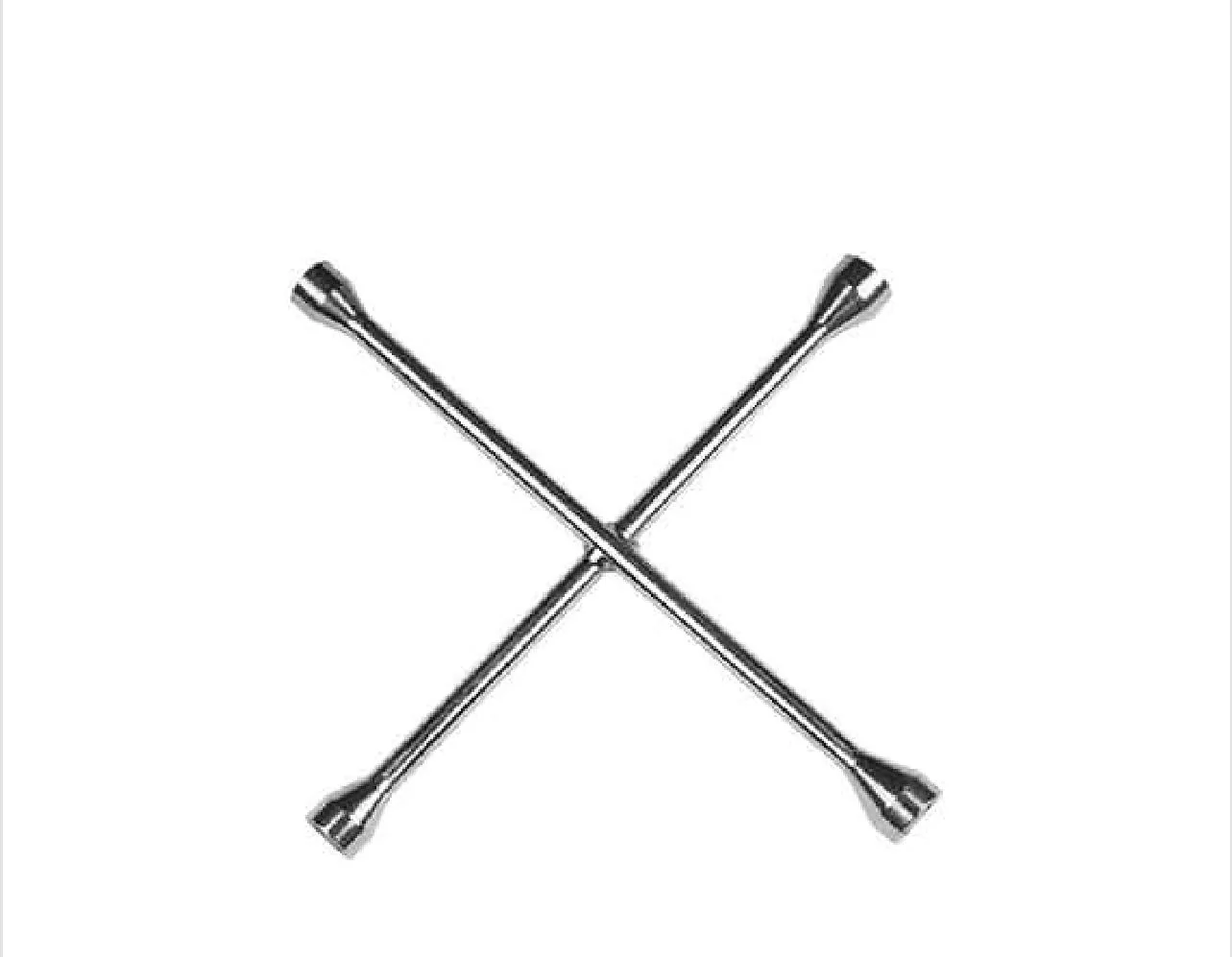

Actually, following all the post I meant one of these, I use to have one.
Ford Maverick Spare Tire Wisdom IMG_0972
Jah.
Have one each for Mav and Camry . plus a metal pipe extension that fits over the wrench ends for more leverage if needed . Also always carry old area rugs in each vehicle to sit on while changing a tire or ECT .
