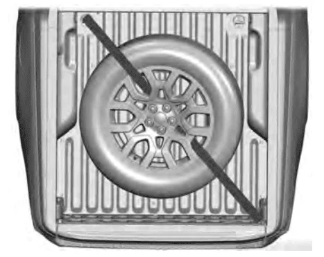

Regular size "road wheel" (not a spare) will apparently not fit under the bed of the truck. Stowing the road wheel (i.e. the tires that come on the truck) is done in the bed of the truck (see picture). Check out pagers 351-352 of the owners manual.

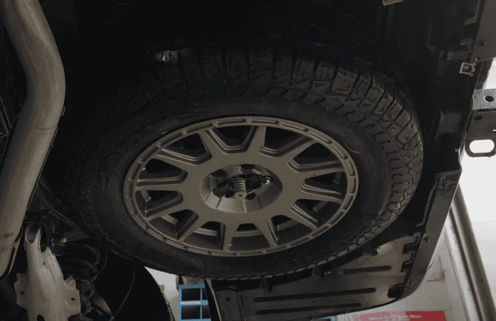

That's mostly because you can't use the lowering cable with a stock wheel because of the center hole. It's possible to fit stock or even fairly oversized tire mounted on the spare steel wheel.
Here's a 245/65R17 on aftermarket wheel from this video. No mention of needing to modify the 'tire catcher' to fit either.
