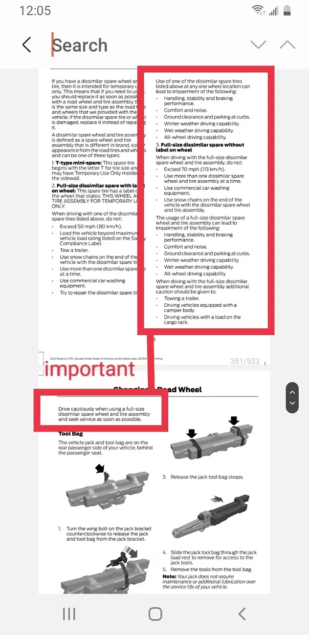

They must have missed the warning label. They used to be actually imprinted in the sidewalls.
Ford Maverick spare tire different 20260511_112855
What good is a spare tire if you can't safely use it....

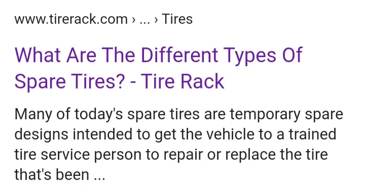

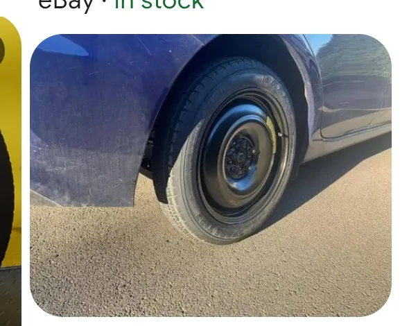

What kind of spare tire are you referring to?
Ford Maverick spare tire different 20260511_112512
Do you think ANY manufacturer provide a spare tire that is NOT safe to use following the instructions for it's use? Yeah they love those liability lawsuits so much they intentionally provide unsafe items on their vehicles 🤣

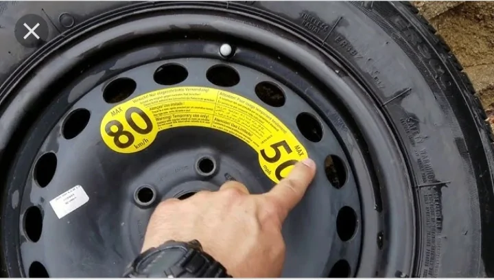

What's a micro spare?
I agree if you're talking about one of these.
