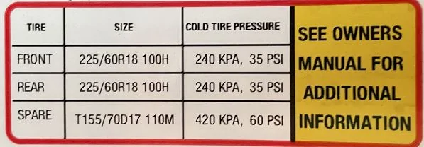

My tire sizes, including the spare tire are:
Ford Maverick Spare tire size... tir
The spare tire is a good'ol doughnut and the tire height/diameter is 3.1" less and about 85 rotation more in a mile than the 18" tires. The chances are it is ok on the road, but not on the driven wheels. If the doughnut replaced by 225/65R17 tire, it would be 0.1" less height/diameter and about four rotation more in a mile than the 18" tires. The question is, will it fit into space where the doughnut is under the truck?

That's pretty amazing because my 245/65R17 had plenty of room.
Take off a drive tire and stick it up there. I did it with my KO2 and it fit fine. Just make sure to get the little blue spacer back on there properly lol. I didn't the first time and it was a disaster. You can see my report on page 2 of my build log in my sig. Also there is this thread:

I don't think that there is any manufacturer that would use an alloy wheel as a spare.
They used to, my '98 F150 STX had full size spare, including the alloy wheel and even the tire matched. The '05 Toyota Avalon also has full size spare, including alloy rim, still have the car and love it. I guess it cut into profitability and they cut it out by now... ;)
It's good to know that the 18" wheel would fit up there, off to search junkyard for 18" wheel that would fit the Maverick.
