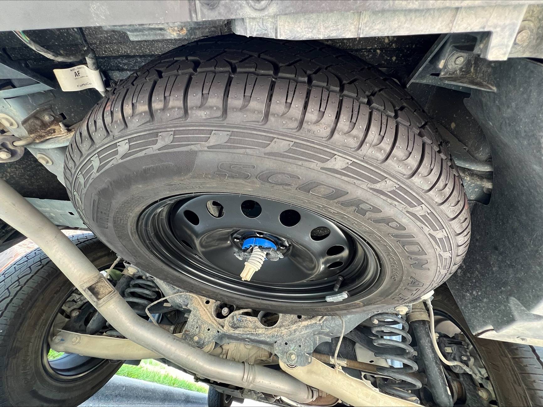

This is my FX4 with a "FULL full-size" tire. This is exactly the same tire that came on the other 4 alloy wheels, except on a $85 steel wheel.

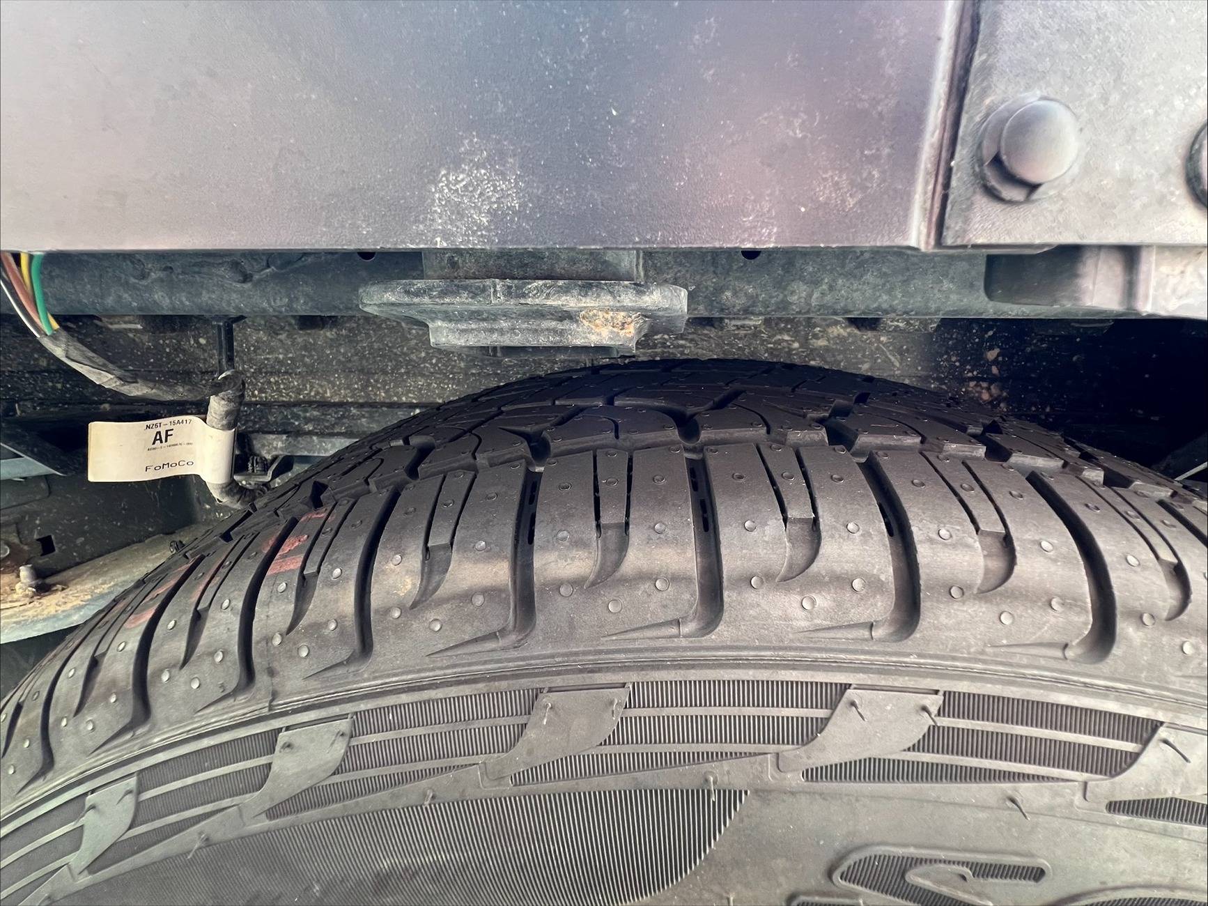

Clearance at the back is at least 1/4".

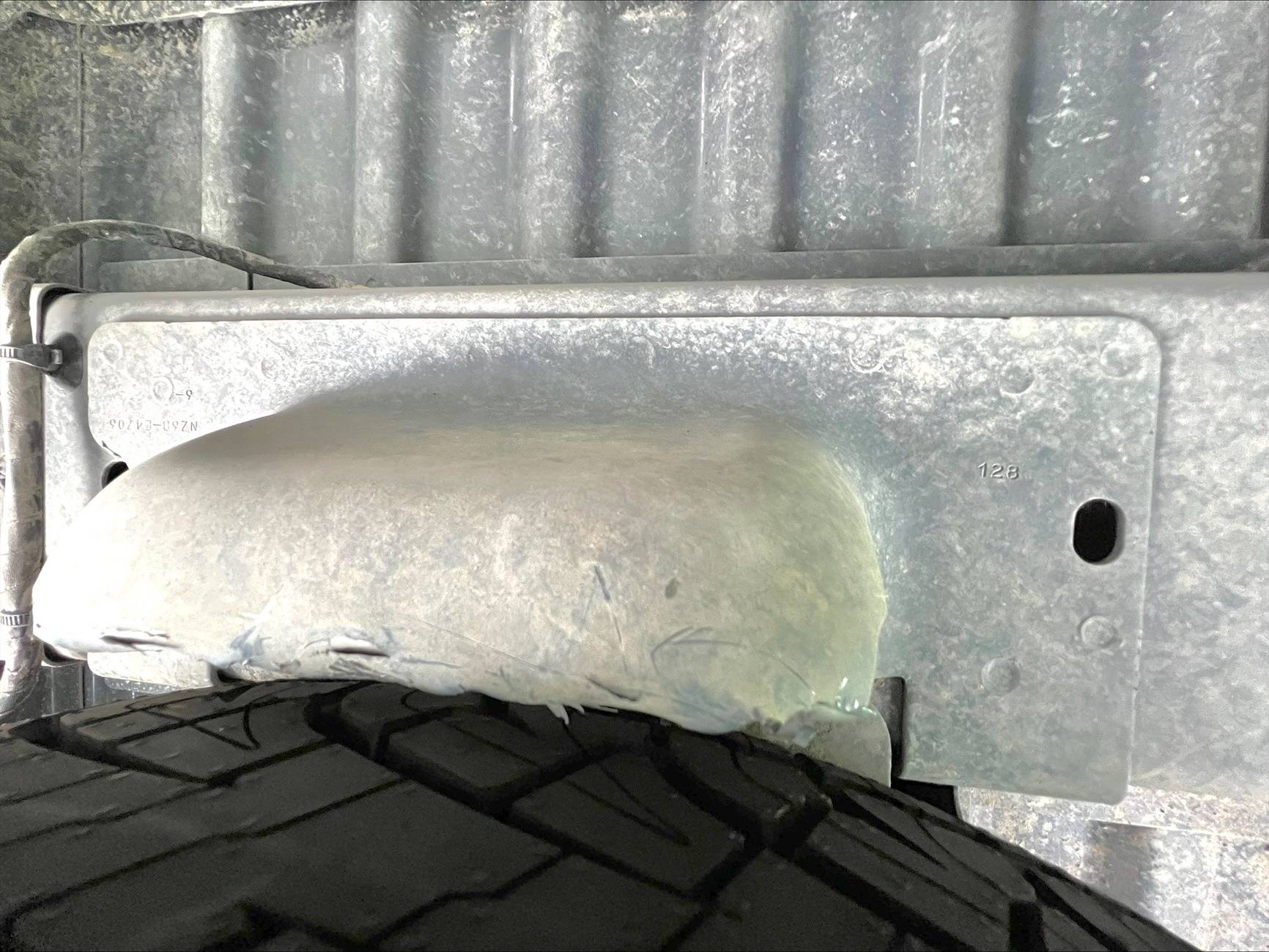

Bulbous lump is stamped metal teeth; here they are hammered out of the way until I can cut them off better. If I had not messed with them already, I think there would be very little to no clearance, even if I shifted the tire against the hitch (which I really don't want to do, either). Clearance here is more or less 1/4" at the moment.
