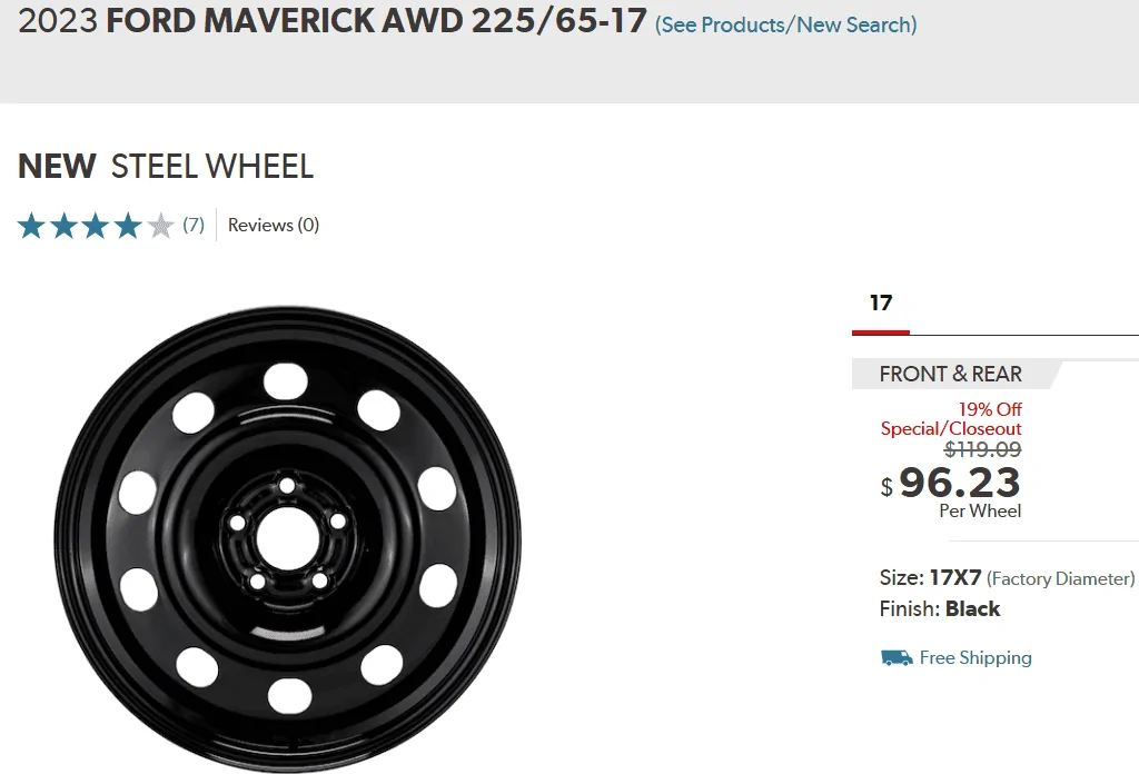

I would be interested in hearing what you find for a spare. Thanks
I basically got something like this. This is Tire Rack, but I bought from Discount Tire, which was only $86 for the wheel at the time. Had them put a matching Pirelli Scorpion on it, and called it done.
A full-size tire fits on my EcoBoost, but as I mentioned somewhere else, it puts the tire precariously close to the stamped "deflator teeth" under the body. I am dealing with those to make the full-size spare a long-term solution.
I'd be curious to hear what size holes for the lug studs that wheel has (sized for 12mm or 14mm). A long time ago, a member related that an aftermarket steelie did not work well with the Mavericks 14mm lug nuts. I know the BAP wheels I bought that are offered for the Bronco Sports has smaller diameter holes than the OEM BAP wheels I took off my '24.
