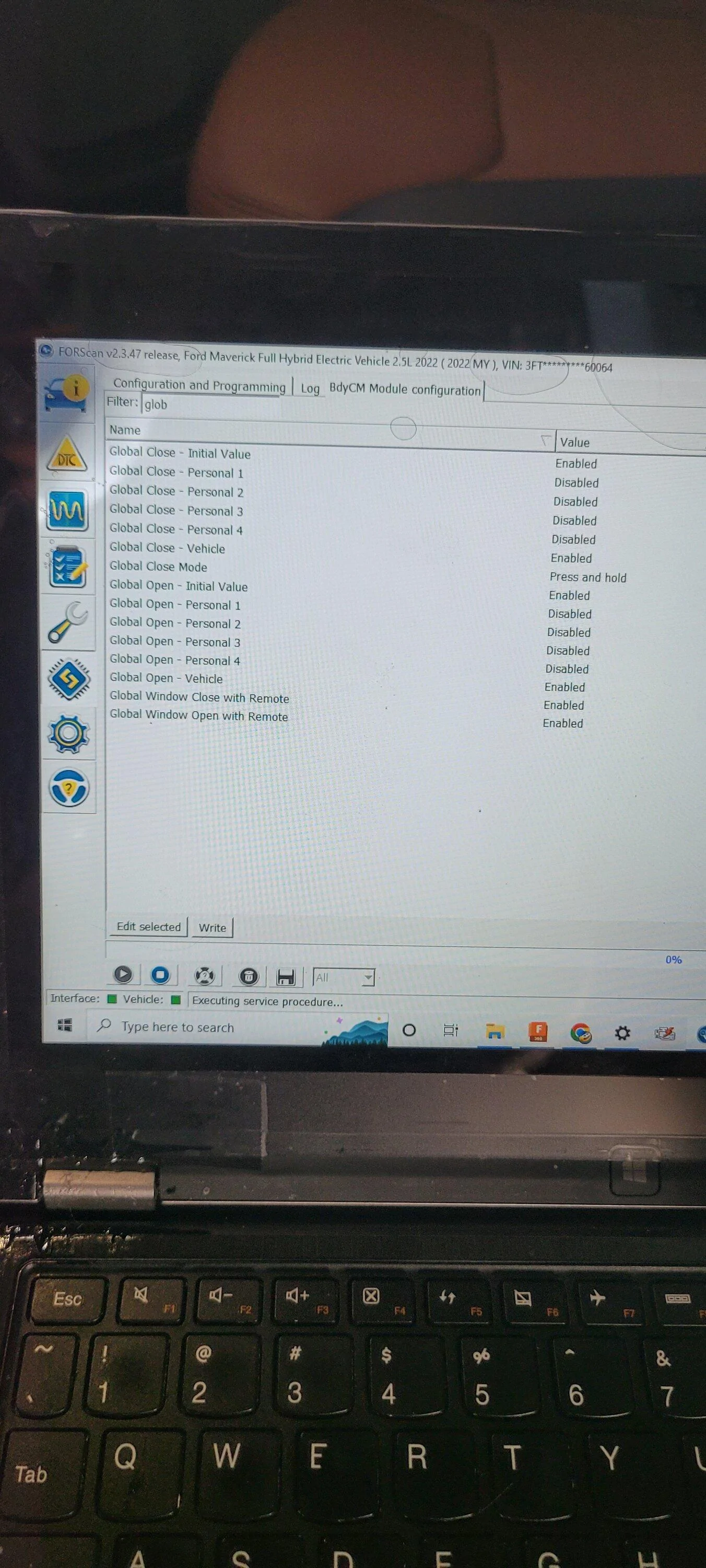

Global Window Open Confirmed Working (Lariat Only)

A software program called Forscan enables you to open/close your windows with the keyfob. This may only work on certain models. I believe it requires the window to have auto up and down at the door switch. I don't know if XL/XLT have that.
I've ordered an XLT non lux, I think the auto down is driver's side only. I wonder if this works just roll down the drivers side, or if it's simply unavailable.
Also, does using Forscan void warranty?

Anyone around Richmond VA that could enable the remote window opening for me? Or know if the dealership would do it?
I am without the necessary hardware unfortunately.

Do some models not have power windows ?
XL, XLT have conventional, hard wired power windows with just one touch down for the driver. Lariat have all 4 power windows controlled by individual door modules, which lets them one touch open and close, and allows for remote operation and global open/close.

Did you ever get global close to work? My global open worked fine, but not the close.
I’ve continued to play around with other settings and no luck.

Confirmed working on another hybrid lariat lux. Took a few tries to get it to work.
