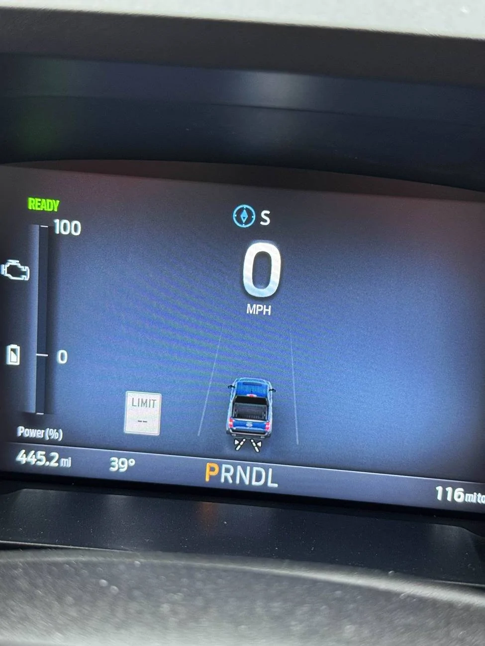

OK folks, just did this today. Thanks to @BlackMav23 If you have the 6.5-inch cluster and use easy mode, here's what you want to do to activate speed limit sign recognition and not get the European circular signs.
If you are interested, the following worked for my XLT FX4:​
  • IPC
    • Disable “Traffic Sign Recognition (TSR)” (THIS SEEMS COUNTER-INTUITIVE, BUT IF YOU ACTIVATE TRAFFIC SIGN RECOGNITION YOU'LL GET THE CIRCULAR SIGN ICONS. YOU WANT TO DISABLE IT.)
      • Enable “Speed Limit Information Function (SLIF)”
  • IPMA
    • Set Traffic Sign Recognition (TSR) to “SLIF” (THIS IS WHERE YOU ARE TELLING THE TRUCK TO ONLY READY SPEED LIMIT SIGNS AND NOT ANY OTHER KIND OF SIGNS)
      • Set Traffic Sign Recognition Mode to “Camera Data Only”
    • From there you will have to enable it in the menus of the vehicle itself. (FROM THE MENU ON THE STEERING WHEEL, GO TO "SETTINGS" then "DRIVER ASSIST" and activate Traffic Sign Recognition. Again, this is counter-intuitive, because you might be thinking, he just said to DISABLE TSR. Which I did, but somehow it'll still show up in your menu and you can turn it on and enjoy the speed limit info as you drive right next to your speedometer.
Enjoy!

update, can confirm this worked on my 2025 ford mav
Ford Maverick Traffic Sign Recognition (TSR) FORScan mod (confirmed working) IMG_8014

I enabled this on my 2025 XLT, it works, but the numbers on the sign go back to double dash (--) after about a mile or so. I was just wondering if that is normal for this functionality.
Mine has never done that.

Definitely a 2025 thing, no chime, blanks out after approx 1 mile from the last sign.

Instead of camera only option try looking into syncing with the nav, doesn't the 2025 come with maps pre installed in sync 4?

Not sure actually. I have navigation as an option on my instrument cluster, so I guess it’s built in. I can try a different setting when I get a chance.

I have a 25 Lariat, so I have Nav. I have seen my speed sign go to double dashes at times. On my 22 Lariat, where I had to use Forscan to turn on Traffic sign, I never saw double dashes. So it has to be just how Sync 4 does things vs Sync 3.
