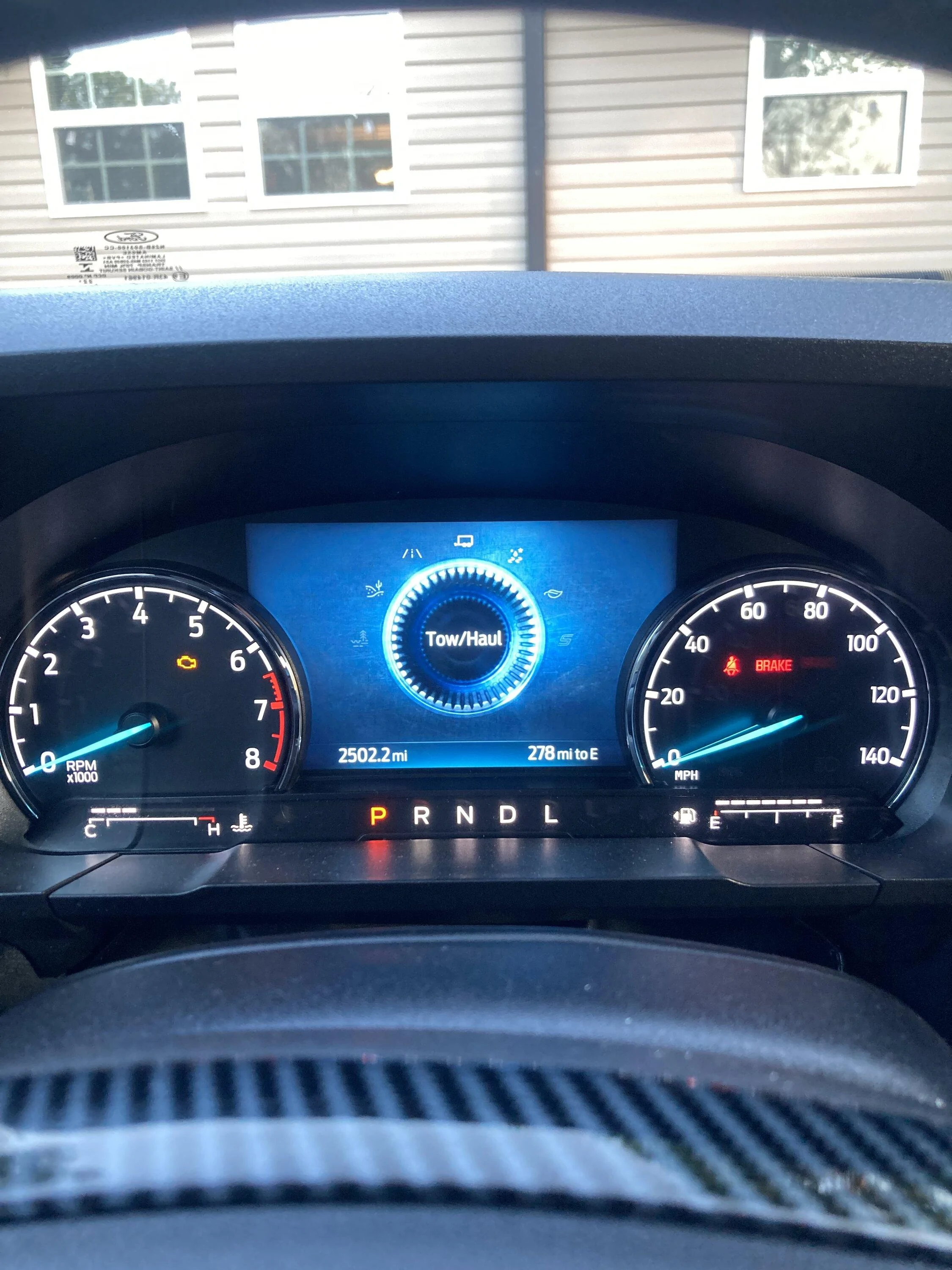

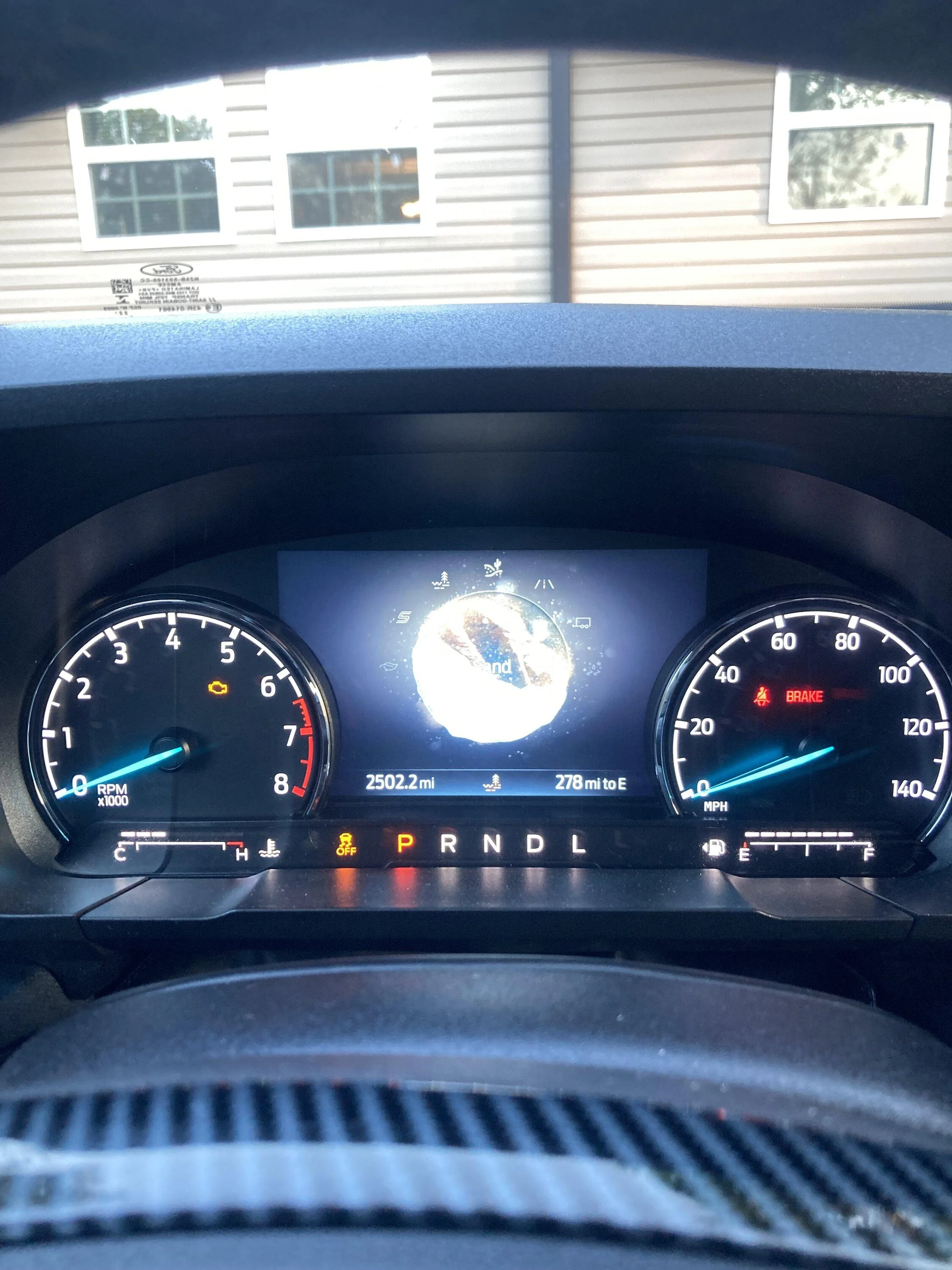

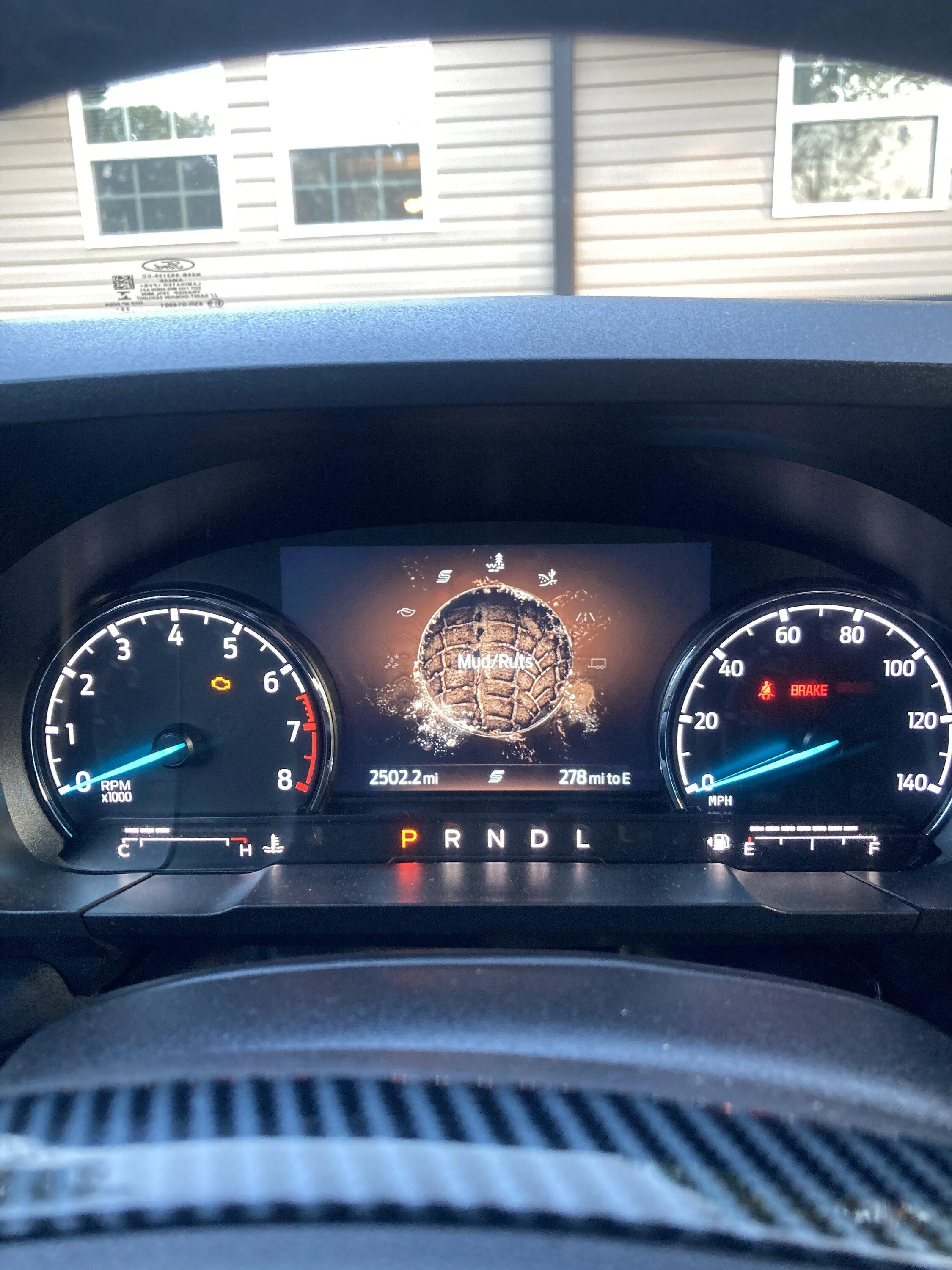

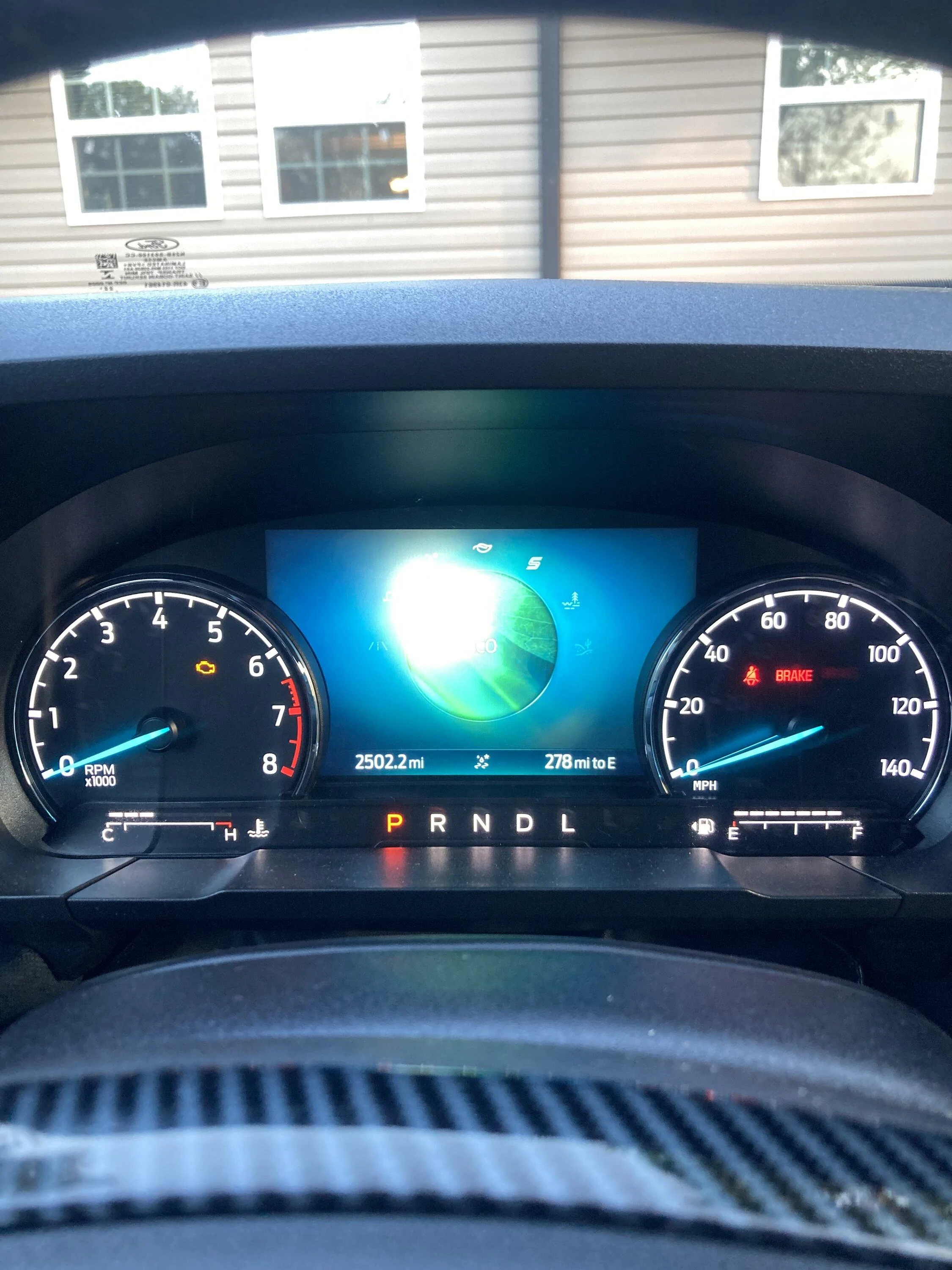

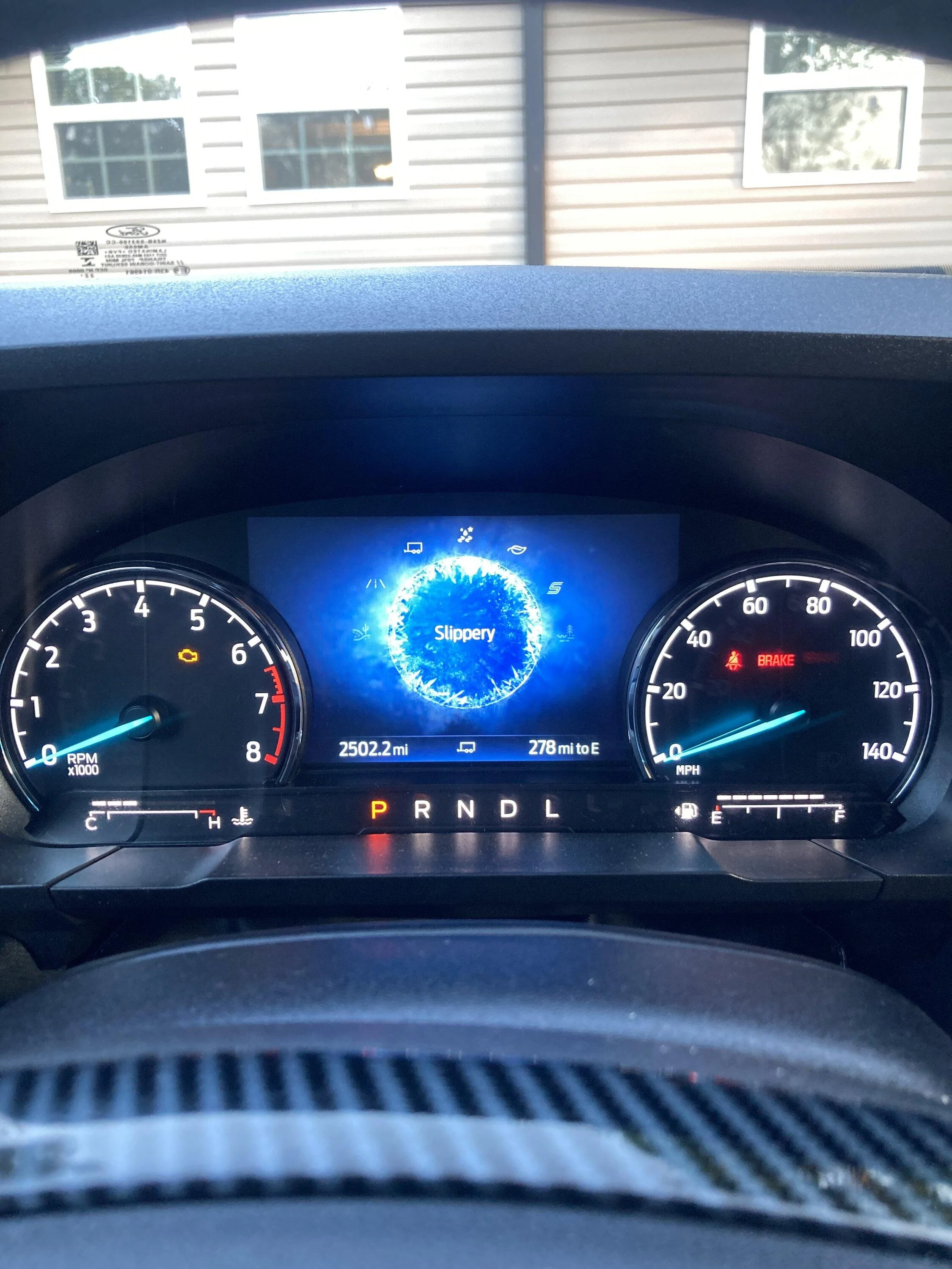

Applies to all trims w/AWD with or without an FX4 package.
This so far has been tested on an XL trim with a 2.0L gas engine, AWD w/o the FX4 package and has since been confirmed to work with the FX4 package option.
It has also been confirmed that it can be used on FWD vehicles. Performance testing still to be determined for FWD.

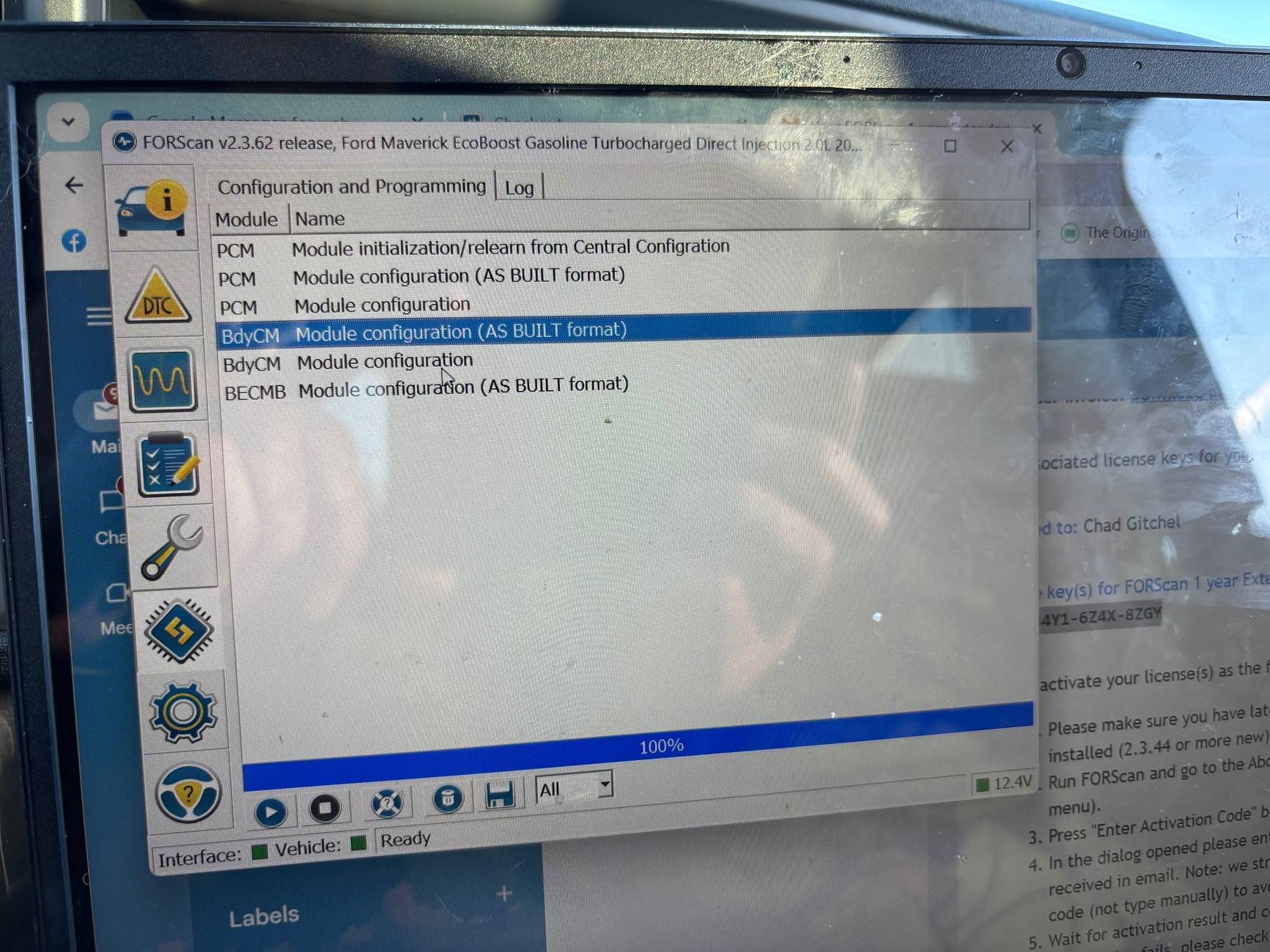

This assumes you know how to use Forscan. Also make sure you back up your ABS settings before doing this. If you screw it up badly a simple restore of your back up settings may not be enough. You might also have to do an ABS module reset afterwards.
There are 2 ways to go about this.
Method 1 - enable either the FX4 package or non FX4 package.
To switch between both
ABS
760-02-01
xxxx-xxxx-x*xx
For non FX4 package and eco / sport drive modes enabled change to xxxx-xxxx-x1xx
For FX4 package and mud / snow drive modes change to xxxx-xxxx-x8xx

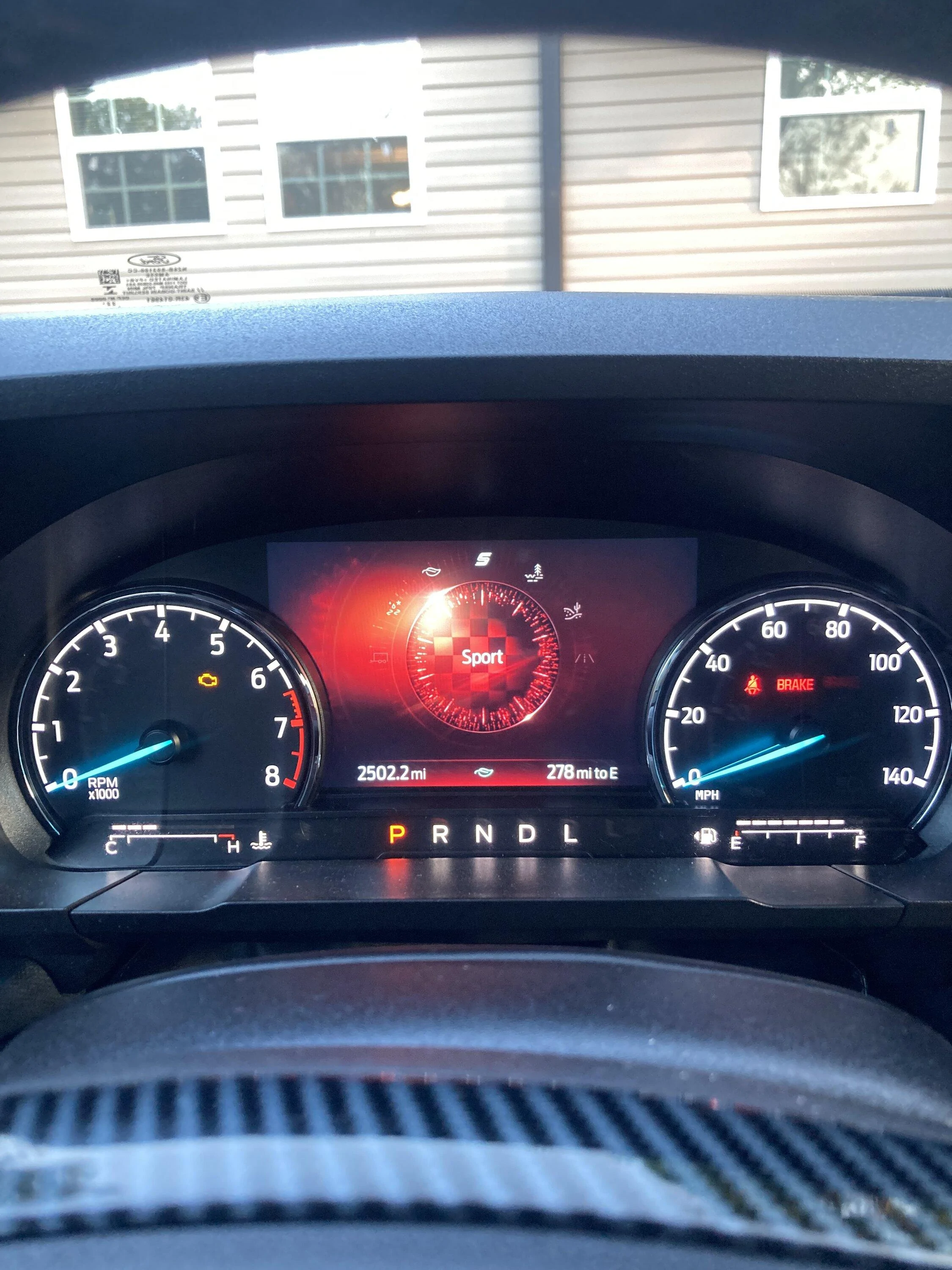

Next you need to enable the selectable drive modes for the package you want active. See SDM section for drive mode selection.
Method 2 - This allows for all 4 modes to be usable at the same time
First you need to disable ABS as a selectable drive mode. This will bypass register 760-02-01. You can leave that setting to your vehicle's default setting.
ABS
760-04-01
xxxx-xxxx-x*xx
change * to 0 to disable the ABS drive mode selector
This now allows you to use all 4 modes.
Next you need to enable the drive modes. See SDM section.
SDM (selectable drives modes)
This is required regardless of what method you use.
shortcut code - recommended for method 2.
760-04-03
0000 0001 EB5A
This enables all 4 modes - eco, sport, mud and snow
To enable FX4 modes
FX4 package - recommended code for method 1
760-04-03
xxxx-xxx1-E1xx
This enables both mud and snow modes
xxxx-xxx1-x1xx
xxx1 = snow
x1xx = eco and sport not present
xxxx-xxxx-E1xx
Exxx = mud / ruts
To enable non FX4 modes
non FX4 package - recommended code for method 1
760-04-03
xxxx-xxxx-6Bxx
6 = eco and sport present / no mud mode
B = eco and sport
xxxx-xxxx-63xx
3 = eco w/o sport
xxxx-xxxx-69xx
9 = sport w/o eco
