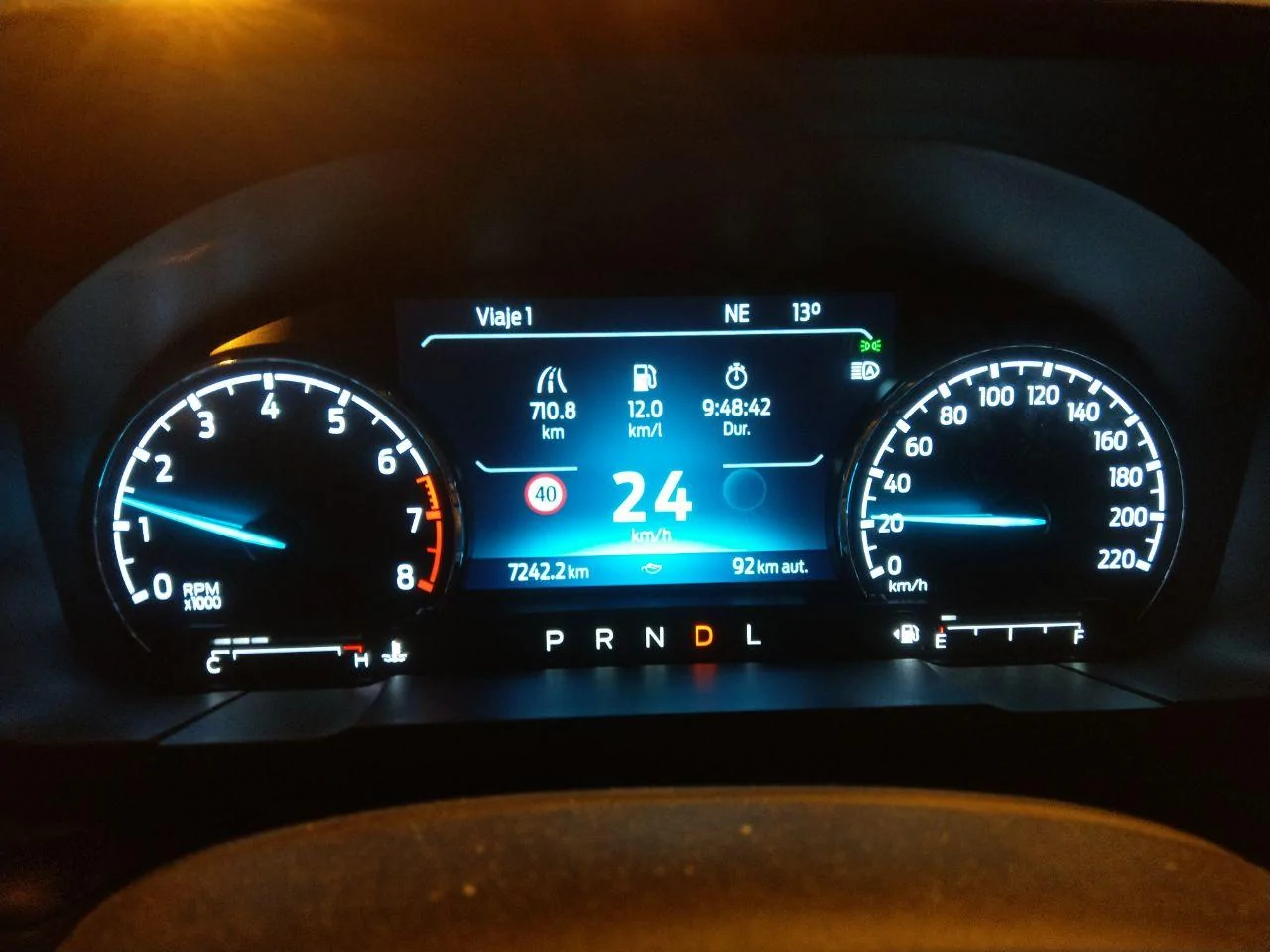

Working! But for some reason it doesn't show anything on the right side. :crying:

That is the round euro style sign you have. It seems getting them to be the rectangular US ones has been difficult. The other one is for ‘warning’ signs and would very rarely be seen (I do not recall which signs they exactly are). But that is another reason people like the rectangular style, that 2nd sign ‘blank‘ goes away.
The signs here are round, so that's fine. The right side never showed me anything.
I found this old Ford video. It only shows one thing for the other circle. Looks like it is for signs that would be on the opposite side of the road???
Darnon
Jul 4, 2021
5,725
7,239
WNY
It's for Euro no passing zone signs (the black and red cars).

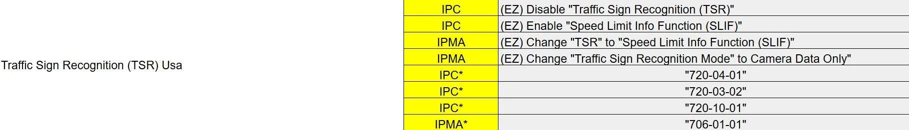

This is perfect...
I had followed the entire step-by-step process in the @EONR24 spreadsheet, but I still had two circles, with the first one showing the speedometer and the second one being translucent with nothing.
I did this configuration that you mentioned, along with the information from @BlackMav23 and it worked great.
Now I have round plates (I prefer round ones instead of square ones), with only 1 circle.
In addition to this, I did the AS BUILT configuration of the spreadsheet so that only 1 tolerance option appears.
Everything works, wonderful!
MAVERICK LARIAT HYBRID 2024, SYNC 2.5, CLUSTER 6,5", BRAZIL.
