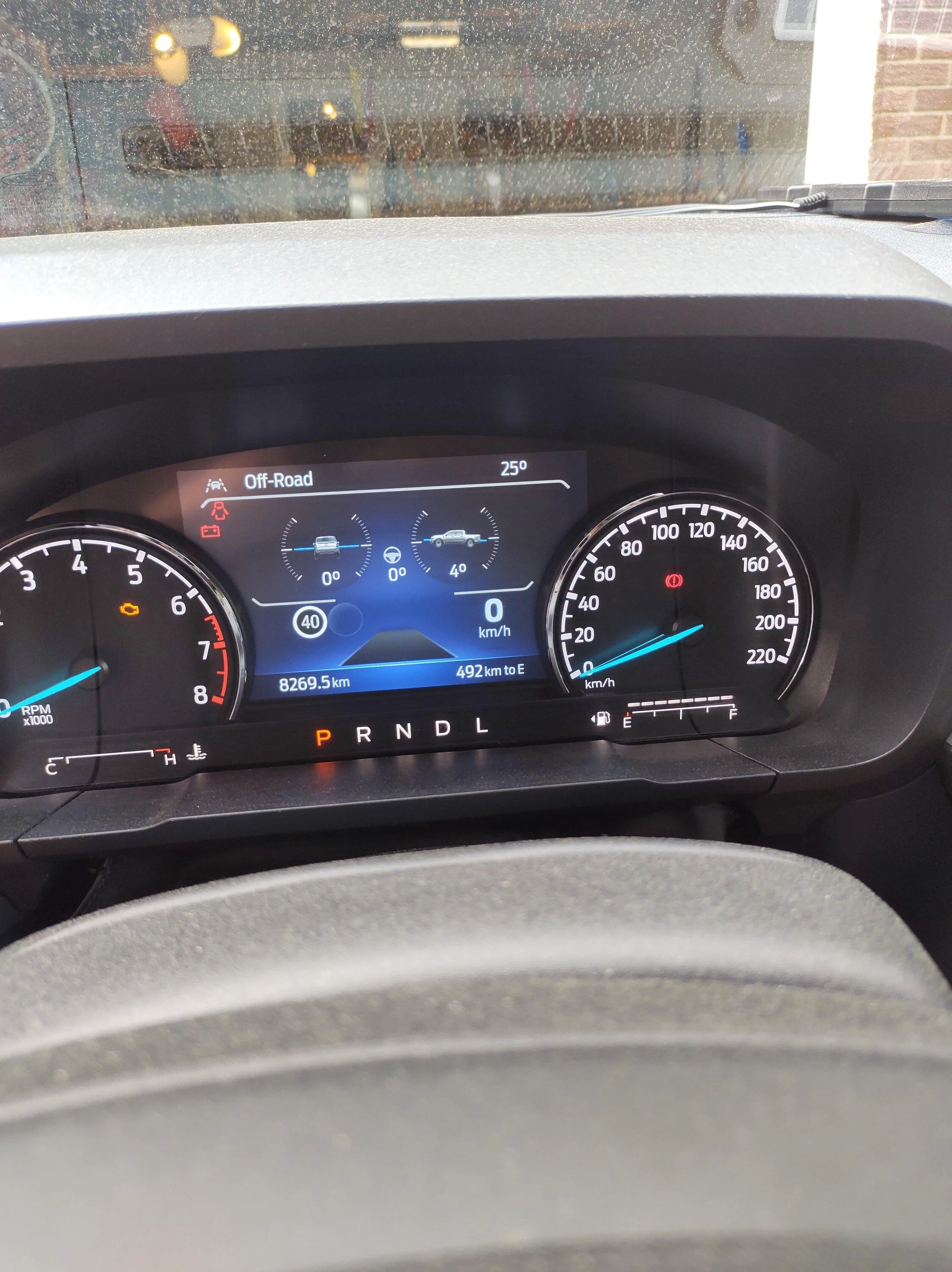

I figured this one out the other day.
It's a simple mod, but I wanted to contribute it to the community anyway.
IPC 720-07-02 X7XX-XX
That's it. There isn't an easy mode switch for this one that I was able to find.
I tracked this down by comparing the AS-BUILT of an FX4 Lariat Lux against my own.
I can confirm this works on my Lariat Lux Hybrid, see below.

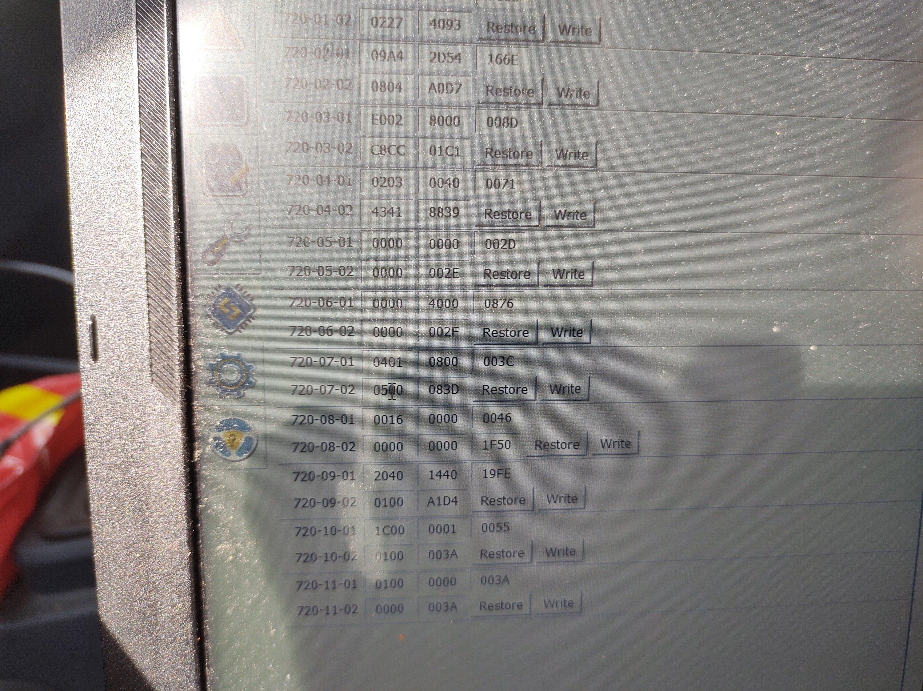

So I loaded up forscan and went into my EB 2.0 AWD IPC and found the following at 720-07-02:
0500 083D
Looking at your instructions you only have 6 character spaces.

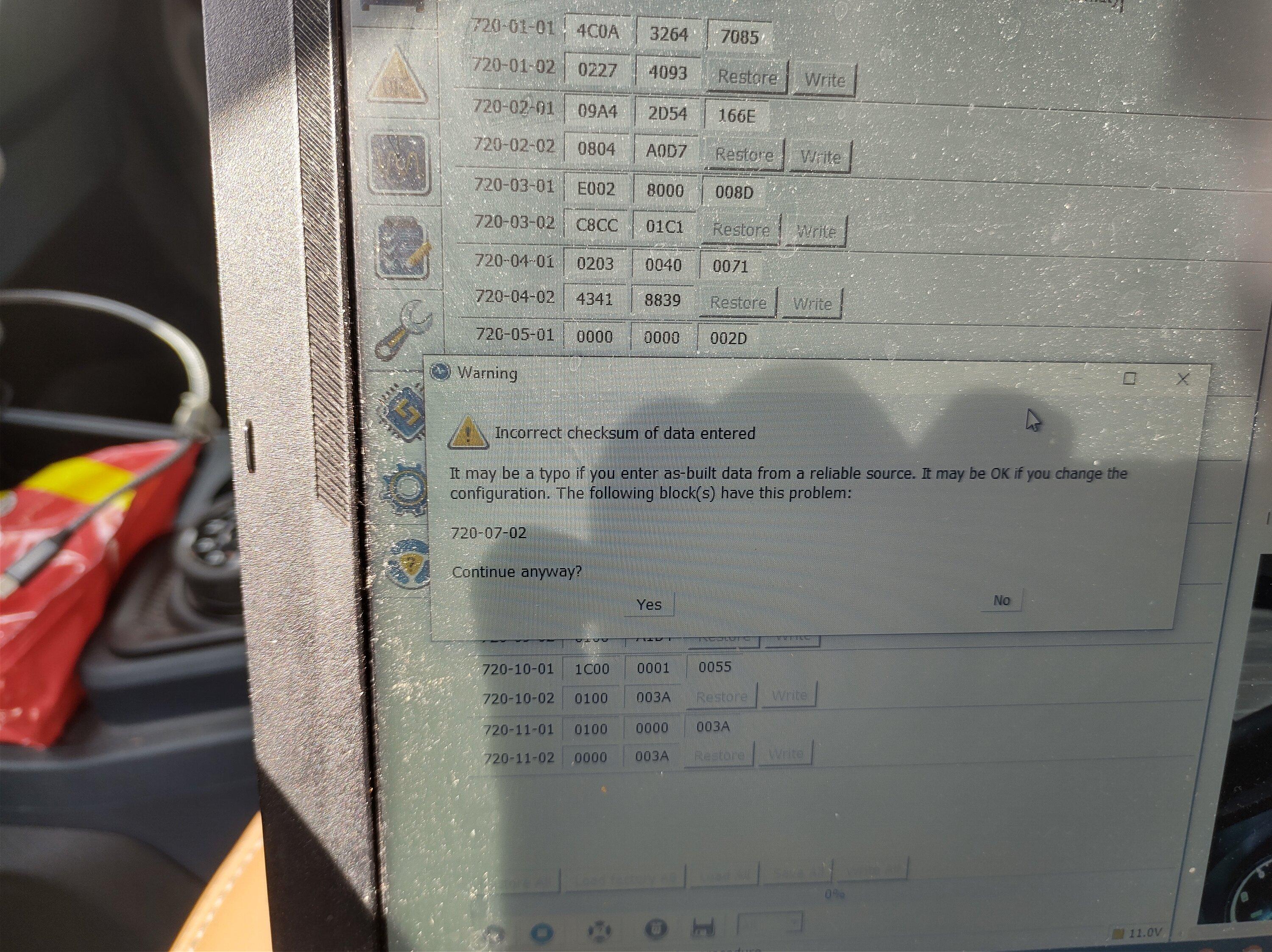

I did change the 5 to a 7 but got a checksum error and did not proceed.
Is that normal?

Yes, the check sum error is normal, but Forscan should correct it.
Apply it and see what happens. You can always change it back if needed.

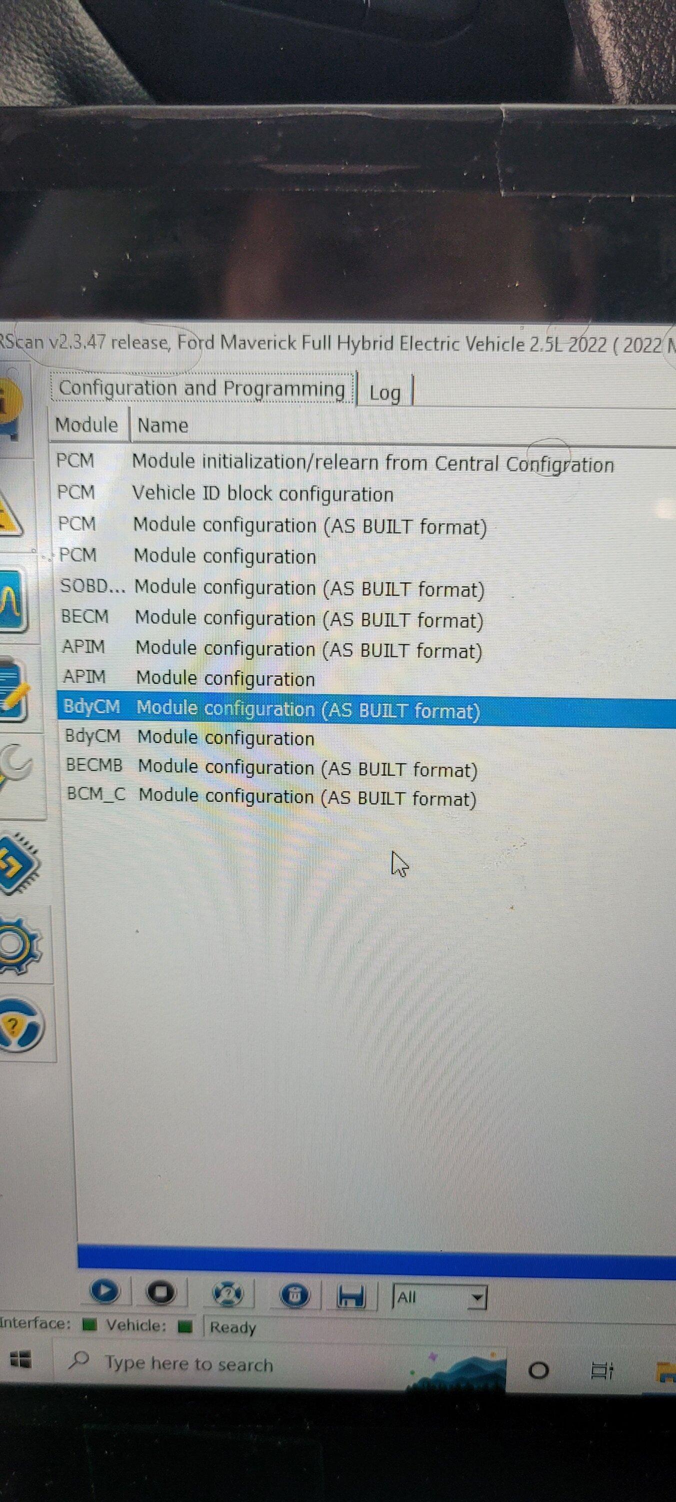

Which module is this under? Looked in all the as builts but no luck finding any lines starting with 720.

You want the IPC module. Doesn't seem to be showing up. Did you load the right drivers for your obd2 adapter and does it support medium and high speed bus ( should have a switch)

I have the auto switching one recommend by forscan and a older switch one. Neither give me the ipc module. I'll try reinstalling the drivers.
