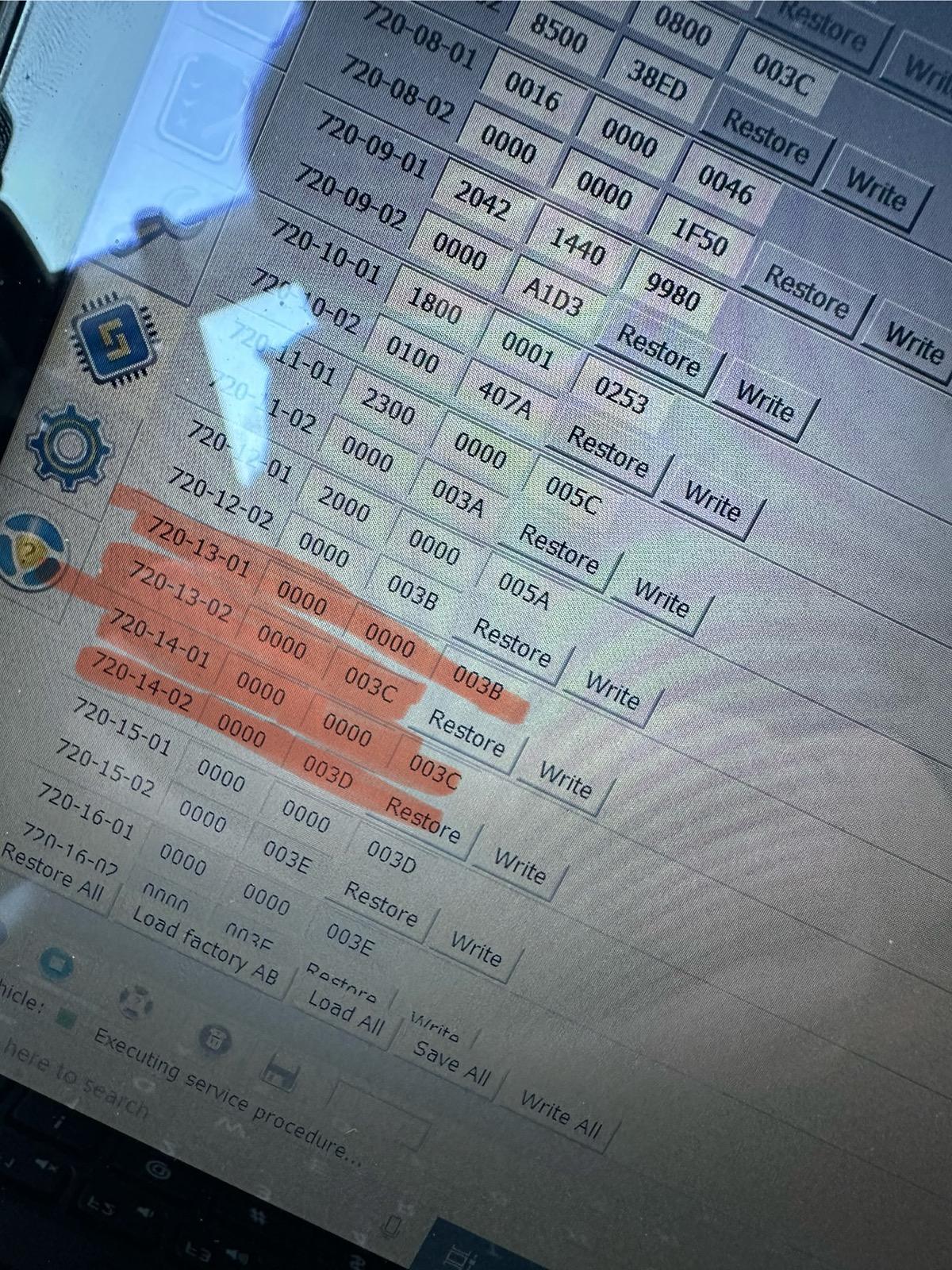

DISABLE SEATBELT INFORMATION SCREEN
1. Open IPC AS BUILT
2. Change line 720-13-01 and 720-13-02 to ALL ZEROS. And WRITE the changes. Click yes to let Forscan correct the checksum.
3. Change line 720-14-01 and 720-14-02 to ALL ZEROS. And WRITE the changes. Click yes to let Forscan correct the checksum.
Another happy customer! I was able to disable the seat belt screen/chime using these instructions and the FORScan 2.3.69 Beta from https://www.mavericktruckclub.com/f...blocked-on-2025-xlt-hybrid.76004/post-1255942 on my 2025Hybrid.

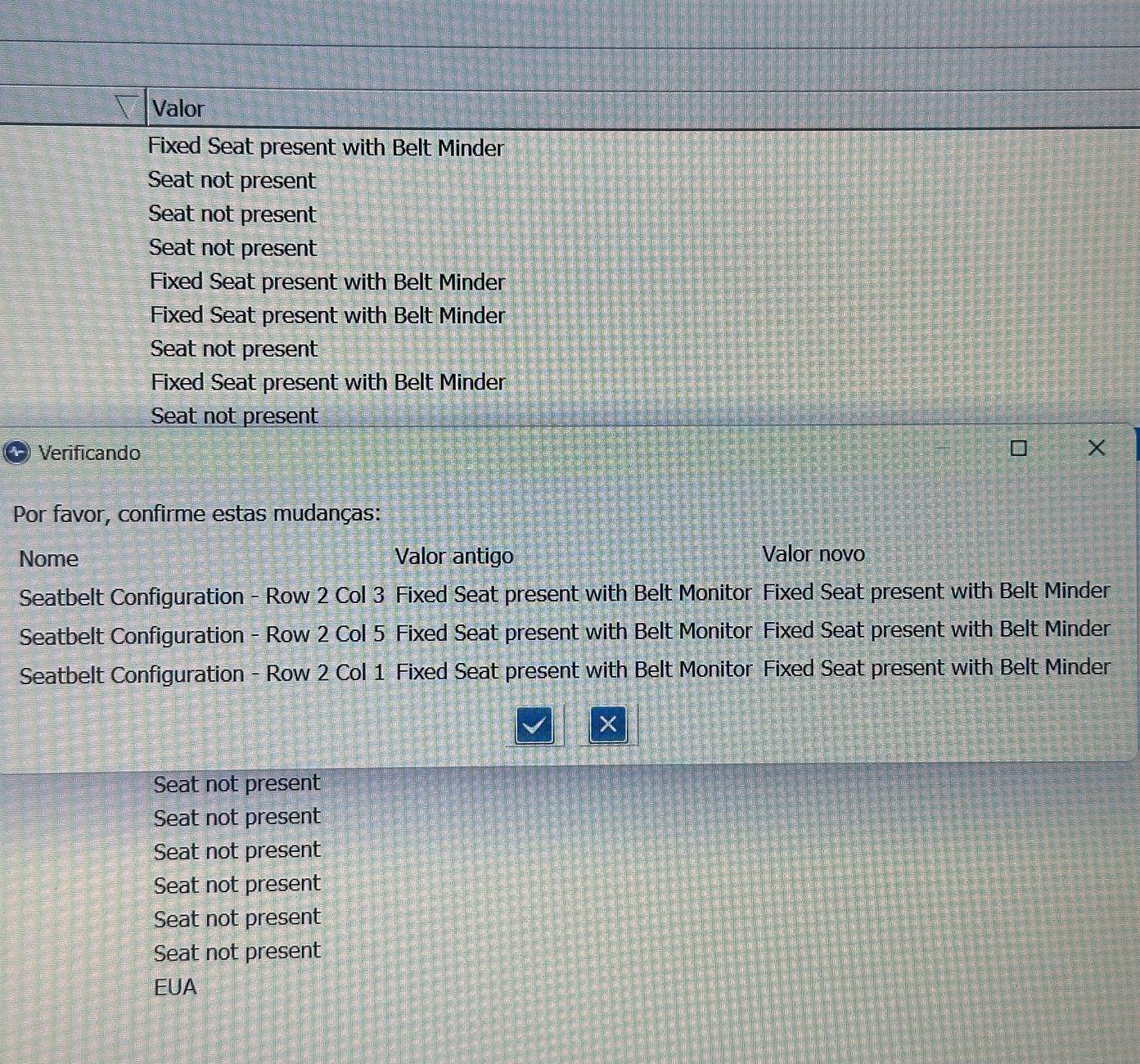

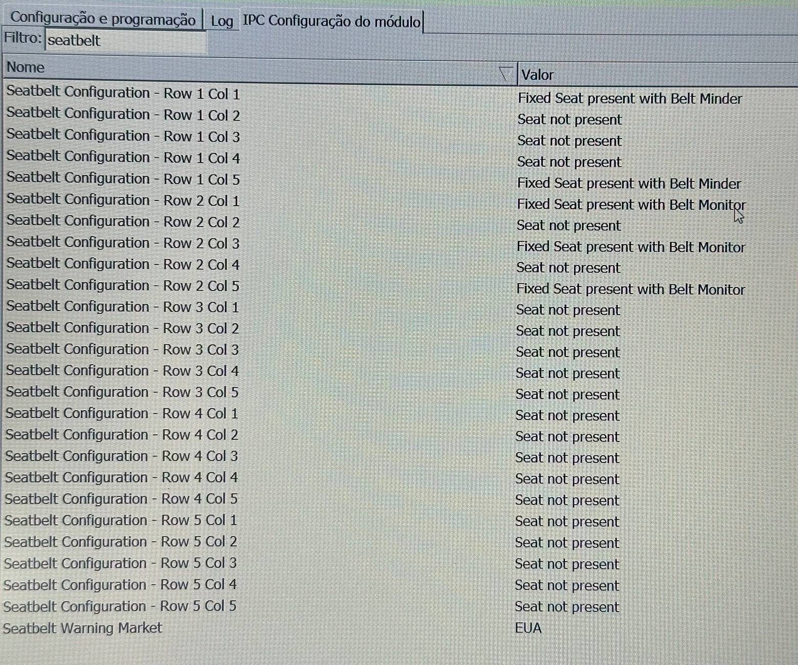

Go to the IPC module (non as built), look for "Seatbelt Configuration - Row ... Col ..." and do the following (photo attached):
- R1C1 "Fixed Seat present with Belt MINDER". (driver's seat)
- R1C5 "Fixed Seat present with Belt MINDER". (passenger seat)
- R2C1 "Fixed Seat present with Belt MONITOR". (left rear seat)
- R2C3 "Fixed Seat present with Belt MONITOR". (middle rear seat)
- R2C5 "Fixed Seat present with Belt MONITOR". (right rear seat)
Even the alternative as-built options from @EONR24 spreadsheet made the change to all seats, except for R2C3. And because of that, it didn't work as I wanted. I tracked the change to the R2C3 seat in the as-built coding, but no code for that seat was present in the IPC (even after changing only that seat, the codes didn't change in the IPC).

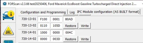

I want to thank you both. I just wanted the screen to go away once the belts are buckled, and now it does. So I can confirm this works on a '25.
Mine looks like @GotMojo. Just changed 3 of the 2s to 1s.

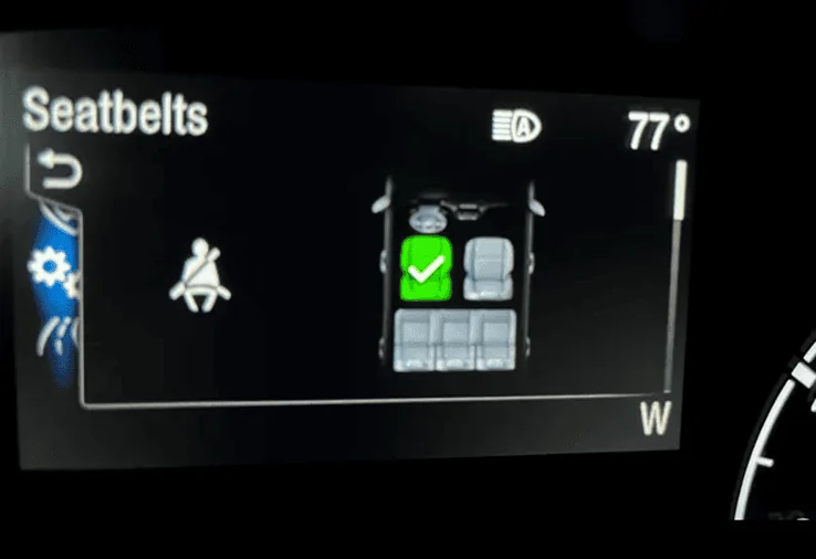

Ok so my belt is on. What good is obscuring my instrument cluster with giant splash screen showing a green check mark? For like 10 minutes! Is that to reward me for being a good boy? If that screen disappeared as soon as you fastened your belt I bet nobody would care.
It lasts one minute. I timed it,
Still it does feel like ten when your trying to get underway right !
