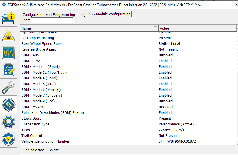

Just did this in "easy" mode on my FX4. You have to disable the SDM-ABS as mentioned in the OP or you'll get a "drive-mode can't be selected" error even with the modes showing up. Sport mode did work during the test drive. Thanks for the work on this, OP.
A pretty old post, but that tells me EXACTLY what I needed to do. In my first dabble in ForScan, I enabled Sport mode, but failed to disable SDM ABS also - the result is as you noted, the mode appears but states that it is not available. I'll get at it tomorrow morning before my long trek to the company picnic.

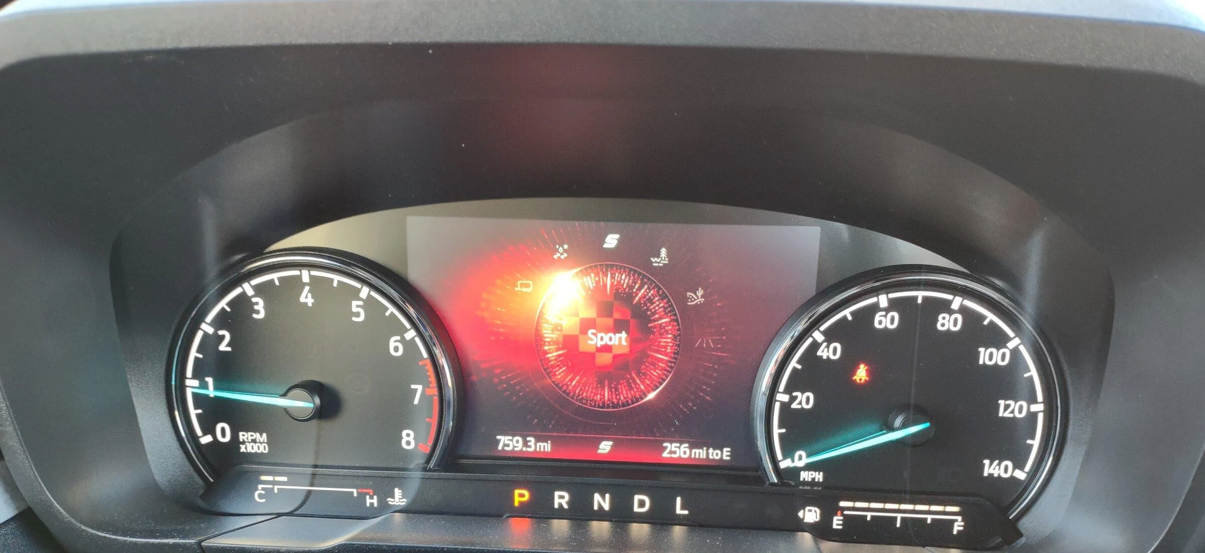

Ok, followed the instructions noted by JUrban earlier up the thread, and I now have a fully functional sport mode. Not sure why they deleted it in the FX4 in the first place. I like it for the engine braking alone - very helpful around here where there are lots of hills and twisty roads.

I wanna try Method 2 on a 2025 XL Non FX4. It has the sync 4 infotainment and they made me buy copilot 360 with my tow package. This is how i will get them back.....(forcing copilot on me) By unlocking two more drive modes! However this is my first Foray into Forscan. Ive watched a lot of tutorials i'm pretty adept at learning software and hardware.
Whats the chance I brick a brand new truck with old coding?
Should i wait for a Veteran to successfully do a 2025?
yeah, as an old IT veteran, i would not be attempting to plug old sync3 code into a sync4 system, especially if you're new to doing this.
if you do go about it, be sure to make a backup of your original code before tinkering, even if it is vetted code.

I tried doing it In EZ mode on a 2025 XL and i unlocked Lobo mode. So the Mode numbers in SDM in 2025 sync 4 are different. Im gonna keep looking for the offroad mode. I reverted it because i wasn't sure if the XL rear diff and transmission would not like Lobo software. Lobo has 7spd not 8. Any Opinions?
