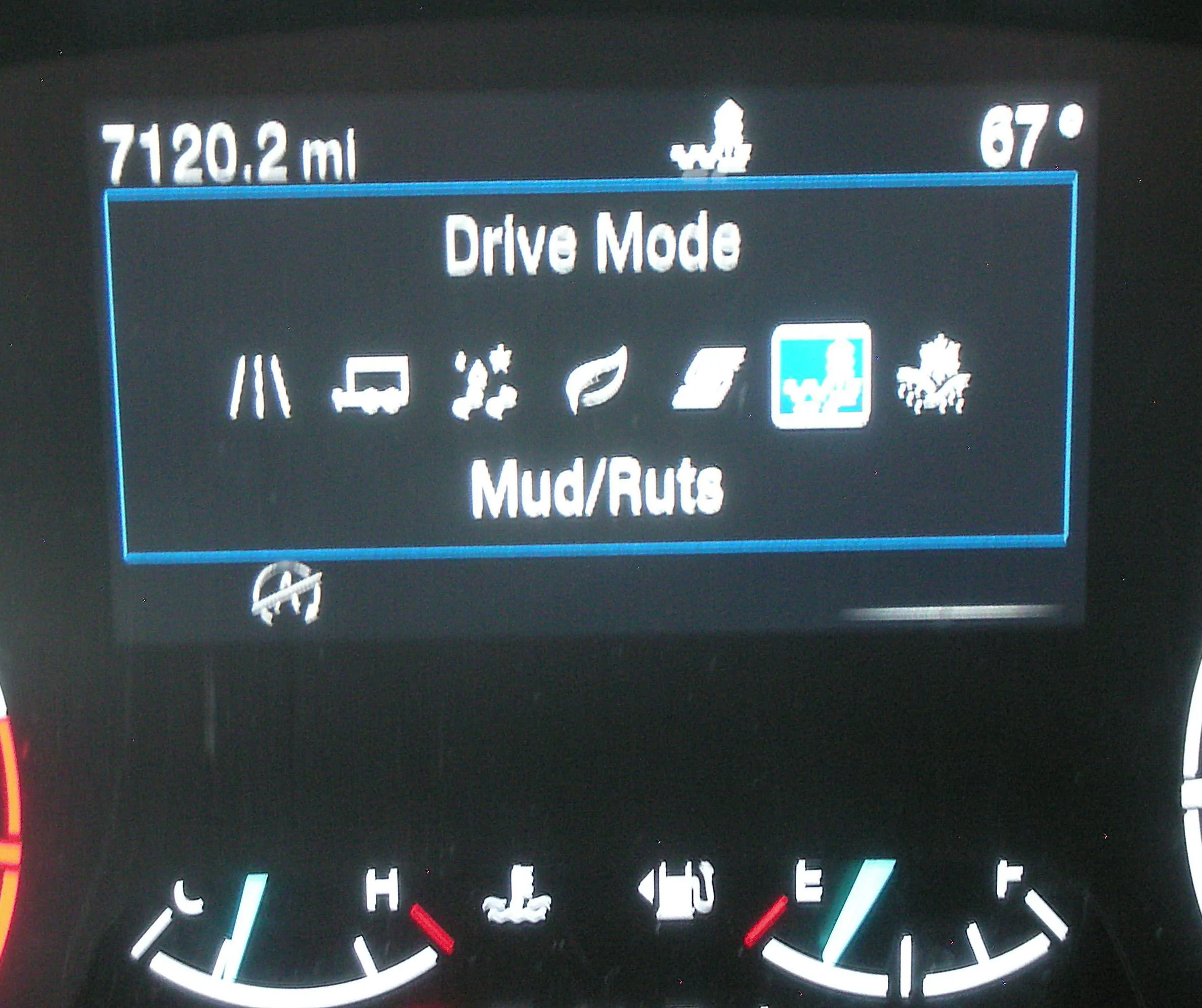

This assumes you know how to use Forscan. Also make sure you back up your ABS settings before doing this. If you screw it up badly a simple restore of your back up settings may not be enough. You might also have to do an ABS module reset afterwards.
There are 2 ways to go about this.
Method 1 - enable either the FX4 package or non FX4 package.
To switch between both
ABS
760-02-01
xxxx-xxxx-x*xx
For non FX4 package and eco / sport drive modes enabled change to xxxx-xxxx-x1xx
For FX4 package and mud / snow drive modes change to xxxx-xxxx-x8xx
Next you need to enable the selectable drive modes for the package you want active. See SDM section for drive mode selection.
Method 2 - This allows for all 4 modes to be usable at the same time
First you need to disable ABS as a selectable drive mode. This will bypass register 760-02-01. You can leave that setting to your vehicle's default setting.
ABS
760-04-01
xxxx-xxxx-x*xx
change * to 0 to disable the ABS drive mode selector
This now allows you to use all 4 modes.
Next you need to enable the drive modes. See SDM section.
SDM (selectable drives modes)
This is required regardless of what method you use.
shortcut code - recommended for method 2.
760-04-03
0000 0001 EB5A

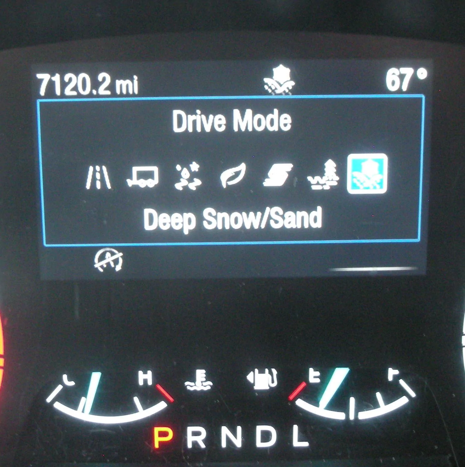

This enables all 4 modes - eco, sport, mud and snow
To enable FX4 modes
FX4 package - recommended code for method 1
760-04-03
xxxx-xxx1-E1xx
This enables both mud and snow modes
xxxx-xxx1-x1xx
xxx1 = snow
x1xx = eco and sport not present
xxxx-xxxx-E1xx
Exxx = mud / ruts
To enable non FX4 modes
non FX4 package - recommended code for method 1
760-04-03
xxxx-xxxx-6Bxx
6 = eco and sport present / no mud mode
B = eco and sport
xxxx-xxxx-63xx
3 = eco w/o sport
xxxx-xxxx-69xx
9 = sport w/o eco
