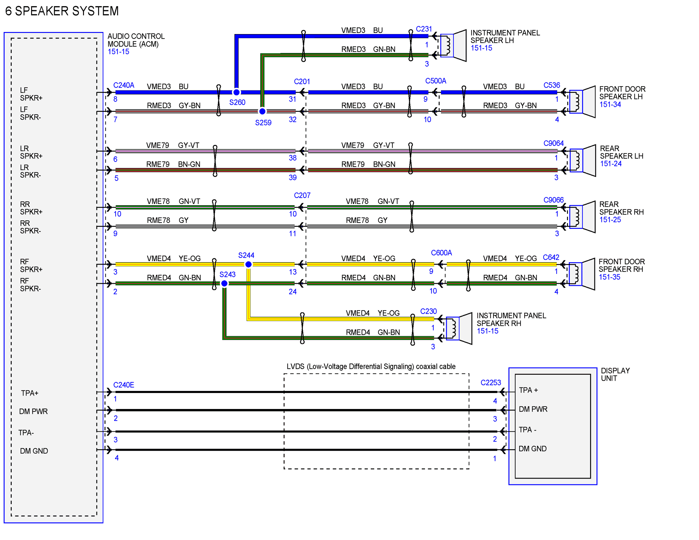

here's the wiring diagram. It looks like the tweeter connects right to the factory door speaker, that's why I was assuming it would be easy to put components in there.
FYI I think the diagram you posted might have been from an older model, from before someone got confirmed actual Maverick ones.
See this thread: https://www.mavericktruckclub.com/f...plice-into-for-remote-in-audio-harness.12949/
Based on this one, it does look the XL/XLT tweets are wired in parallel from some unknown point behind the dash (S233/234 and S259/260).
interesting, I have the B&O and haven't worked on the base system. assuming this is true I probably should delete the diagram I uploaded a few replies back so that the bad info isn't spread further.

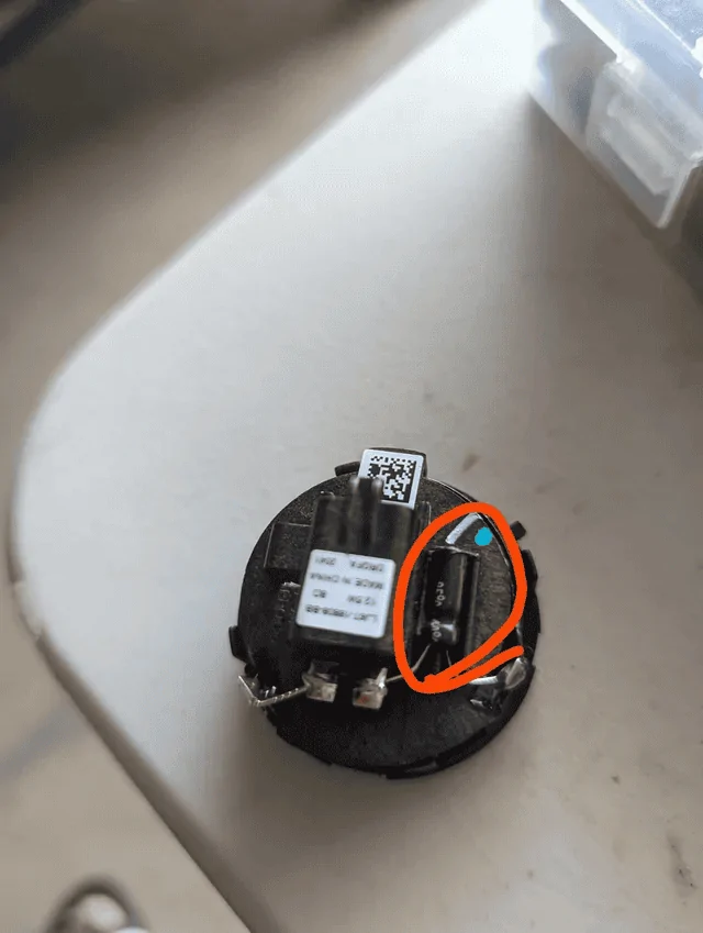

If i remember correctly, the rear has a filter mounted on the speaker itself as do the tweeters in the dash.

I believe the front wiring is full range, with a high-pass cap on the tweeter housing itself.
That makes sense. It also makes it easier for speaker upgrades using the factory wiring.

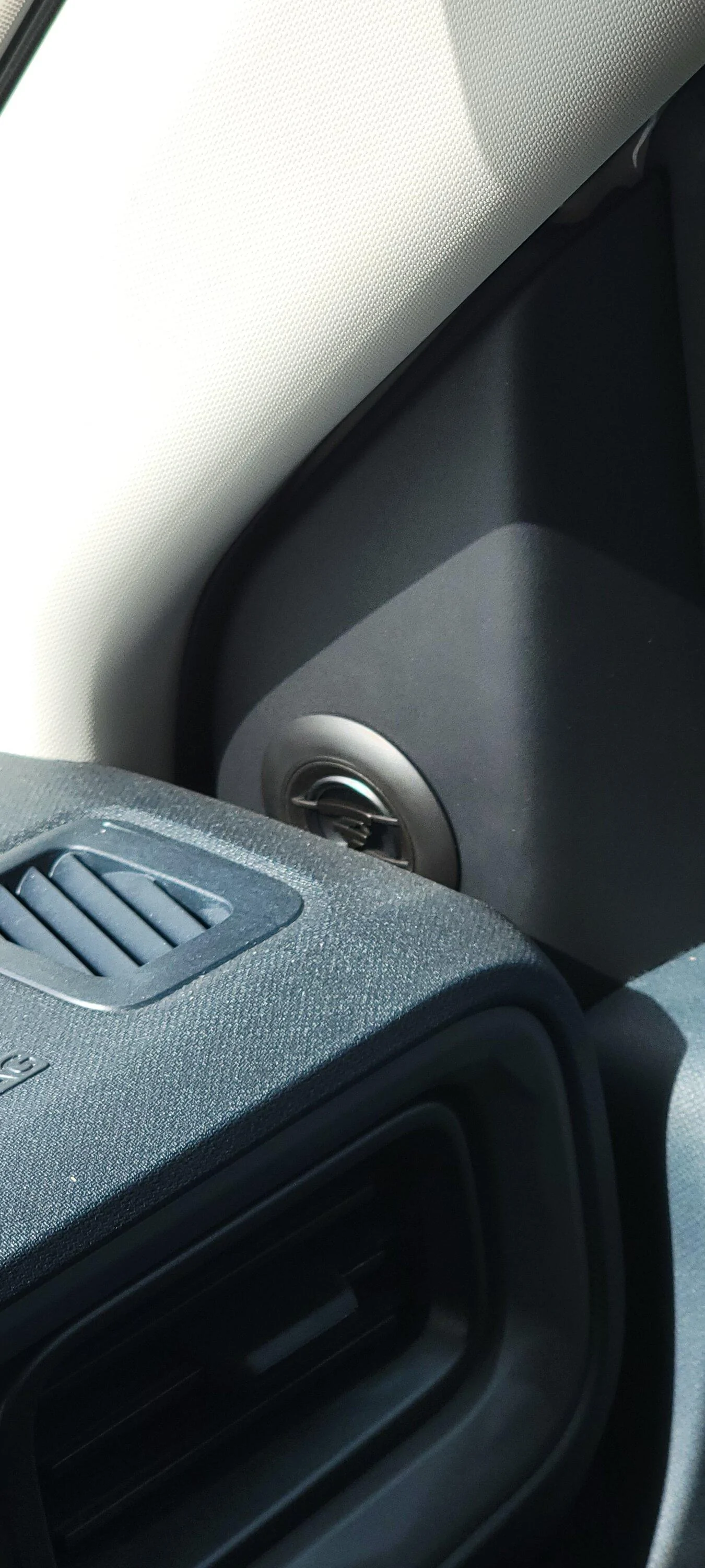

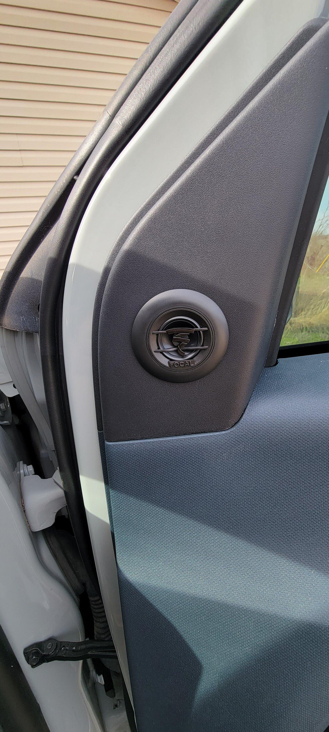

That's kinda what I did. I ran all new wiring.

that's ... interesting. I can't say I've ever seen a tweeter installed such that it's partially blocked by the dash. that said, the factory dash locations are not without their own flaws.
how does it sound?
I've had my door panels off twice and hate the funky fastener on the sail panel. are you still using that or did you improvise something else to keep it secured?

Mine are pretty solid. It sounds much better than the factory stuff. When the amp is hooked up it will sound so much better. The factory tweeters imo are garbage and i couldnt hear them anyway. Might install another set of tweeters in the stock location but mounted on the grill. I want to hear my stuff lol.
