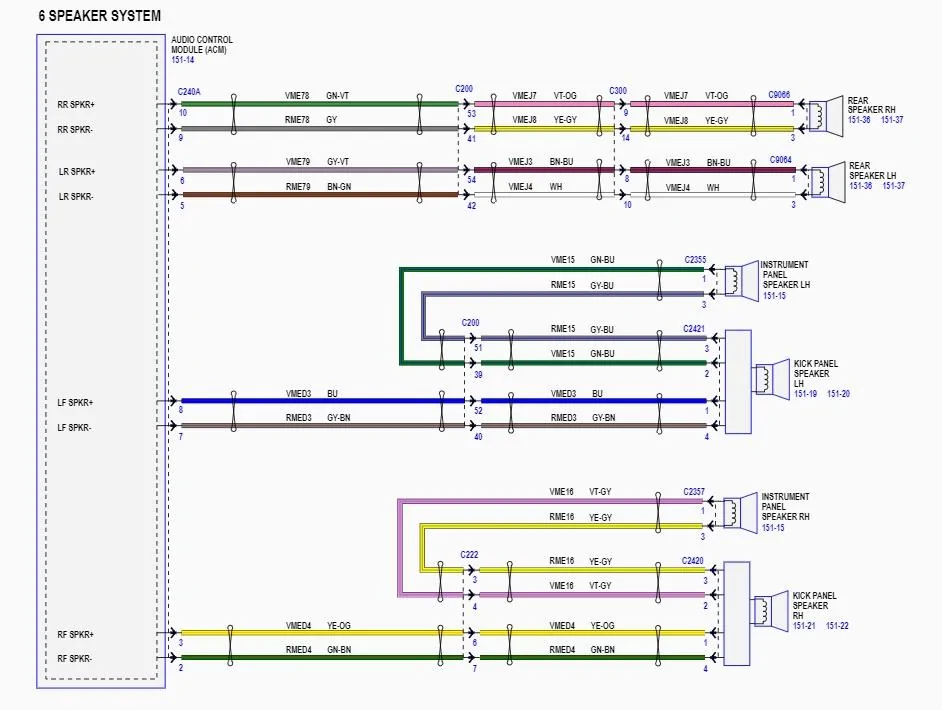

The tweeters and door woofers are spliced off the factory wiring. If you want to run them through a crossover that wire is going to be severed at some point. I resolved today just to run new tweeter wiring. Running anything through the doors seems impossible without getting messy. The doors only have 2 wires, they do not loop from the door speakers back to the tweeters. Running new tweeter wiring looks pretty easy, mostly the driver side will need some fishing.
Where does the OEM woofer to tweeter splice occur? Would it make sense to splice a new tweeter wire there or would it be better to run all new wire to the tweeter?

Not that I have my XLT in hand yet, but I believe that the non-B&O tweets are wired in parallel with the doors, with the splice in some unknown location in the dash. So not trivial to drop x-overs in the door - one of the reasons I will likely go bi-amp, along with the ability to DSP the tweeter to correct its awkward location in the dash corner.
colinl
Colin
Jun 21, 2022
5,440
6,184
ICT
Nice deal on the Focals, those would have been my second choice. Definitely agree that anything on the bright side probably wouldn't play nicely with the Maverick interior. Do you have a build post or thread?
here's the wiring diagram. It looks like the tweeter connects right to the factory door speaker, that's why I was assuming it would be easy to put components in there.

How would I wire up a set of components to the factory wiring? Do you just splice the tweeters into the factory wiring and how would you wire up the crossover?
Few options from basic to pricey:
  • Replicate the factory style by just replacing the 6.5" and tweeter, using the stock harness. Needs a capacitor (bass blocker) inline as a high-pass filter to protect the tweet. Simplest install, but not much frequency control or finesse here at all.
  • Based on the wiring that Colin posted upthread, the factory wiring for the tweet seems to originate at the door speaker (C2421), loop back to C200 which is the audio harness behind the A/C panel in the dash, and then head up to the tweets. If this is true, the x-over could be wired up in the door at C2421, or even behind the dash at C200 with some creative rewiring. Can't confirm this though, don't have my Mav yet.
  • Bi-amp the mids and tweets from a multichannel amp on separate channels using either new wiring to the tweets, or intercepting the wires from option #2. No crossover needed.
