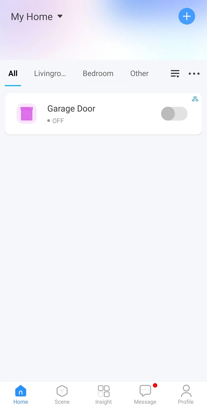

2. Configure Smart Relay in the App
Ford Maverick Ford Alexa Garage Door Integration Screenshot_20260225_135658_eWeLink

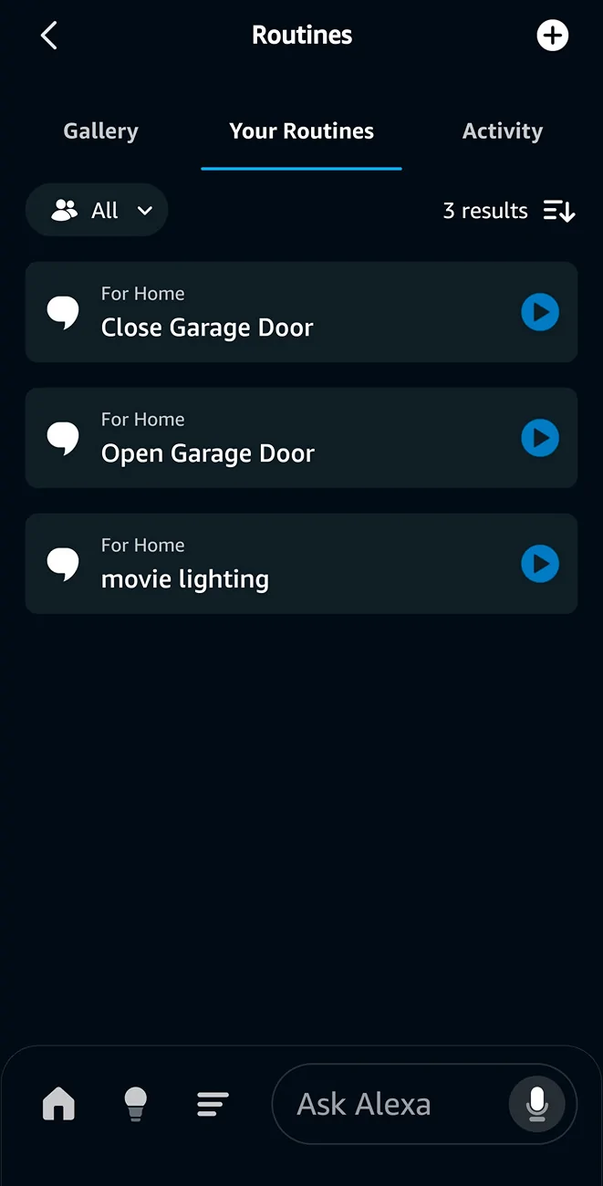

3. Add eWeLink "Skill" to Alexa and create an Alexa "Routines" to open and close garage door. The Relay doesn't know if the garage door is actually open or closed so it's just so you can use either voice command to operate it.
Ford Maverick Ford Alexa Garage Door Integration Screenshot_20260225_140720_Amazon Alexa

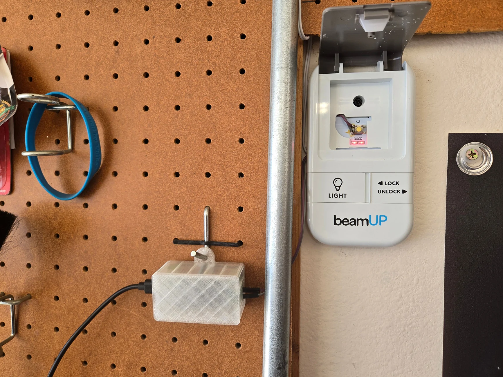

4. Wire into physical switch
Ford Maverick Ford Alexa Garage Door Integration 20260225_134613

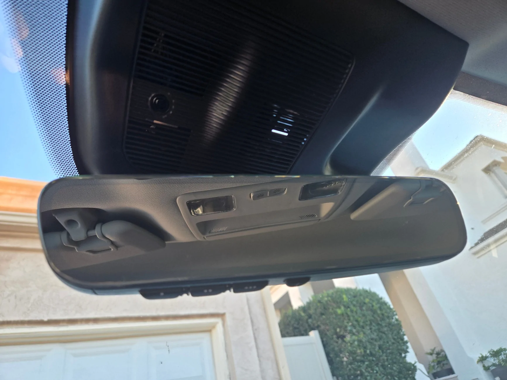

Yup. I already have Homelink Mirror but it's more than $12..lol. Some cars come with Internet option bundles. Also you can still use Alexa on your phone, house, and garage if you have Alexa units.
I originally bought a Kia takeoff but didn't like how they looked.
https://www.amazon.com/Advent-ADVGENFLCHLN-Frameless-Homelink-Connect/dp/B085J1SZMZ
Ford Maverick Ford Alexa Garage Door Integration 20260226_080152
