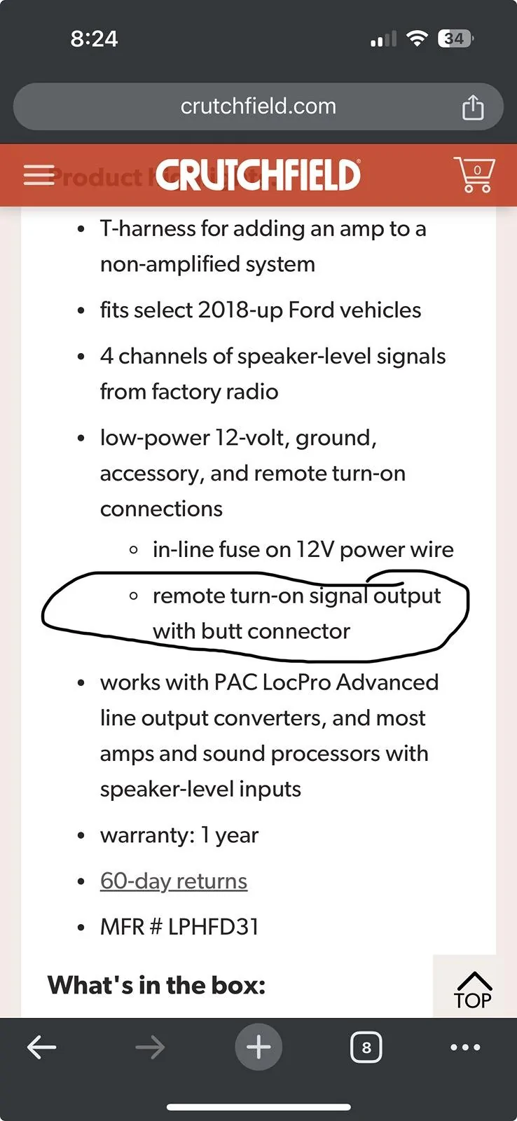

I’m looking at the pac loc pro t-harness also and it specifically says on the description it has a remote turn on…
Are there issues using this off the harness?
I have a kicker amp and it has signal sense but idk how accurate that is

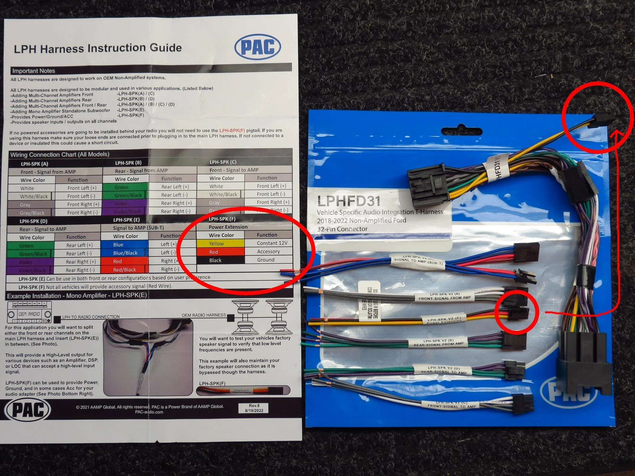

I used the LPHFD31 for my system. Its documentation specifically lists a red wire for accessory switched power (remote turn on) on its (F) pigtail.
Ford Maverick Factory integration stereo wiring harnesses Img_5147a
In the photo, you can see the red wire on the pigtail, but the connector it plugs into on the main part of the harness does not have the red wire. So there is no switched power available from this harness. I ran a tap off of fuse 6 under the glove box and it worked great - it turns off when the driver's door is opened after the vehicle turned off. Amplifier signal sense didn't work well for me. Connecting to fuse 6 did take a funky fuse tap to fit in that location, you can see the details in my build thread in my signature. Skip to page 4 in that thread for the start of the audio construction.
