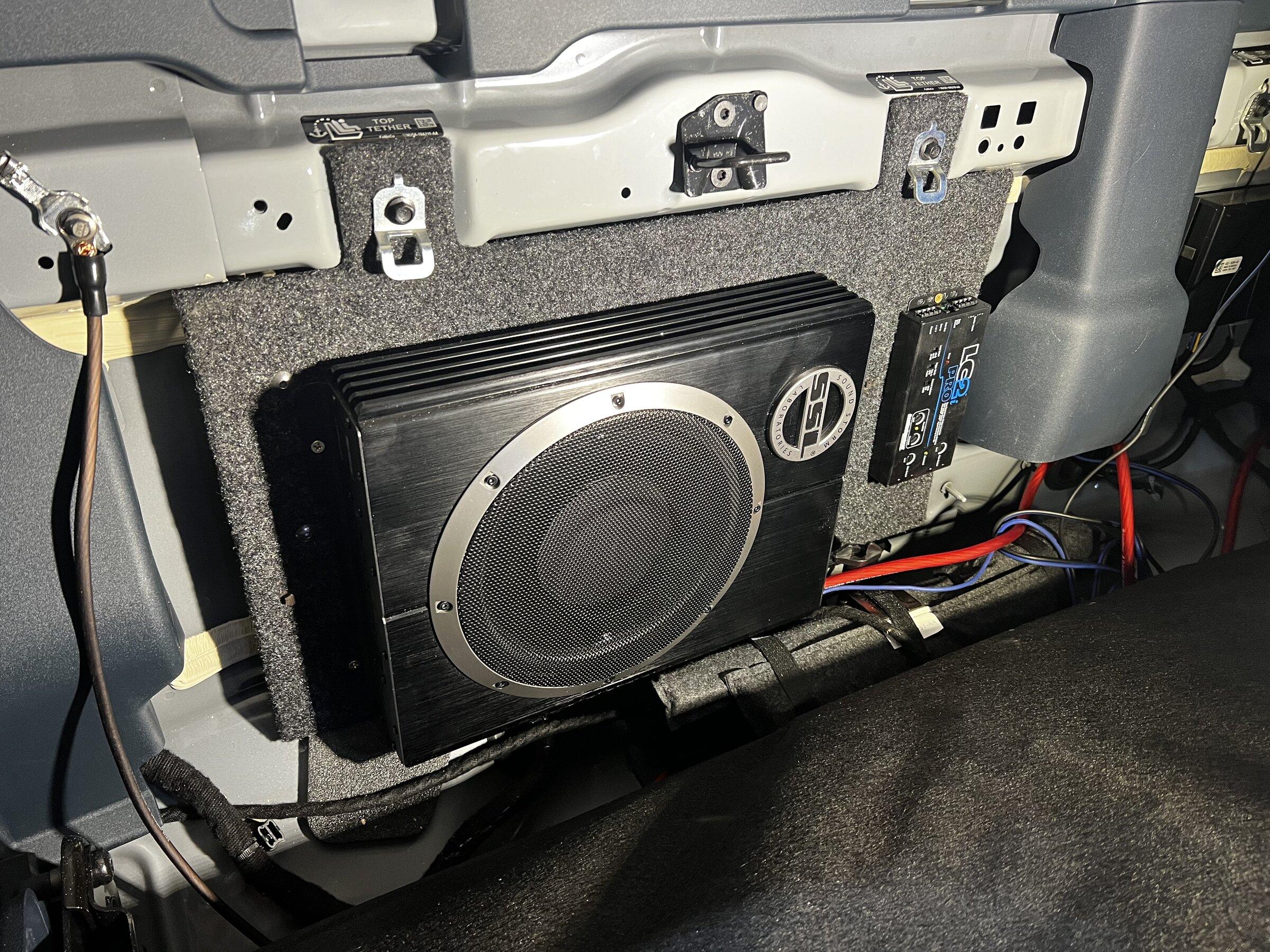

Did you mount both the LC2i Pro and the Key 200.4 in the same locations as BootXL76?
Today's mission for me is to sort out the mounting locations for the Key and LC2i-p. Thought I would get as much input and ideas as possible. I did plug the lljcustoms harness in and verify polarity and power on the leads. Since the LC2i Pro only draws 200mA, I think I will power it from the harness and use the LC2i-p's internal load resistors, although I have no ideas which setting is correct for Ford HU.
On Wednesday, I installed the Morel Maximo woofers in the door and applied a bunch of Killmat. You guys are right about the door sound (front vs. rear) after deadening.
They harness for the Kicker key is short so it’s mounted behind the glove box. Working on some brackets now to make it permanent.
The Lc2i harness reaches all the way to behind the seat so I have that run underneath all the trim on the passenger side To the back.
Nice job on the bracket. Love how you utilized the existing anchors.
Thanks for the info and great photos. That installation looks great!
So, are you planning to feed the Key from the LC2iPro, or just the sub?
In that harness from plug and play kits the key is already wired in off high levels (including power and ground to the ACM leads for those)…. then splits off the signal for lc2i

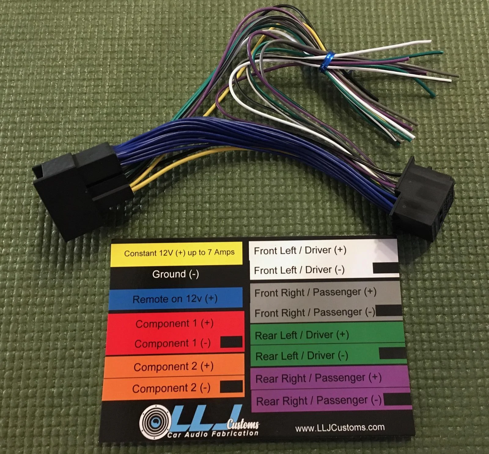

Anyone have the picture of the actual harness? I cant find it.
Red Ryder
Jun 20, 2021
1,190
1,738
United States (TN)
22 Maverick XLT Iconic Silver
Are you referring to the PLUGANDPLAYKITS or LLJ CUSTOMS harness?
I have the bare LLJ CUSTOMS harness and I believe most of the others went with the PLUGANDPLAYKITS harness.
LLJ Customs here:
Ford Maverick Factory integration stereo wiring harnesses LLJCustoms_Harness_1
