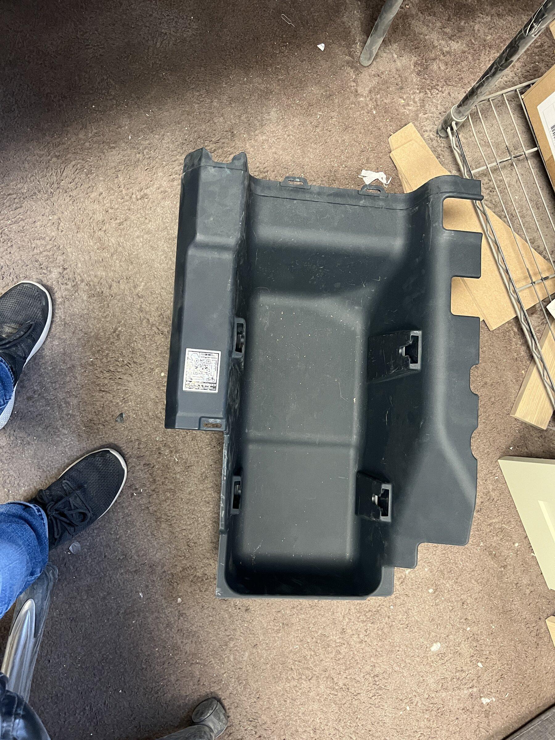

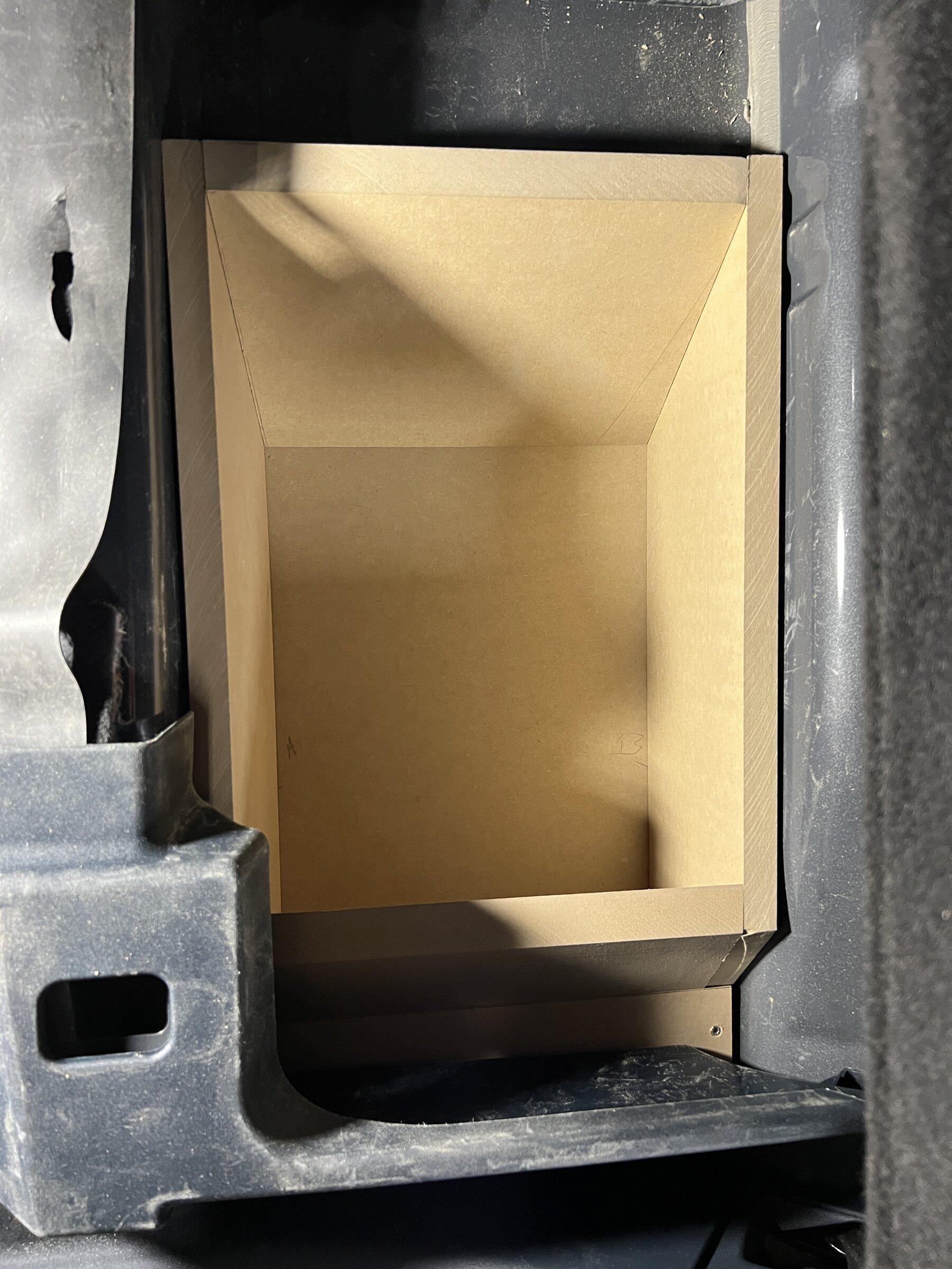

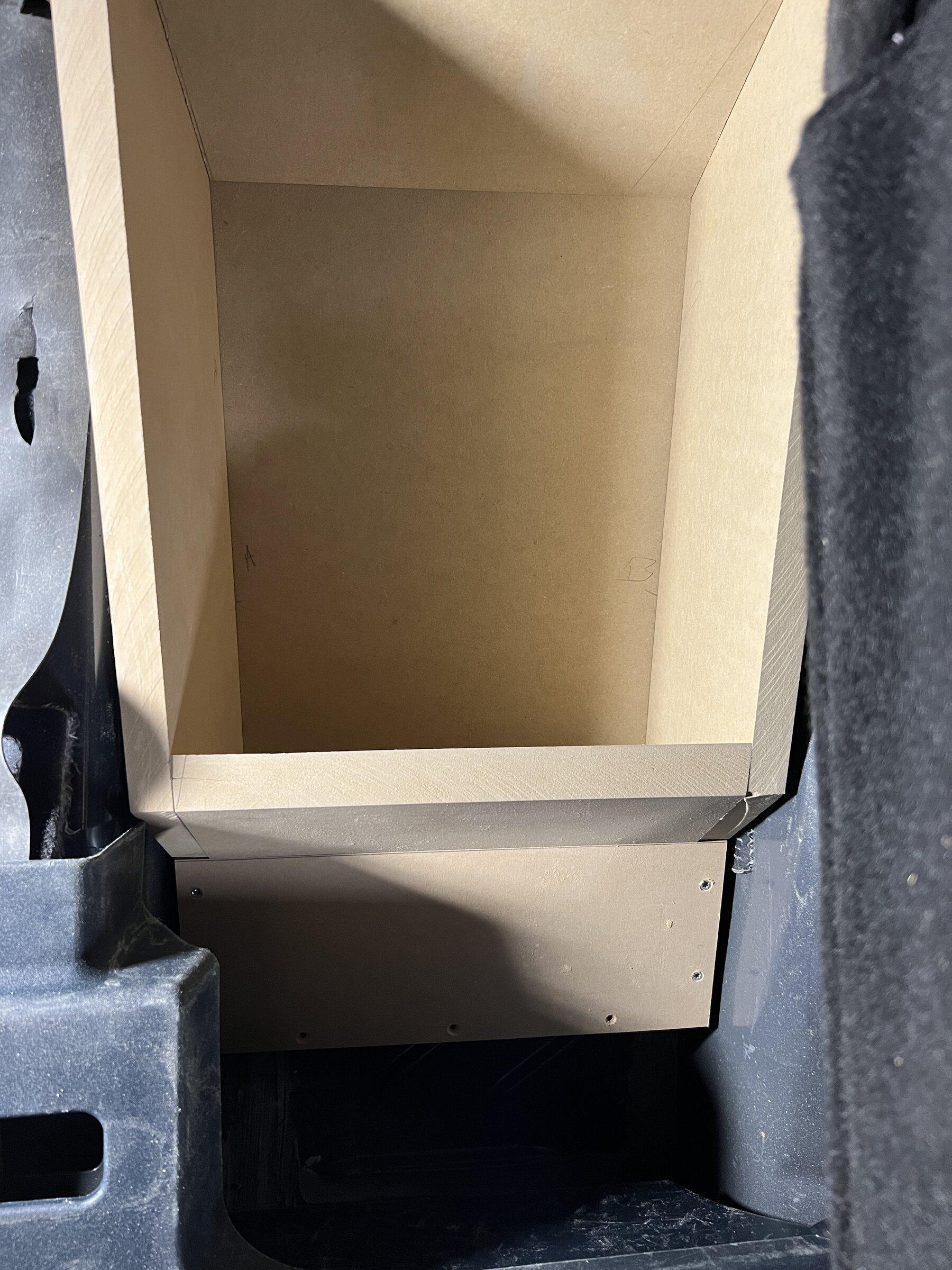

Finally got the box shape built up, never built a tighter fitting box, it doesn't move at all.
I'm pretty sure I'm going to put a nice oversized top on it to close it all off a little better. I'll need to trim the plastic just a little bit and then decide if I cut the front lip off the plastic liner and put it back on.
More wiring parts arrive from Amazon tomorrow and hopefully this weekend I'll be able to mount the amp and clean everything up real good.

Did you shave off the FITS adaptors?

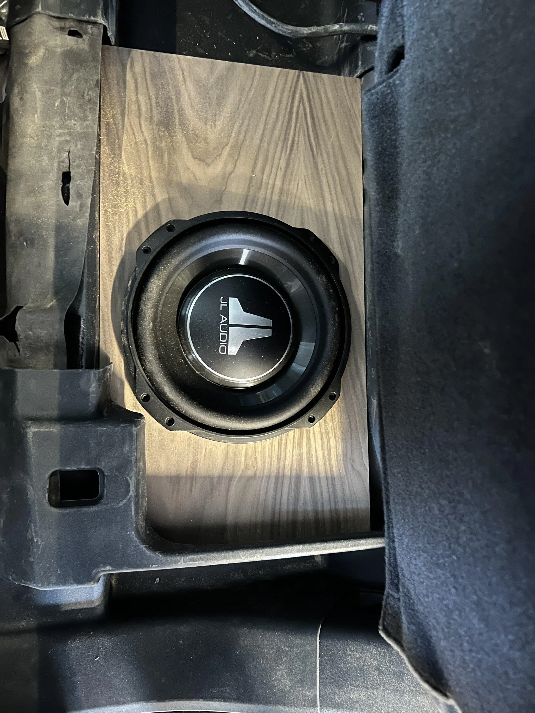

Temporary install, got a few more things to do. Need to sand and add a finish to the walnut and make some cuts on the plastics. Need to mount the amp board and clean up all wiring (its all long until I decided exactly how/where I'm mounting it)
@Qwillex when you are all finished, I say we meet up at In N Out, I have to hear this thing with the 10". My XLT is a hybrid as well.

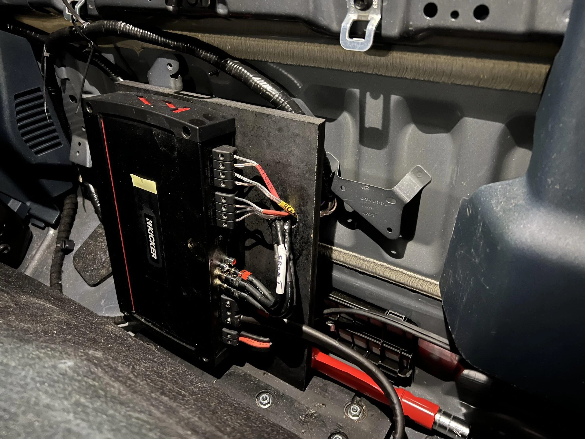

Got the amp all hooked up and wires trimmed up. Took out the jack and used it's mounting points for the amp board (I have a bottle jack in the back). Starting to sound pretty damn good. Need to get the top of box finished out so I can caulk it in. I'm also going to set T-nuts in the box for the sub to attach to as the wood screws are not getting tight enough and air is escaping between the sub and the box.
Cool looking job. The wiring is neat showing professionalism.:cool:
I know I'm late to the party probably, but a tiny bit of construction adhesive on the barrels of the T nuts goes a long way to saving headaches if you ever need to disassemble. I've had a couple spin free in the past and having to remove the bolts then gets much less fun.
