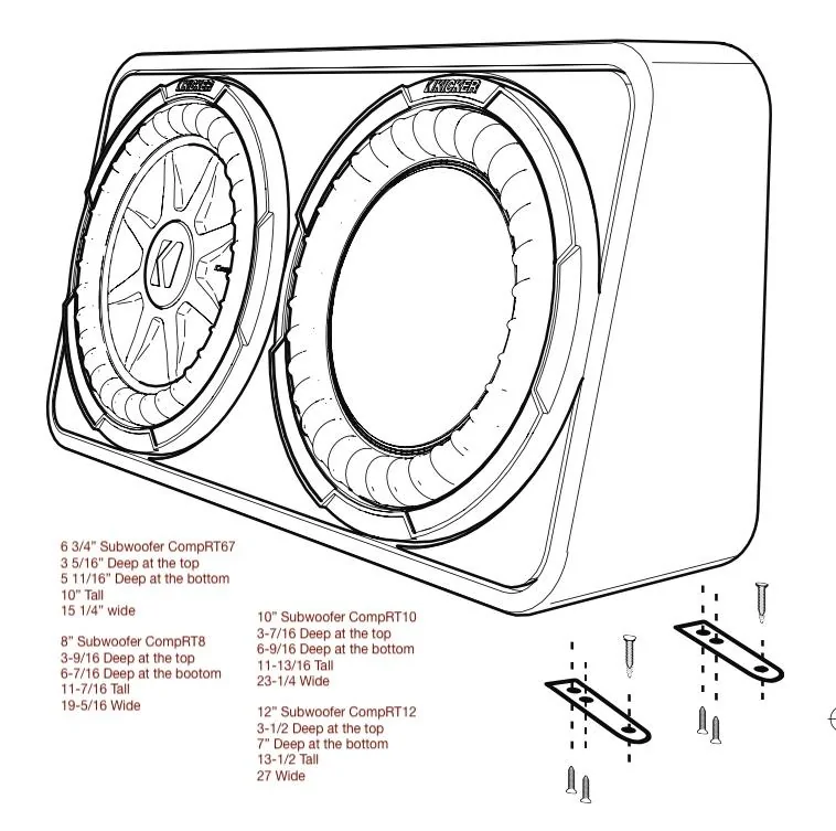

Dimensions wise THIS ONE will fit, 3 1/2 inches deep at the top and 7 inches deep at the bottom…. With any of these you’ll likely need to cut off the factory “amp rack”… the problem with this one is the width, it’s 27”…. The restriction by options/model is that you’ll need the entire space from the passenger side blue trim to the middle blue trim covering the seat belt assembly.
Was playing with custom box designs instead of going this route, but ported you won’t have enough space, and the passive radiator basically gives you ported without having to provide the “ported” cubic footage the sub needs to hit the frequencies I want. What do I mean? I don’t want trunk rattling bass, I want to reproduce certain low end frequencies while having the gains almost as low as possible.
The other is a question mark as to the depth dimensions…. Kicker 46TL7T It’s 5” at the top and 8” at the bottom and it may angle out too fit to be able to close the seat, so it would likely either take an edit of this box or a custom enclosure such as this one (ignore the round sub, this is for a square solo baric)

Like BootXL76, while researching the smaller size subwoofers like the Kicker 48CWRT672 (2ohm) or 48CWRT674 (4 ohm) for mounting in the side of the bins below the seats (to the outside), I ran across a 6 3/4" CompRT 2 Ohm enclosed Kicker subwoofer with reflex passive subwoofer (48TCWRT672) for $161.96. So, this set up intrigues me in that I would trust that Kicker has balanced the enclosure for the best sound. That would also fix the enclosure issue and the size is reasonable. This has given me another option to use the CompRT and rear speaker upgrades with a nice 2 channel amp like the Kicker DX125.2.
Here is a pic of the Active/Passive setup with dimensions.
Ford Maverick Ordered Stereo parts CompRT Dimensions
Like BootXL76, I need to confirm space behind the seat for a good spot not to limit the movement of the passive subwoofer, which seems to be the key with this enclosure.

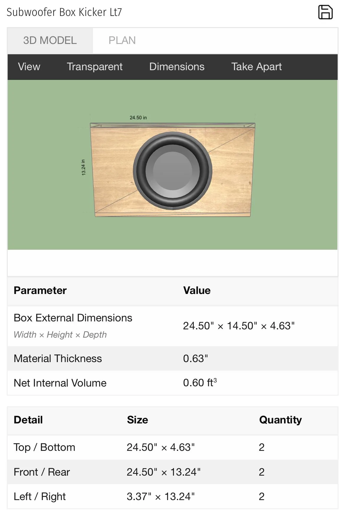

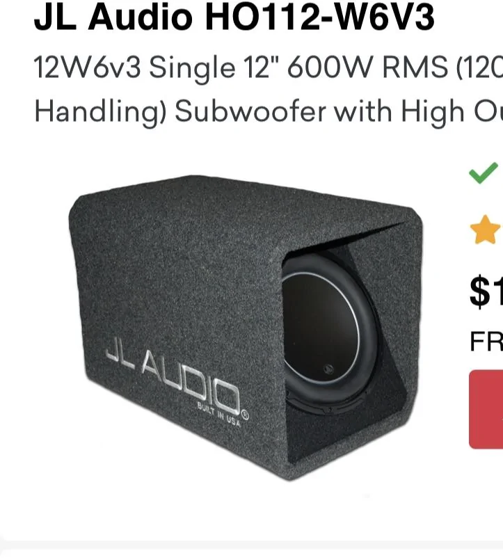

That was one design I was playing with as well, was basically this design idea (on the JL below) but the opposite side would be the same angle with the passive radiator (but everything I read about those compRT boxes seems like kicker got it right)

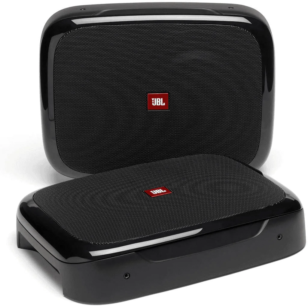

I also ran across this JBL Fuse dual passive subwoofer that intrigues me some. I'm not all that familiar with JBL so I'm also kind'a cautious about this subwoofer, but the configuration is interesting.
Ford Maverick Ordered Stereo parts 1645202253692
Ford Maverick Ordered Stereo parts 1645202280824
It's $179.99 with fairly good reviews...if you can believe them
EDIT: Each of the two subwoofers are 13 3/4 wide, 10 3/4" wide, and 5 5/8 deep when combined 5 5/8"or back to back as shown in the 2nd photo. Of course they can be separated probably for best results. Anyway, an intriguing set up.
