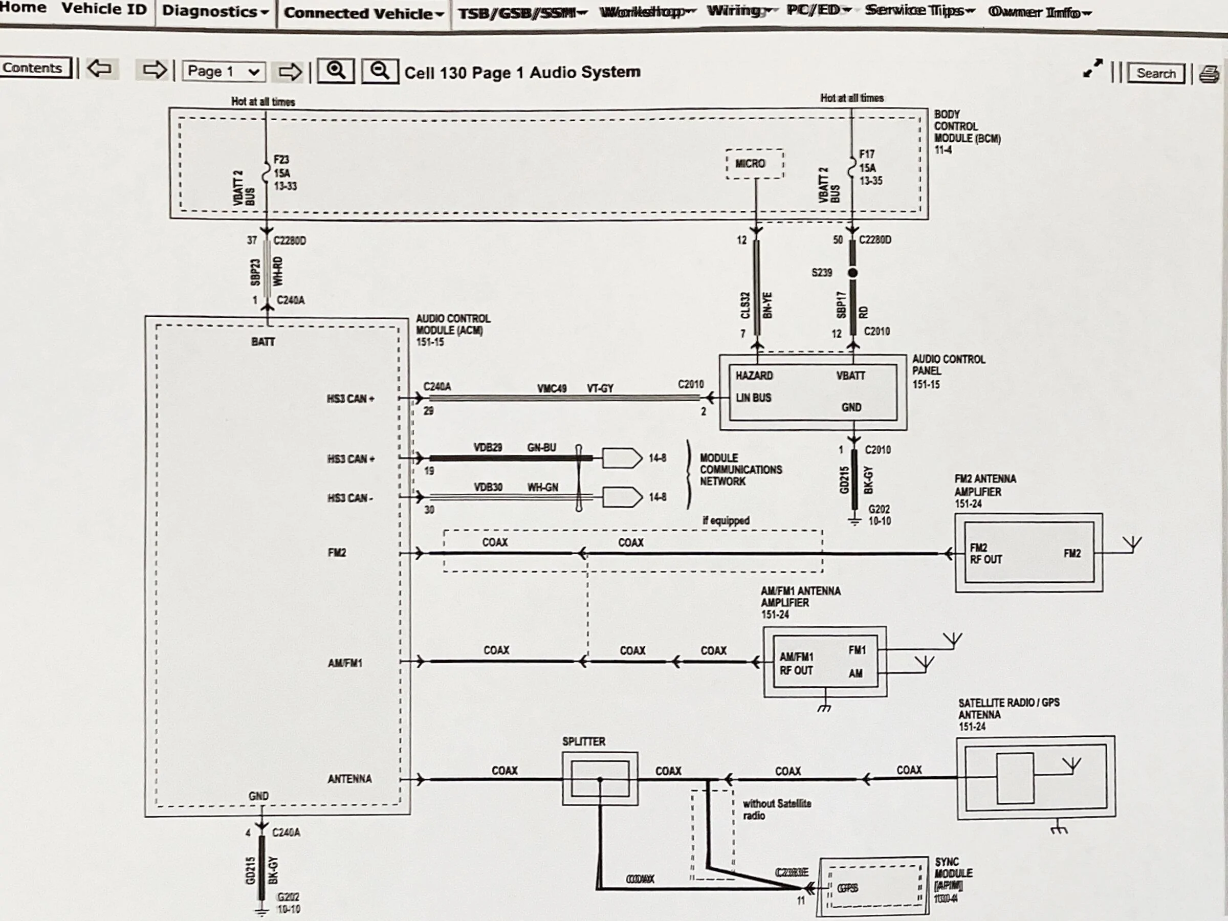

From shop wiring diagram
Ford Maverick Wiring diagram for stereo connections? ED155332-AC25-47AD-8D31-06A897C79478

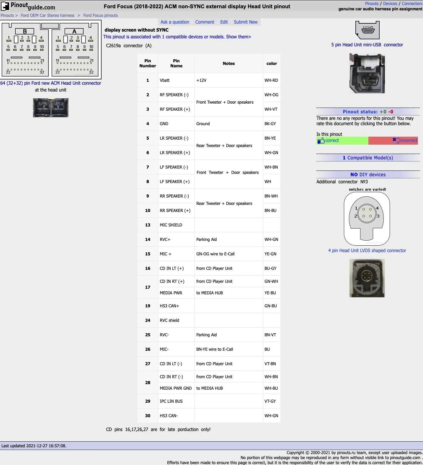

The following in diagram from a 2018-2022 Ford Focus appears to match your shop diagram noted PIN numbers on the ACM. Obviously I don't know about pins 16, 17, 27, and 28.
Ford Maverick Wiring diagram for stereo connections? Ford Focus (2018-2022) ACM non-SYNC external display Head Unit pinout diagram @ pinoutguid

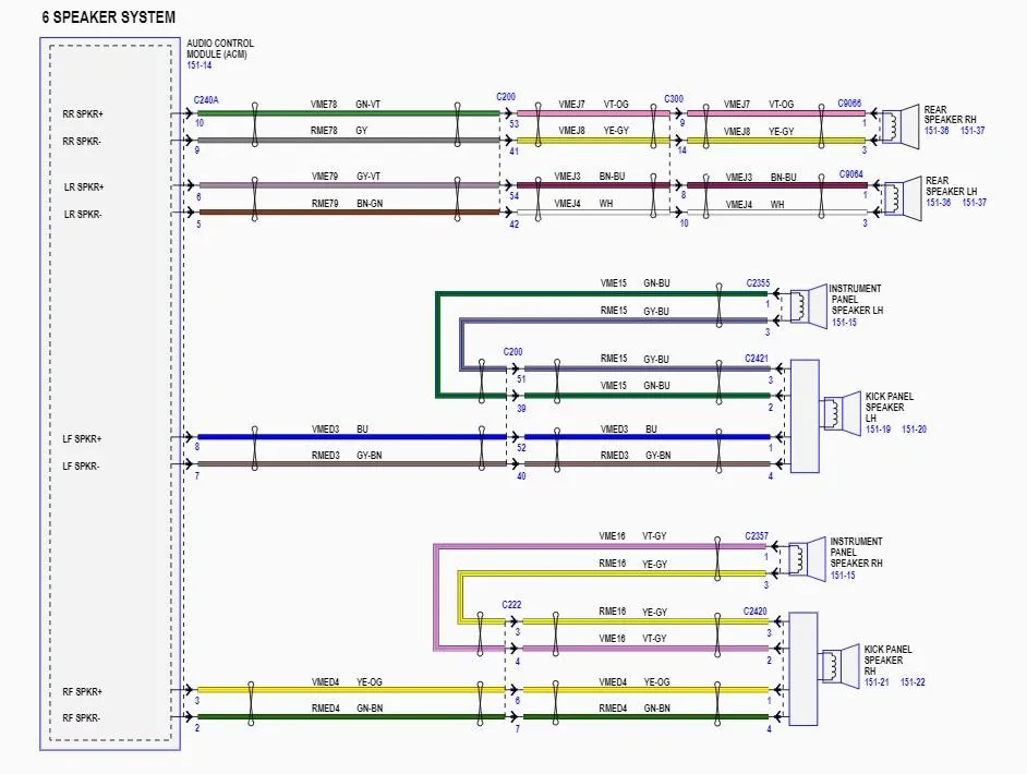

The following is a 6 speaker system wiring diagram and the PIN numbers match the pinout guide above.
Ford Maverick Wiring diagram for stereo connections? 6 Speaker System
Ford Focus (2018-2022) ACM non-SYNC external display Head Unit pinout diagram @ pinoutguide.jpg

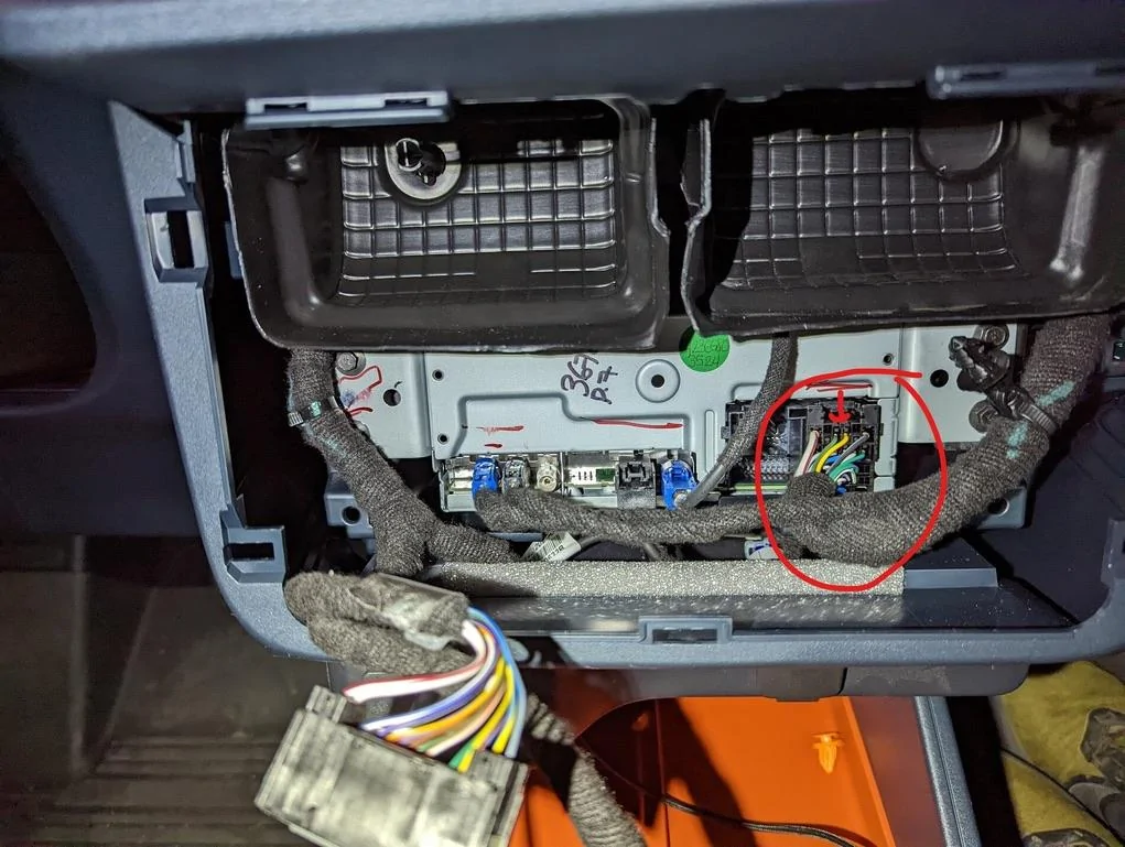

Unfortunately no, but only the "A" connector is used on my XL. Here is a photo that shows "B" empty on my XL. The red circle high-lites the "A" connector.
Ford Maverick Wiring diagram for stereo connections? 1661020745334
Recently, 07_Shelby posted 11 updated diagrams linked here: #8. And three shots directly from the manual linked here: #16. Thanks to 07_Shelby.
Here is the link for the complete thread: What is the correct wire to splice into for remote in audio harness?
Even with that info, it doesn't tell me the use for connector A. Sorry.
In this diagram for the rear which is the ground and the power pink/yellow brown/white not able to figure this out? Also did the rear speakers help sound overall? Not planning a AMP but have already upgraded the front speakers.
