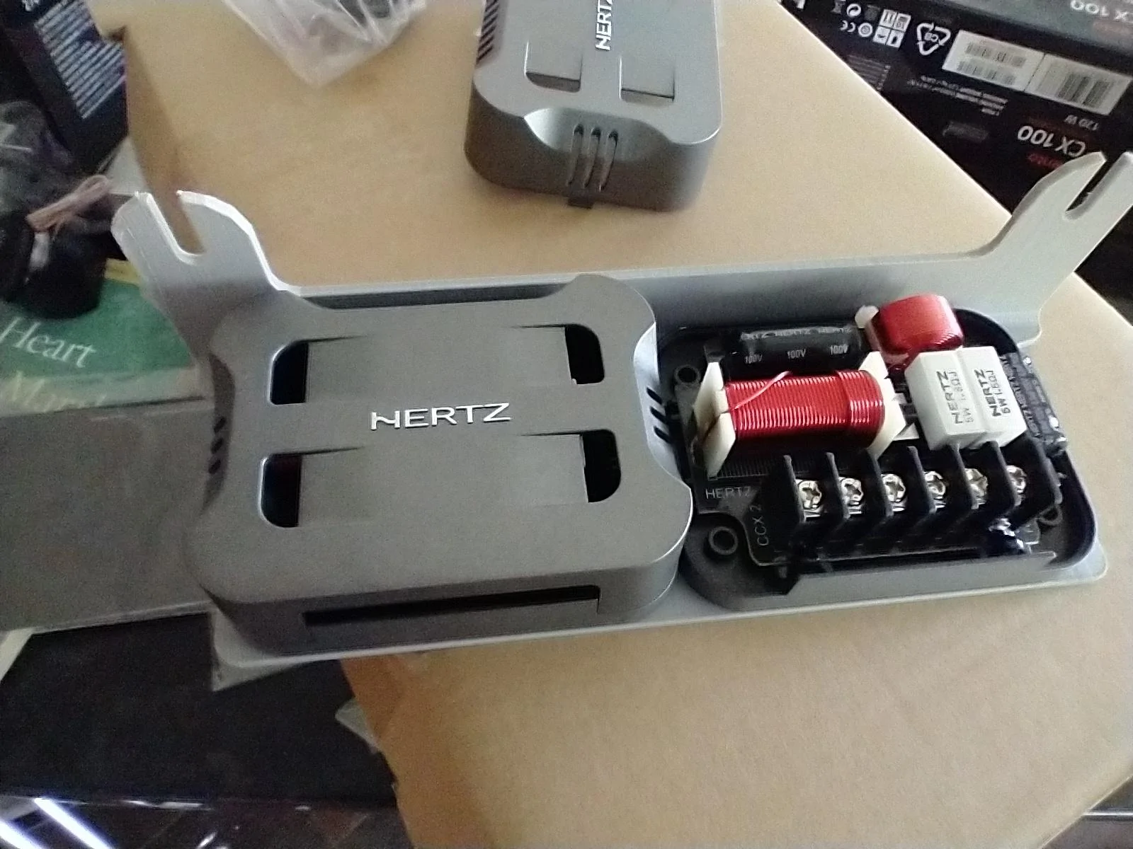

I tore into the wiring today, I've been thinking many of the same questions. Gus from Hoelwiring (he seems real knowledgeable and helpful) has been helping me get a harness together. He's going to make me something for run the fronts and rears off a Key 200.4 and I'll use another amp for subs.
The tweeters and door woofers are spliced off the factory wiring. If you want to run them through a crossover that wire is going to be severed at some point. I resolved today just to run new tweeter wiring. Running anything through the doors seems impossible without getting messy. The doors only have 2 wires, they do not loop from the door speakers back to the tweeters. Running new tweeter wiring looks pretty easy, mostly the driver side will need some fishing.
I had the neighbor kid 3D print me that bracket for behind the glovebox that was uploaded by Red Ryder. Its fits the crossovers perfectly.
