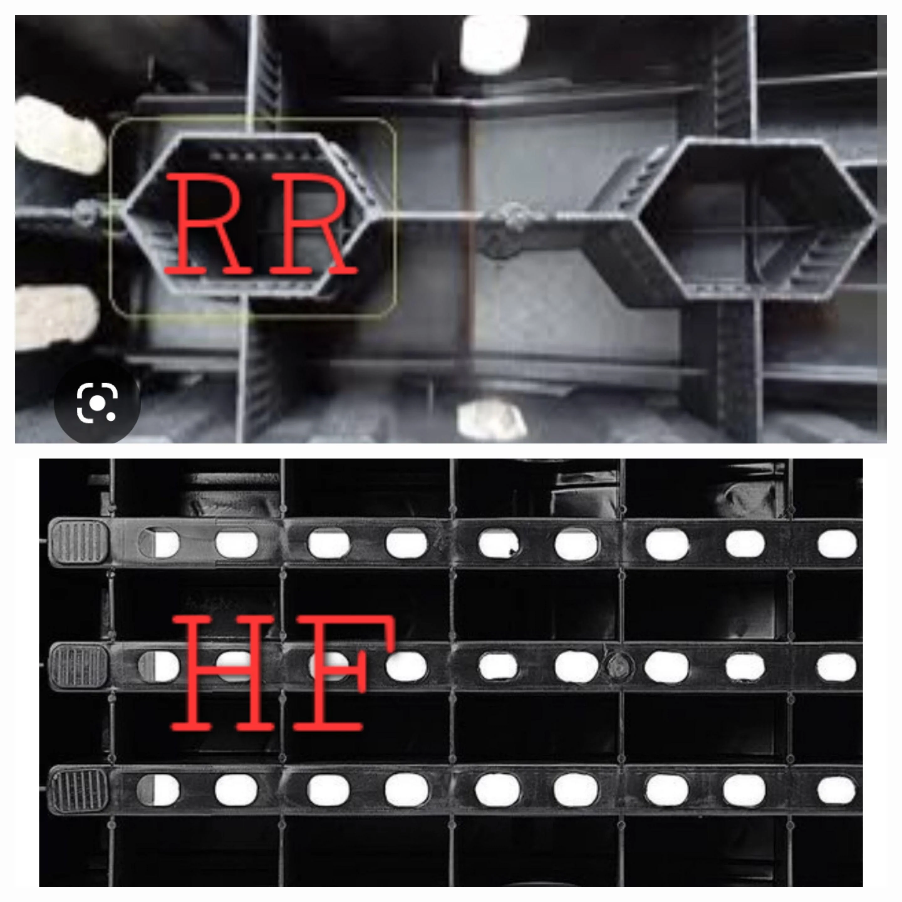

My first ramps and I went with the Harbor Freight one over the WM one. WM which sells RhinoRamps has too much open spaces on the under side. Those are weak spots to me. HF brand I think is stronger. I'm thinking as honeycomb.
Ford Maverick Ramp Recommendations for Oil Changes 20230117_212442

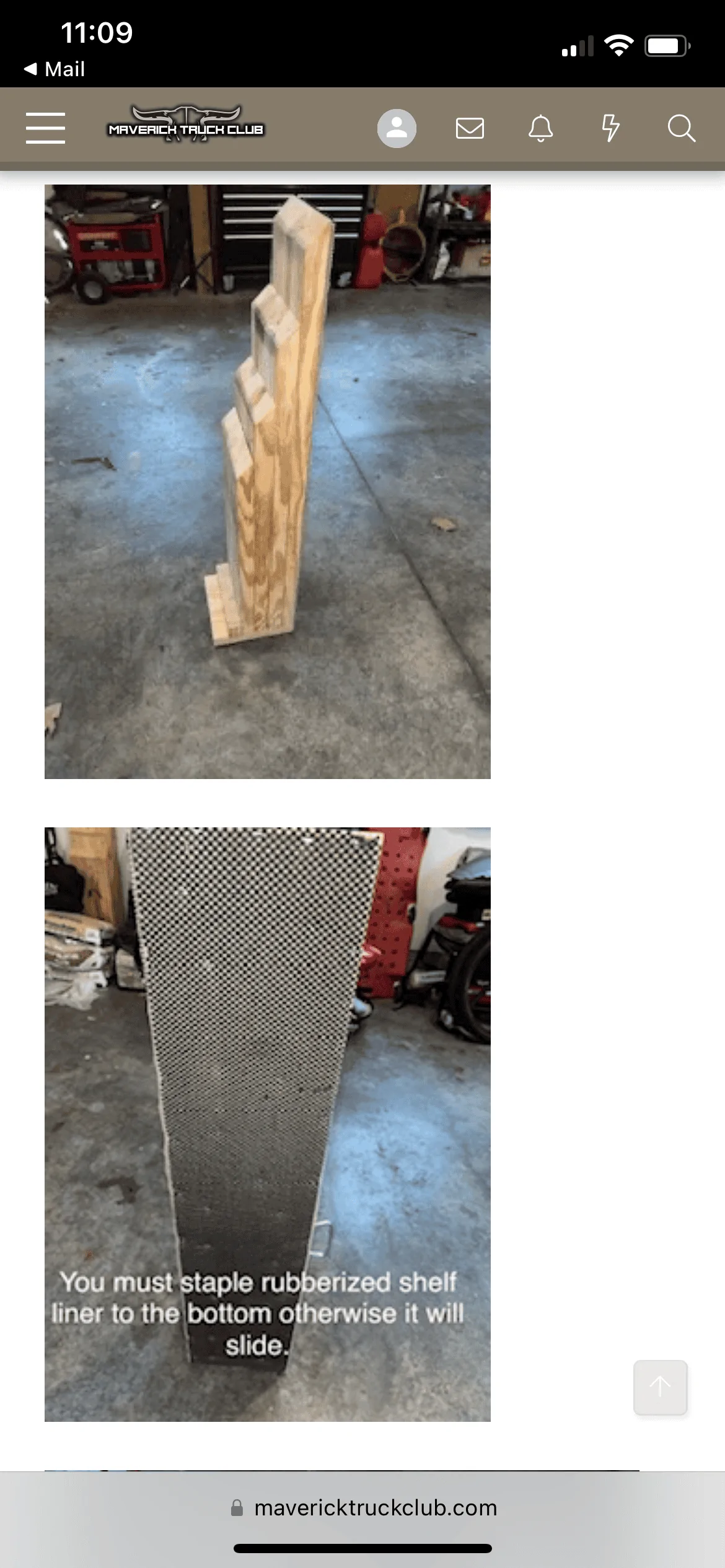

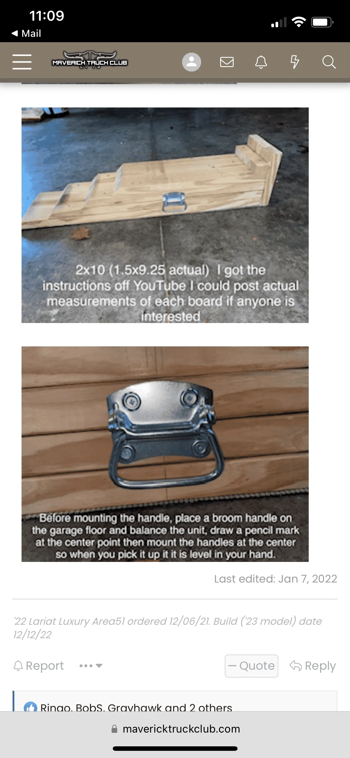

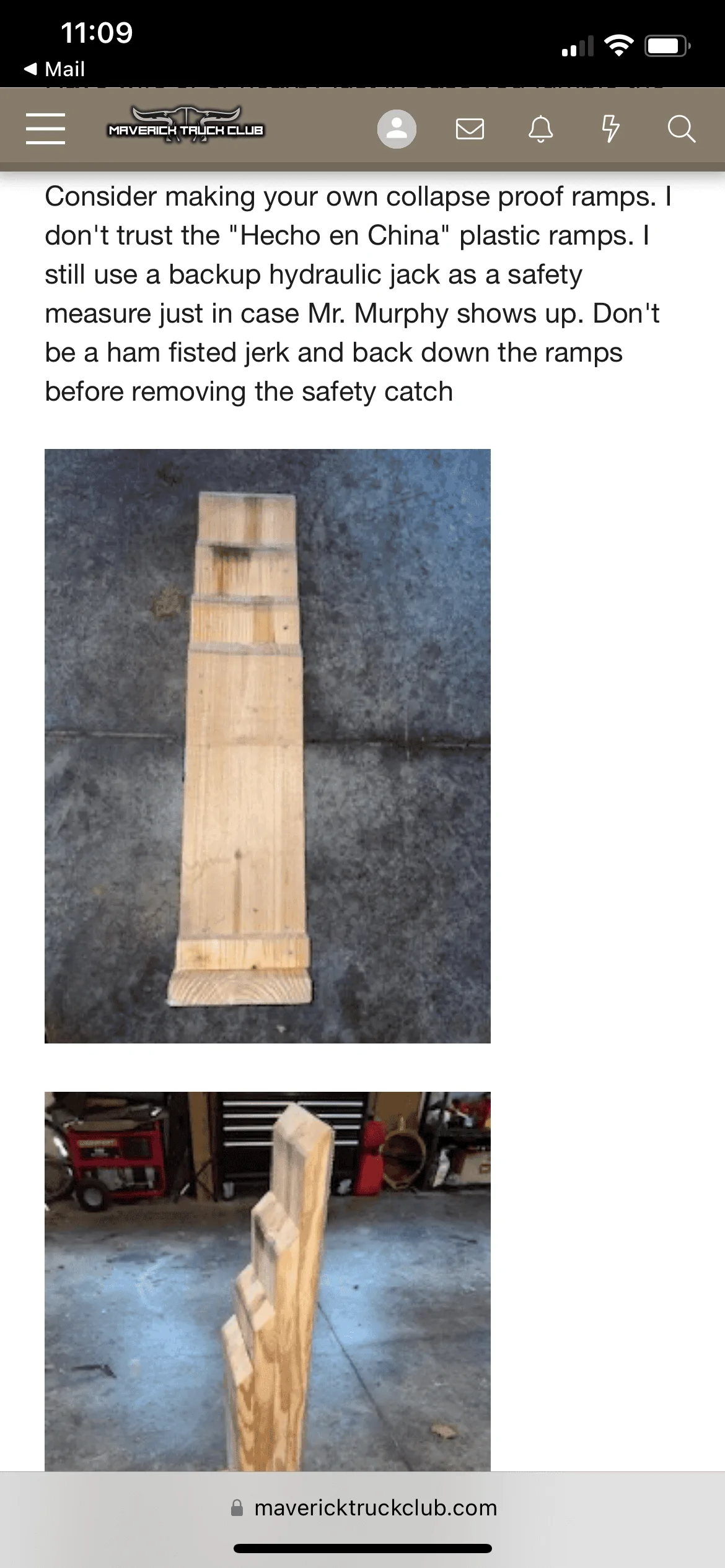

Yes. I have a recommendation. These are my ramps that I use and they are excellent. Far superior to to any composite ramp that you can buy and I don’t have to worry about these collapsing, although I still use a secondary floor jack as a safety catch just in case. This is from my post on the Fomoto drain valve. Have you considered a Fumoto for oil changes?.
Ford Maverick Ramp Recommendations for Oil Changes 1DAD60B4-69B1-409C-A146-62BBEDAB53A4
Ford Maverick Ramp Recommendations for Oil Changes 0764EBF1-5585-4533-B7EB-A61B77236D4E
Ford Maverick Ramp Recommendations for Oil Changes 9BDE6099-DB09-4946-B6FD-65B48407A210

Can you post a link to the YouTube video that you mention as I would like to build one like this.
