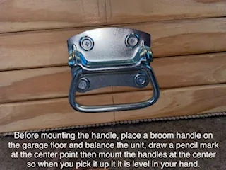

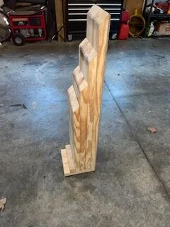

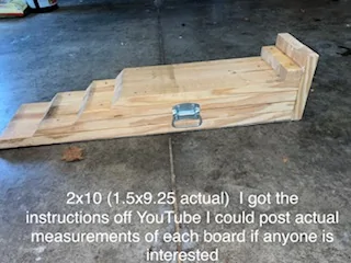

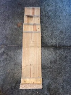

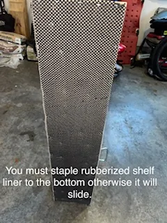

Consider making your own collapse proof ramps. I don't trust the "Hecho en China" plastic ramps. I still use a backup hydraulic jack as a safety measure just in case Mr. Murphy shows up. Don't be a ham fisted jerk and back down the ramps before removing the safety catch

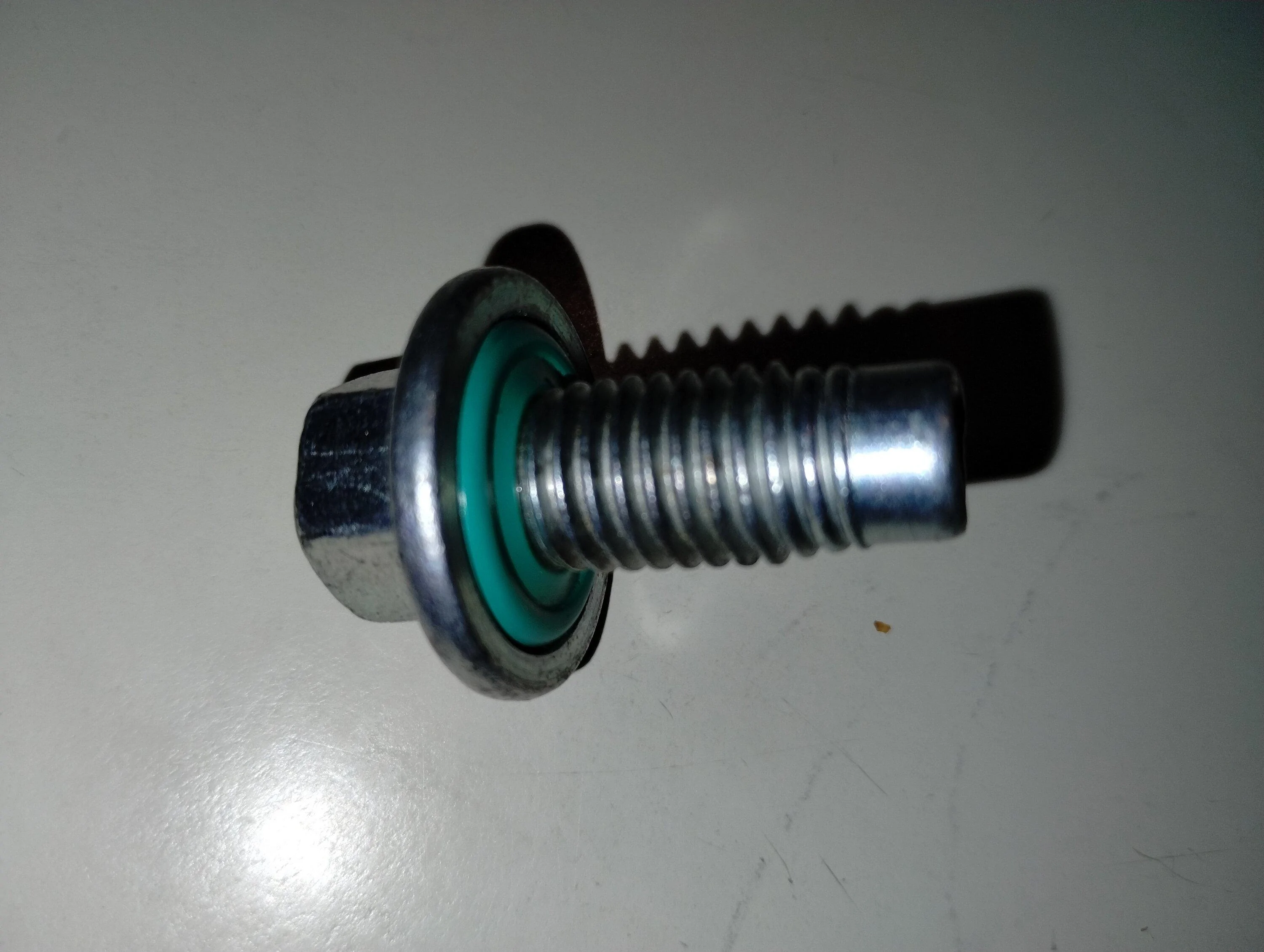

Does your drain plug look like this or is it different? 2.0L 2023 Ecoboost. This drain plug is not magnetic....you might be able to magnetize it but from the factory it does not collect metal savings.
This will..
I replaced the drain plug with a magnetic one from AutoZone and it is almost an exact match with a magnetic tip. Part number 653096 by Needa....M12-1.75 Magnetic - $7.00 I also installed a Fram 3600 TG oil filter and stuck a large Harbor Freight pickup magnetic to the bottom of it for the first couple of oil changes.
What bothers me about these quick oil plug changers is that they screw into the oil plug hole and are at an angle..usually off horizontal a little since manufacturers no longer put them on the bottom of the oil pans. They also have a barrel thickness to support the outer threads. So the inside lip of this device is sitting up above the inside floor of the oil pan, which is where particles accumulate over time that the oil filter doesn't catch. Removing the factory plug and the oil rush out may help remove these particles (magnetic oil plug definitely does) but if there is a lip on that oil plug opening it is going to prevent this along with retaining a small height of old oil in the pan. Anyone ever look into this to see if the quick release inside lip is actually sitting higher than the inside floor of the oil pan?
