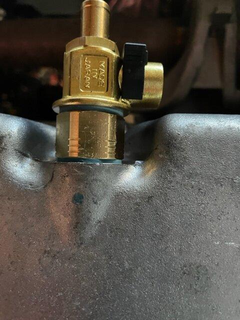

Which Fumoto valve did you purchase? Please provide part number. I've been curious which valve fits best.
The drain valve is the F137N and the adapter is the ADP-137. You will need the adapter because of the way the oil pan is shaped around the drain opening.

Why not use the standard F137 or F137S with the adapter? This combo would be a bit shorter overall.. please advise.
Also per the Fumoto website both the ADP-137 and ADP-107 are 1/2” adapters for M12 X 1.75 valves. And the F137 & F107 are both M12x1.75 valves. What’s different/why different part numbers?
The adapter is needed either way. You can use either valve - the F137N has an extended nipple to allow for the easy attachment of a drain tube. The length does not appear to be a factor as the installation is nearly horizontal. It won't be a make or break deal with either configuration. I connect a piece of tubing and drain the old oil straight into an old 5-qt. container and then drop it by my local parts store for recycling.
This is the setup you'll get with the F137N and ADP-137. They fit and work well on the Hybrid 2.5L engine. The other options are different types of valves that should work as well. These work great for me.

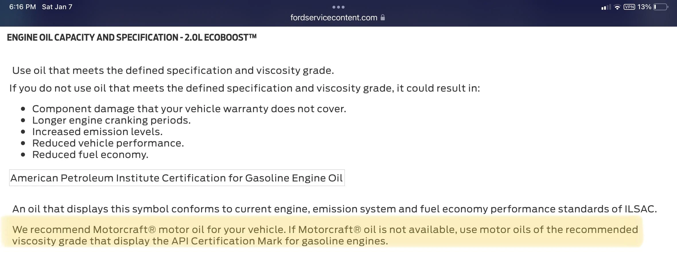

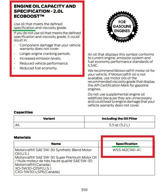

Just be careful with the oil you choose to use, Ford has specific oil spec requirements for the Ecoboost that many oils including Pennzoil Platinum, Ultra Platinum and standard Mobil 1 don't meet (yet). The oil spec they require is formulated to be less vulnerable to low speed preignition and to promote better wear of timing chain guides, both of which have been problems for ecoboost motors. Using non spec oil could present a problem in the event of a warranty claim.
Directly from the owners manual and this is the only requirement when changing oil, and it does not require WSS. “We recommend Motorcraft® motor oil for your vehicle. If Motorcraft® oil is not available, use motor oils of the recommended viscosity grade that display the API Certification Mark for gasoline engines.” BTW, Mobil 1 5/30 is WSS.
That's great but I'm just going to leave this here, also directly from the manual. Pay attention to the use of the word "Specification": As my commander use to say in the Army, "Do whatever your career (warranty) can withstand"
