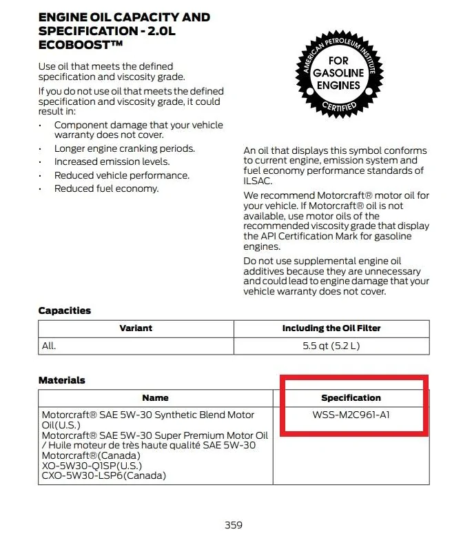

Just be careful with the oil you choose to use, Ford has specific oil spec requirements for the Ecoboost that many oils including Pennzoil Platinum, Ultra Platinum and standard Mobil 1 don't meet (yet). The oil spec they require is formulated to be less vulnerable to low speed preignition and to promote better wear of timing chain guides, both of which have been problems for ecoboost motors. Using non spec oil could present a problem in the event of a warranty claim.
No they don't. They use Motorcraft 5w-30 full synthetic which conforms to ILSAC GF-6 specifications that came out in May 2020.
Basically - they specify the most recent standard from ILSAC
Which.......all major oils conform to today - even SuperTech from Walmart.
So DIYers can safely use basically any engine oil of choice and especially Mobil1, Penzoil (Ultra) Platinum, or other high grade oils.
Straight from the owners manual:
Use oil that meets the defined specification and viscosity grade.
If you do not use oil that meets the defined specification and viscosity grade, it could result in:
  • Component damage that your vehicle warranty does not cover.
  • Longer engine cranking periods.
  • Increased emission levels.
  • Reduced vehicle performance.
  • Reduced fuel economy.

An oil that displays this symbol conforms to current engine, emission system and fuel economy performance standards of ILSAC.
We recommend Motorcraft® motor oil for your vehicle. If Motorcraft® oil is not available, use motor oils of the recommended viscosity grade that display the API Certification Mark for gasoline engines.
Do not use supplemental engine oil additives because they are unnecessary and could lead to engine damage that your vehicle warranty does not cover.

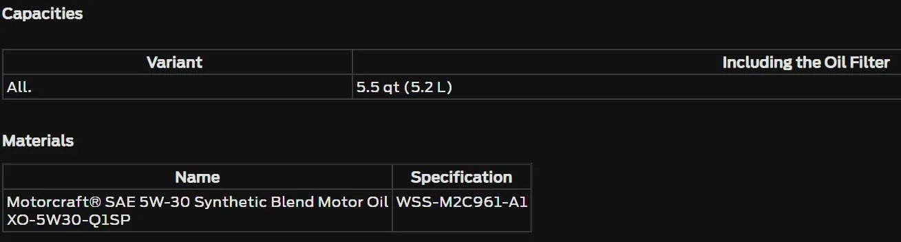

When you pull up Motorcraft SAE 5W-30 Synthetic Blend Motor Oil (WSS-M2C961-A1-XO-5W30-Q1SP) you see:
https://www.motorcraft.com/us/en_us...-oil/sae-5w-30-full-synthetic-motor-oils.html
  • Motorcraft® SAE 5W-30 Full Synthetic Motor Oil is a premium-quality passenger car motor oil recommended by Ford Motor Company meeting warranty requirements. It is API Certified for gasoline engine service ILSAC GF-6 and meets API SP/Resource Conserving

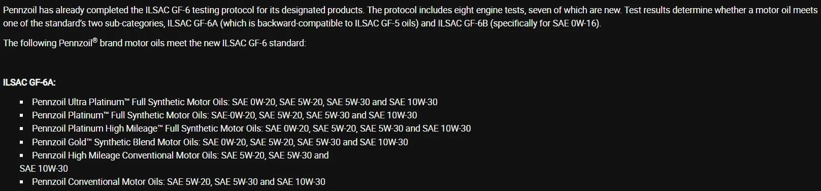

List of ILSAC GF-6 oils:
https://pqia.org/2020/10/21/motor-o...ac-gf-6a-standards-are-now-on-retail-shelves/
Plus all of Penzoil

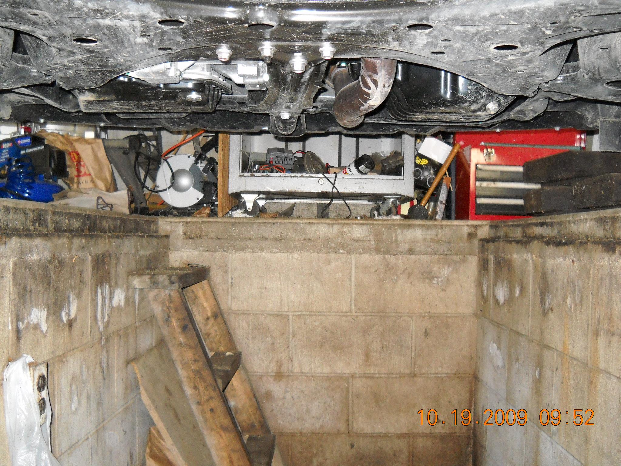

Previous home owner built a grease pit into the garage floor. FOUR inch creasoted bridge planks (on the right) sit in a recess around the pit. Even has a 120 volt outlet. Deep enough to stand in and reach UP to work on car. There is mark on the wall that is exactly the middle of the pit, so you can lean to the right a bit and hit the middle on the first try. I leave one plank in the slots and move it around to drain fluids into catch pans.
