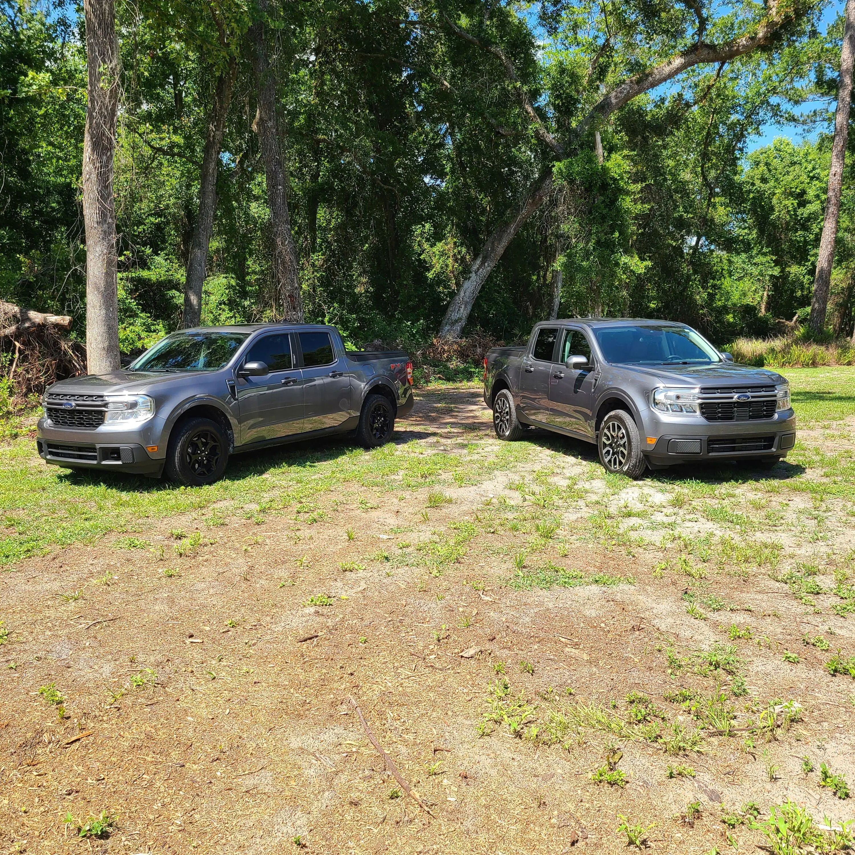

I have 25k miles on my 2022 XLT with off road FX4 package, all wheel drive, and Ecoboost engine and tow package.
I have my own shop behind the house with a lift in it and I do my own oil changes. I am here in Florida where it's hot and I tow a fair amount so I change my oil with Mobil 1 ever 3-4k miles. I know, everyone tells me it is too often, I just did my 7th oil change. It comes out really dirty when I change it. I think the GDI engine produces lots of carbon and that hot turbo here in Florida doesn't help. I also use a can of CRC Intake valve and turbo cleaner every 10k just before the oil change to keep carbon from building up on the back of the intake valves and turbo vanes.
Those clips on the front of the metal skid plate are super thin and not very sturdy. If you use anything but hand tools you will strip them out.
I have 2 Mavericks, the XLT and a Lariat. They both have over 20k miles and are running perfectly and have not given me the first problem.
