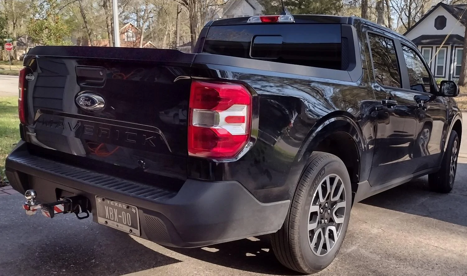

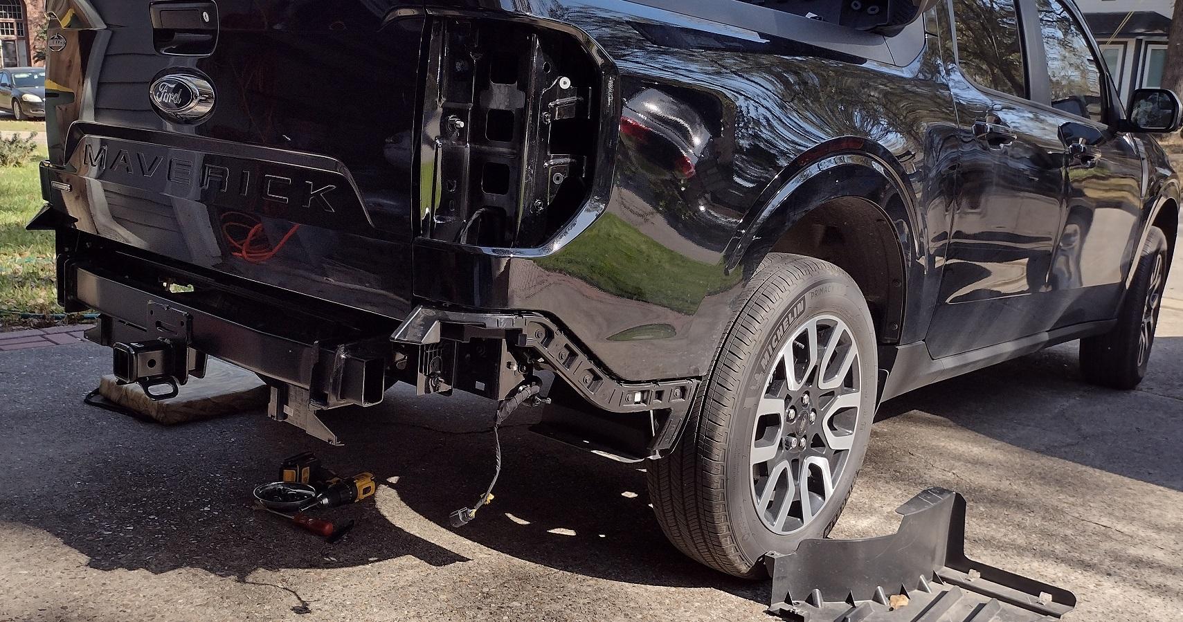

@dehaikin Here you go. I installed the tow hitch myself, and a PDF I made is available on my post:
https://www.mavericktruckclub.com/forum/threads/diy-tow-hitch-installation.10748/#post-221389
Great instructions. I completed the installation in 2 1/2 hours. Dealer said that I could NOT use Ford Pass Points for installation labor. Points are for parts only, but, you cannot use points on the Ford Part site, where I bought my hitch. I never even got an installation quote from my dealer, but I am guessing $300 or more. I love my Maverick, but am beginning to dislike FORD.

If the dealer had ADOSPEED's instructions, they could also do it in 2.5 hours! https://www.mavericktruckclub.com/forum/threads/diy-tow-hitch-installation.10748/
