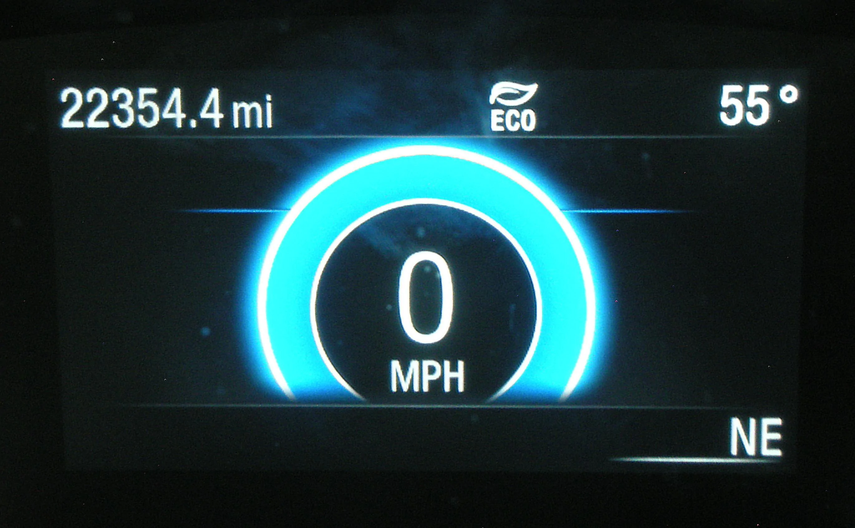

First change is to enable eco coach mode
IPC
720-09-01
xxxx 9xxx xxxx
leave x values as default
This turns on eco coach mode. If done correctly and you also have eco drive mode, the eco drive mode will now be a small leaf with the word eco underneath it.

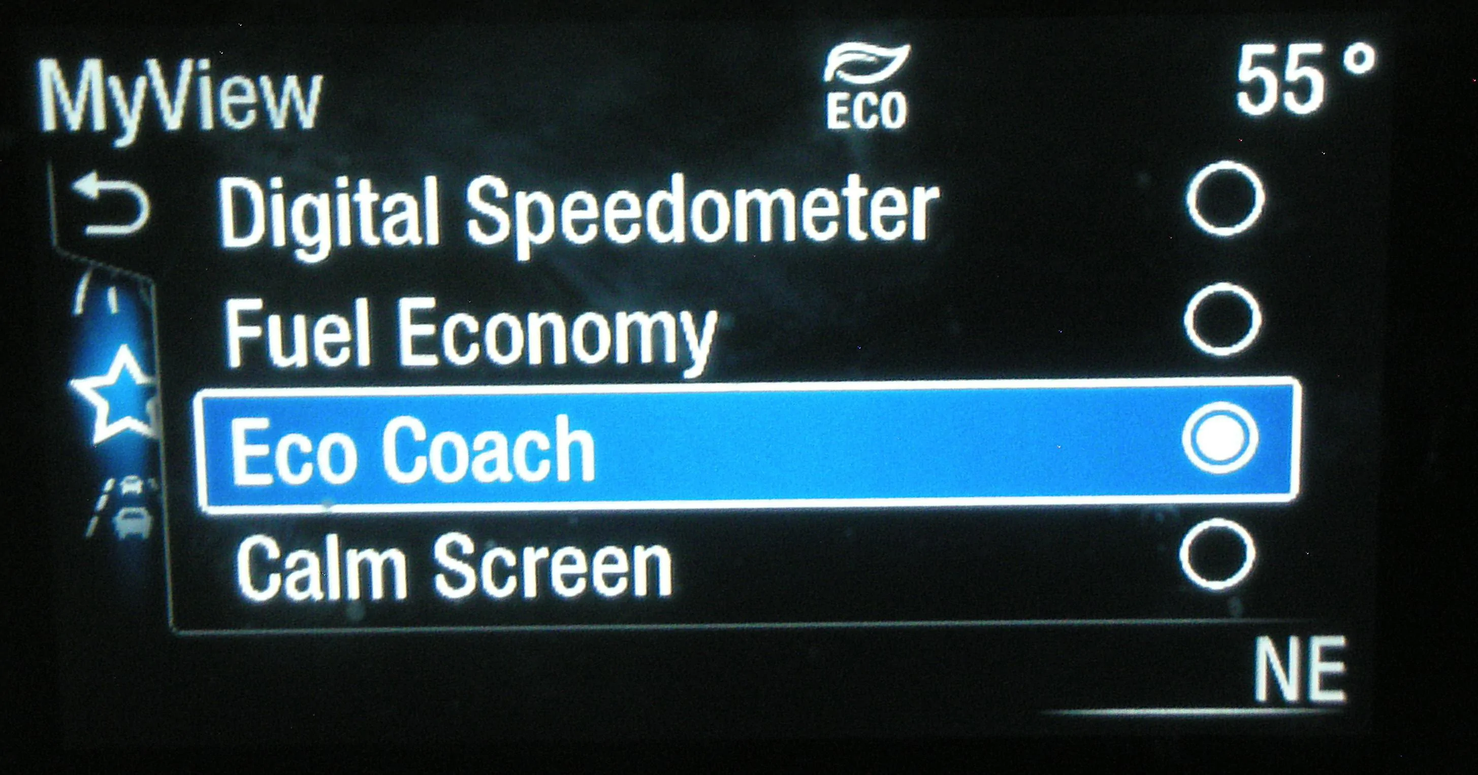

Next we need to enable the eco coach mode in the myview screen
720-09-02
xxx1 xxxx

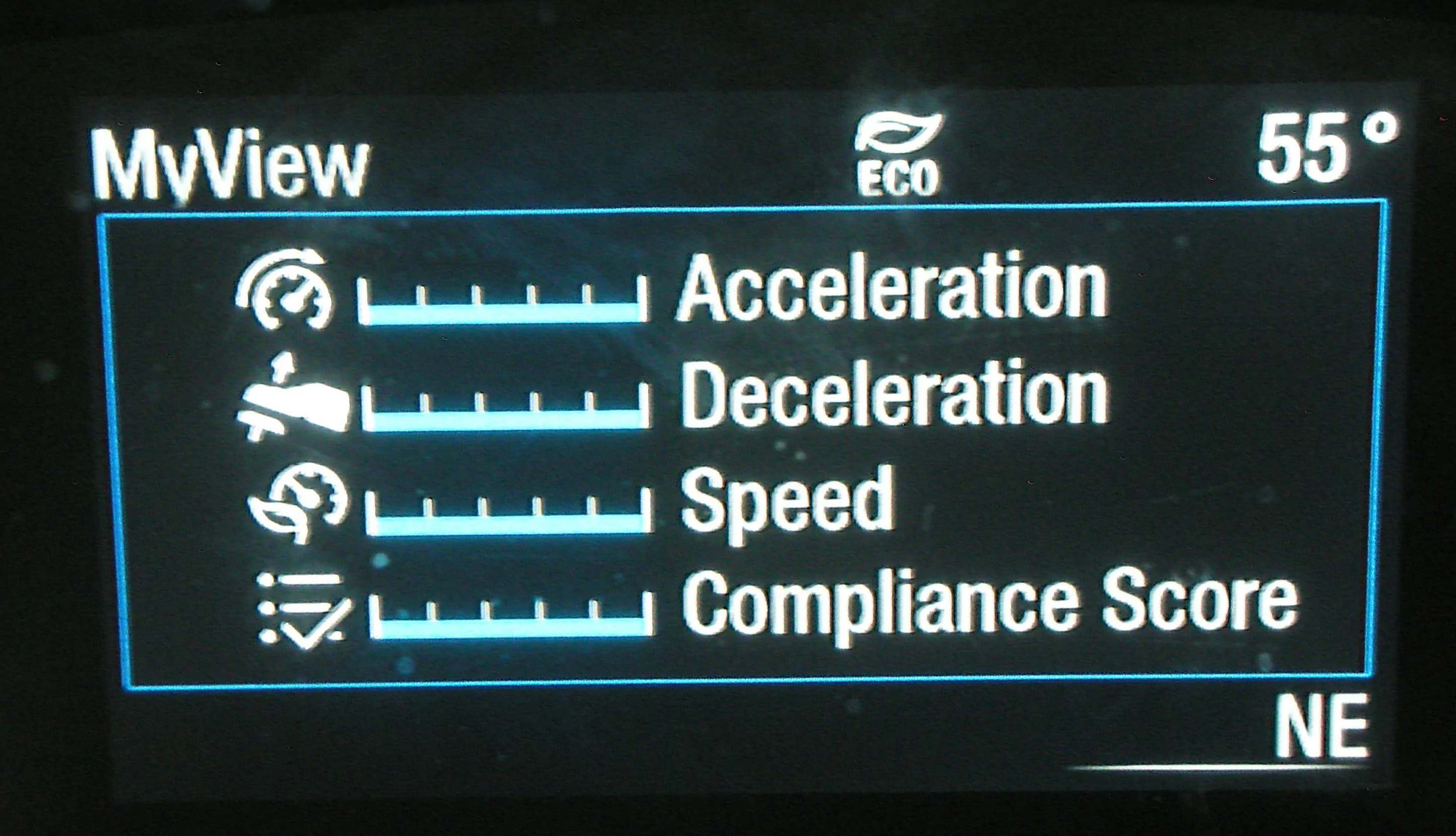

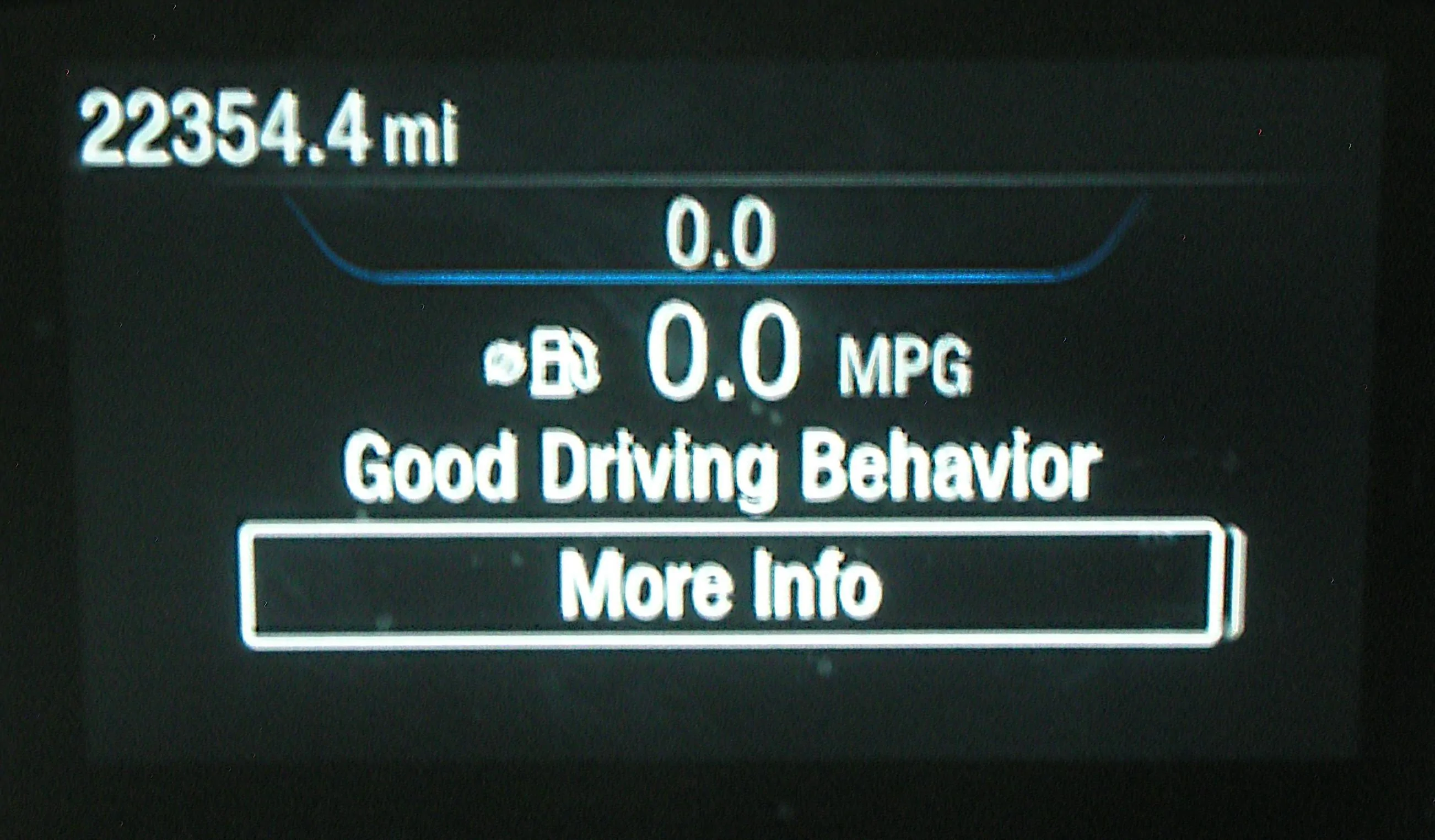

This turns on eco coach mode option in the myview screen. Once selected you'll get a digital speedometer with a blue and white circle around the speed. Pressing the okay button on the right steering wheel switch will give you driving metrics like acceleration and deceleration showing how efficient you are driving.

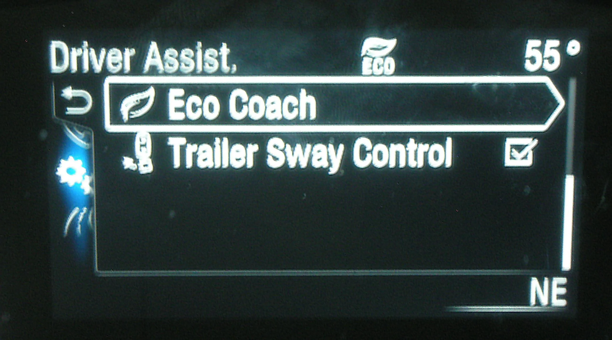

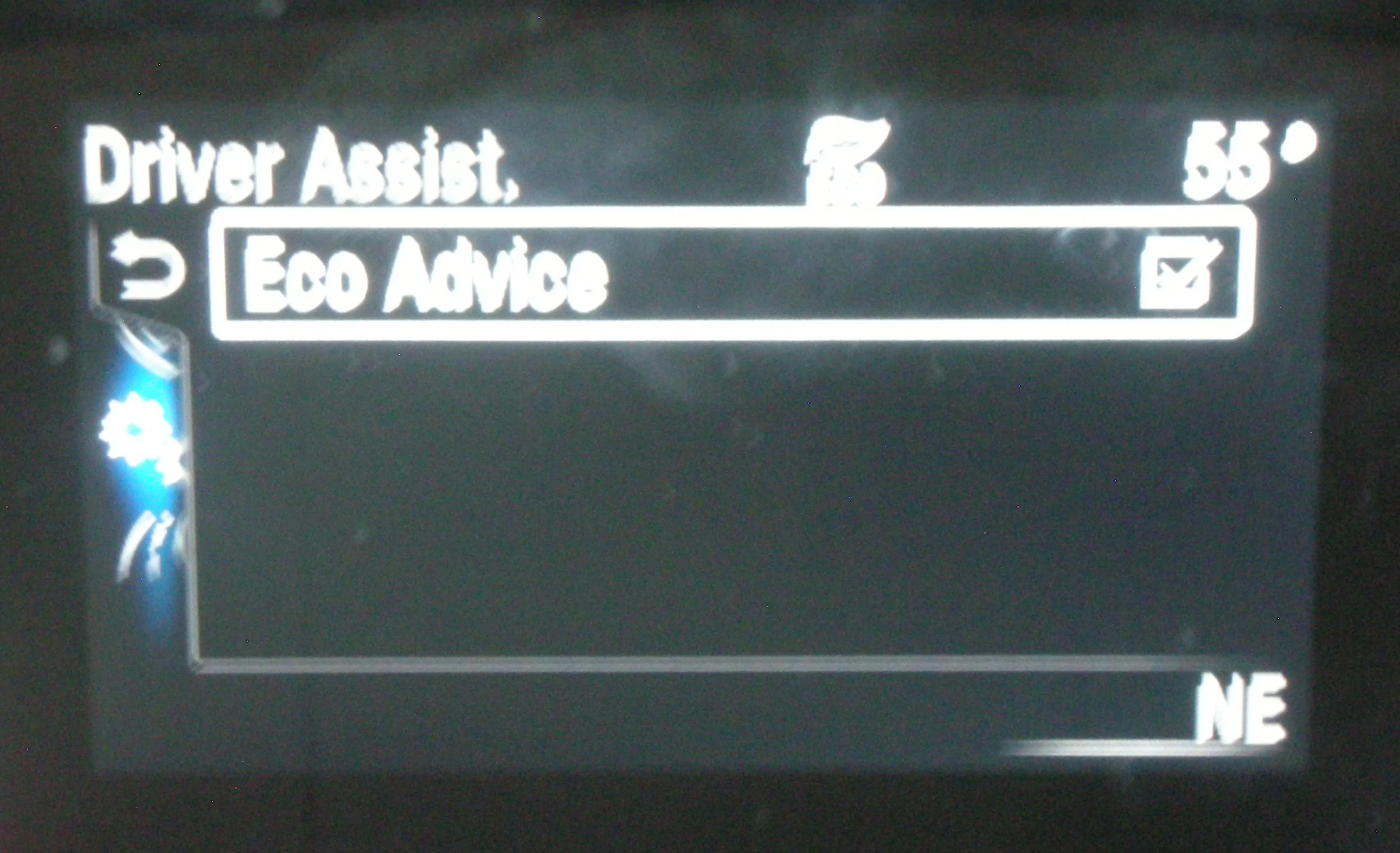

Finally there is a driver assistance option which will give you advice on how to maximize your fuel economy in the eco coach screen.
720-10-01
xxxx 2xxx xxxx
This enables eco coach driver assistance option for eco advice in the driver assistance menu.
IPC
720-09-01
xxxx 9xxx xxxx
720-09-02
xxx1 xxxx
720-10-01
xxxx 2xxx xxxx
