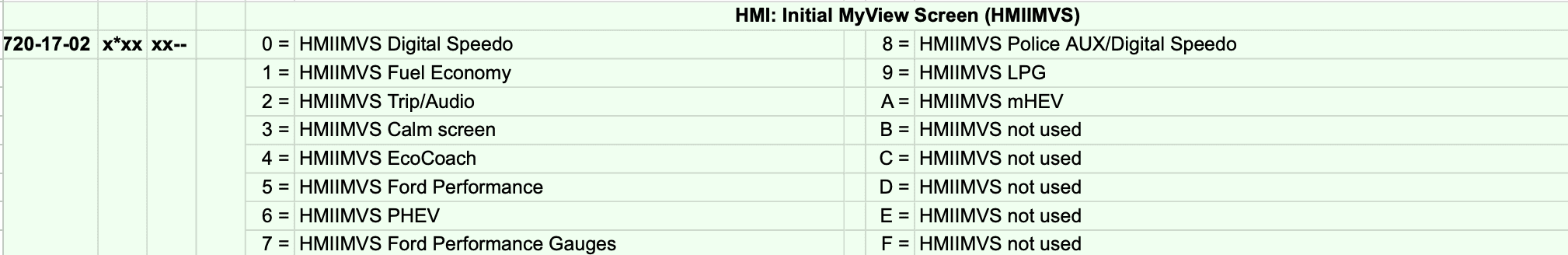

Hey I found a way you can make this eco coach screen your default MY VIEW screen. Follow the coding below and check out the picture attached.
GO TO 720-17-02
Replace the second digit with a "4" as shown below
x4xx-xxxx
Write the changes!

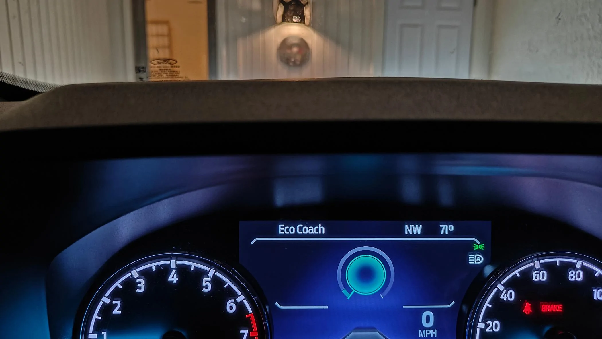

I installed the ECO Coach today as well as enabling sand & mud/ruts drive modes. Basically, I needed to do some harmless stuff to learn Forscan. Went well. But frustrating looking all over hell and gone to piece together all of the information you need to get up and running on Forscan.
Eco Coach gives the option to show the graph or data.
I also enabled Avg Speed, but I don't see it showing up anywhere.

Forscan can definitely be challenging to get set up for the first time. It's pretty easy after you've done it a few times though!. Average speed display can be turned on via the trip menu/settings and it is displayed as one of the options you can track in TRIP 1 and TRIP 2. Glad to hear your coding was successful! Check the Ultimate spreadsheet if you have not yet ! Forscan Ultimate Spreadsheet
