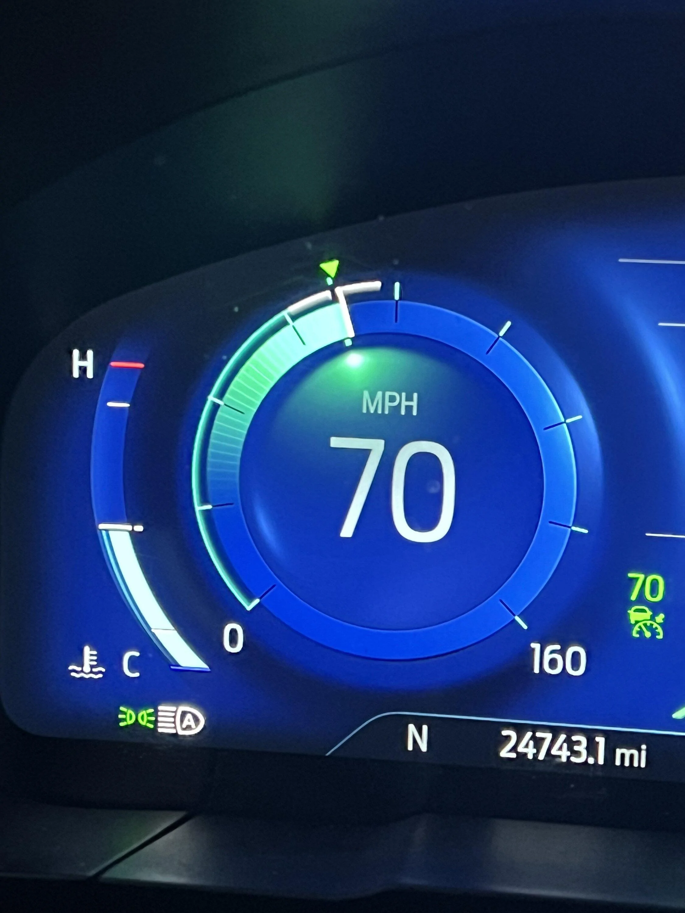

I can confirm this works on the Escape digital cluster as well. It has this cool affect the on the speedometer to let you know if it's operating efficiently . The needle glows green until you start driving aggressively.
I also get a screen option to view my metrics.

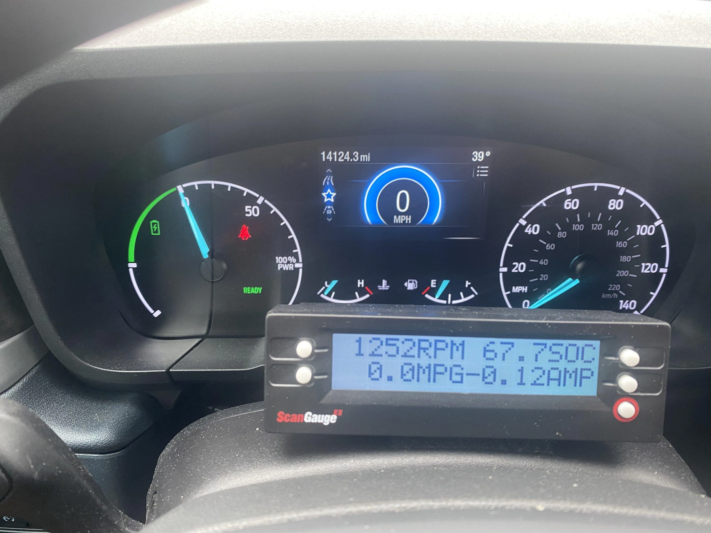

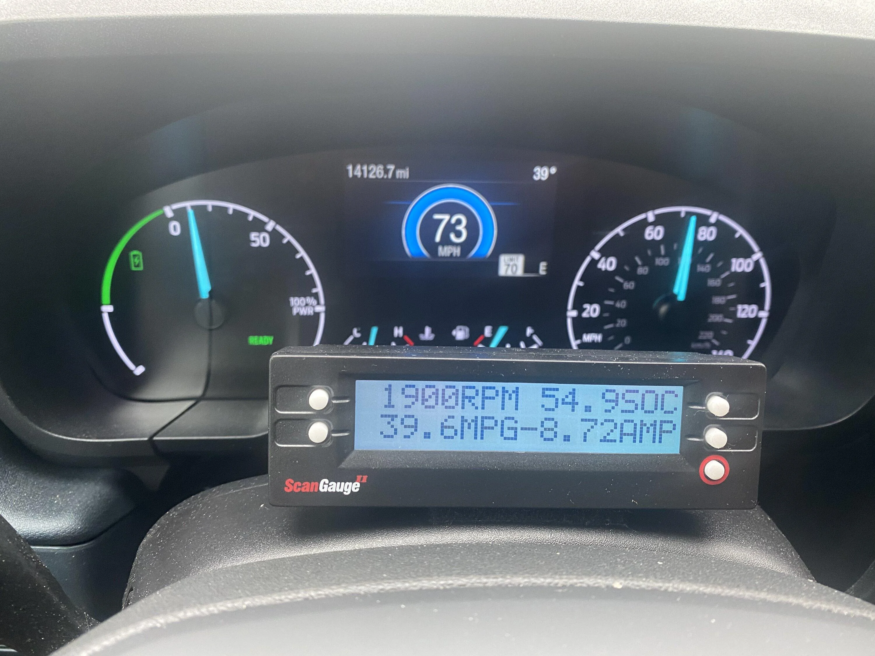

In regards to the display enabled on my XL Hybrid. It does react to indicate ‘better driving’ behavior. On the outside of the blue ring is a white stripe that comes and goes with more or less throttle. I’ve come to notice it seems to be a good indicator, while running all electric of the threshold to keep the ICE off. As the ICE is running, more throttle reduces the intensity and width of the blue ring, see the video below.

I got this working, but doesnt seem to do much if anything, does look cool tho. Watching the video above of the hybrid, my eco doesnt change rapidly like that while driving, seems very subtle.

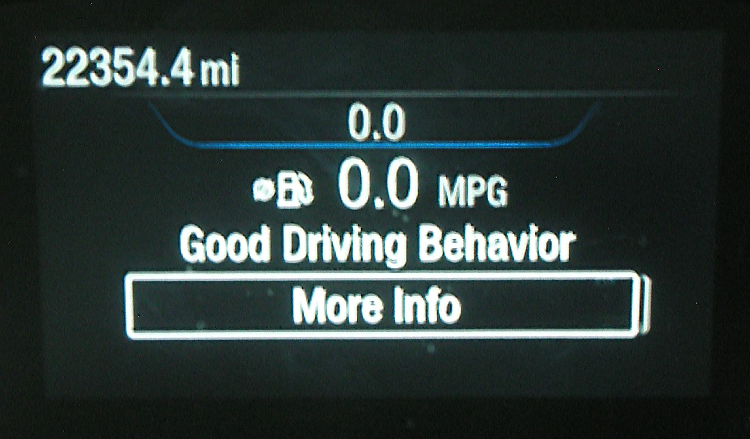

I get the Good Driving Behavior rating on my XL EB after shutting down, what is the "More Info" noted below the MPG status? How is the More Info accessed?
EDIT; I found while the driving coach is displayed, press the OK button and it will show your ratings.
