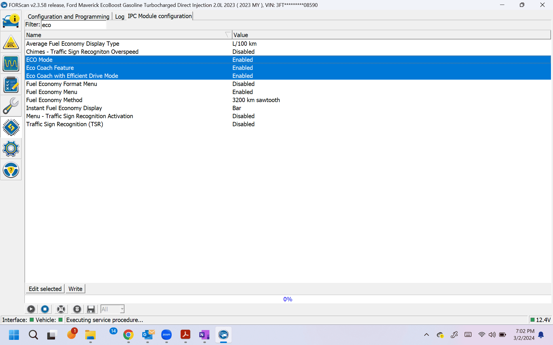

I just enabled ECO Coach on my '23 EB Lariat Lux (6/5" screen) using "easy" (aka English rather than hexidecimal). Open the not as-built IPC module in Forscan. Search for "eco" and you'll see three entries that in my case were disabled. I enabled those three and voila! See screenshot below.
Ford Maverick FORScan Mod – Enable Eco Coach Mode Screenshot (102)

So I'm guessing the reason this doesnt work on my xlt EB is that I modified the normal module and not the "as built?"
Darnon
Jul 4, 2021
5,746
7,276
WNY
Did you also enable the screen in the vehicle's Instrument Cluster options menu?
