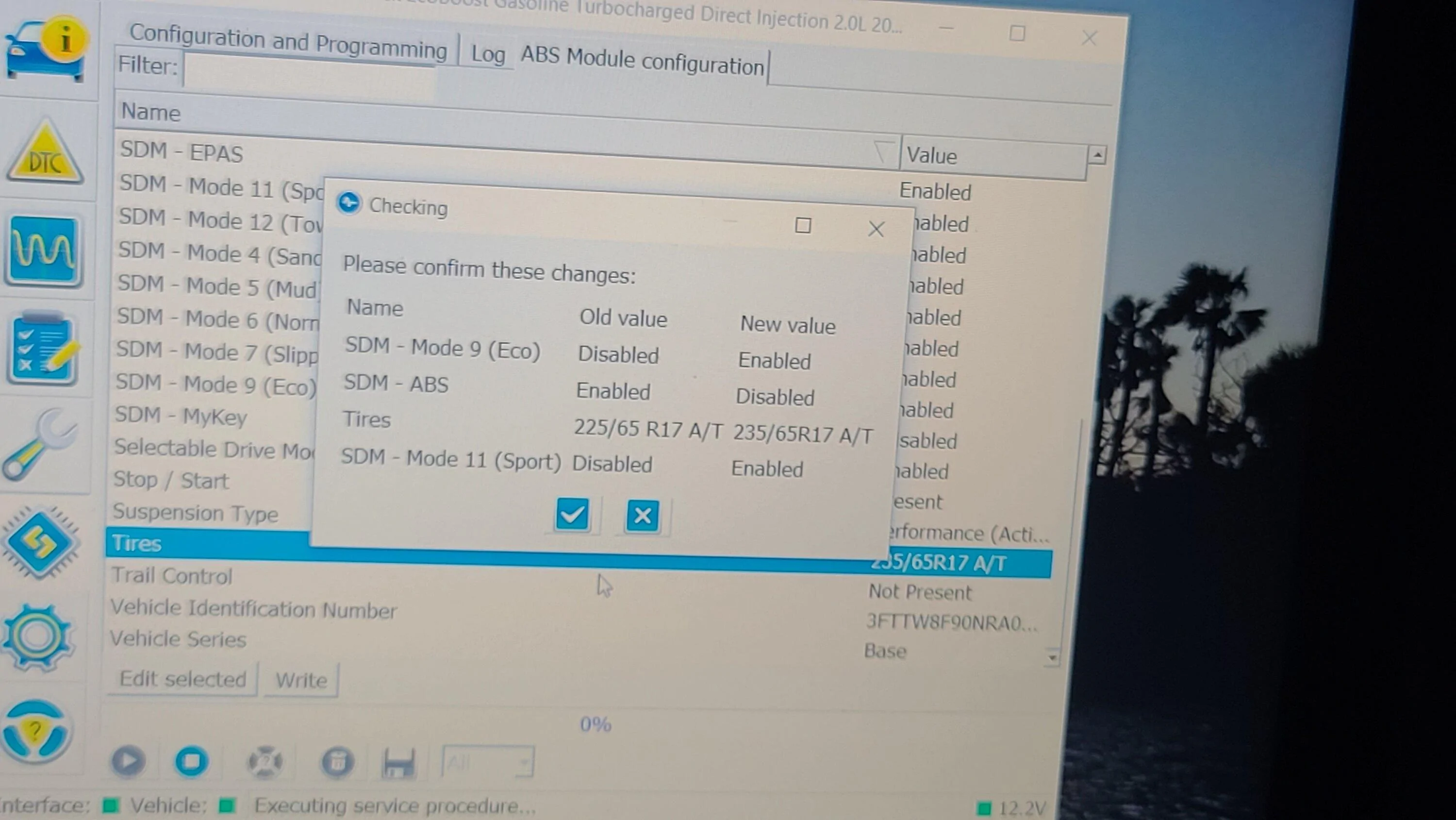

Did mine today, no issues. Fx4 with tow package added sport and eco. I also noticed a little further down on the same page there are pre set options for tire sizes. Since I put 245's on mine I switched that from the 225's to the 235's. The speedometer was only off by a few at highway speeds so hopefully that will help.
Far as I know that value is not for the speedometer but for how the braking is applied based on the size / tread of the tire. For the speedometer you need to change the tire circumference value in the BCM.
I'd also use if you change the tire circumference the stock value for an R 17 or R 18 depending your tires R value.
The circumference value is in MM like 2273 which converted to hex is 08E1, that is the unloaded circumference of a 225 stock tire and stored here after converted to hex.
BCM
726-04-04
xxxx-xxxx-**xx
This line gets the first 2 digits and in this case that would be 08
726-04-05
**xx-xxxx-xxx
This line gets the second 2 digits and in this case that would be E1.
To do the actual tire circumference calculation using 225 65 / R17 as an example
First we need to calculate the sidewall height which is (profile ratio * width) / 100
That value will be in mm.
SH = (65 * 225) / 100 = 146.25 mm
Next we need to calculate the tire diameter.
First we need to convert the rim size into mm.
To convert any value from inches to millimeters and vice versa
X inches * 25.4 = Y mm
conversely
Y mm / 25.4 = X inches
rim = 17 inches * 25.4 = 431.8 mm
Second the actual diameter which is rim size + (2 * sidewall height)
tire diameter = 431.8 mm + (2 *146.25 mm) = 724.3 mm
Finally the actual tire circumference is
C = tire diameter * pi
C = 724.3 mm * 3.14159 = ~2275.45 mm
The loaded weight circumference is usually 96% to 99% the circumference calculated as following
for 96%
.96 * tire circumference value in MM
for 99%
.99 * tire circumference value in MM
The module is picky about the value so you'll have to experiment with values in that range to get it to take.

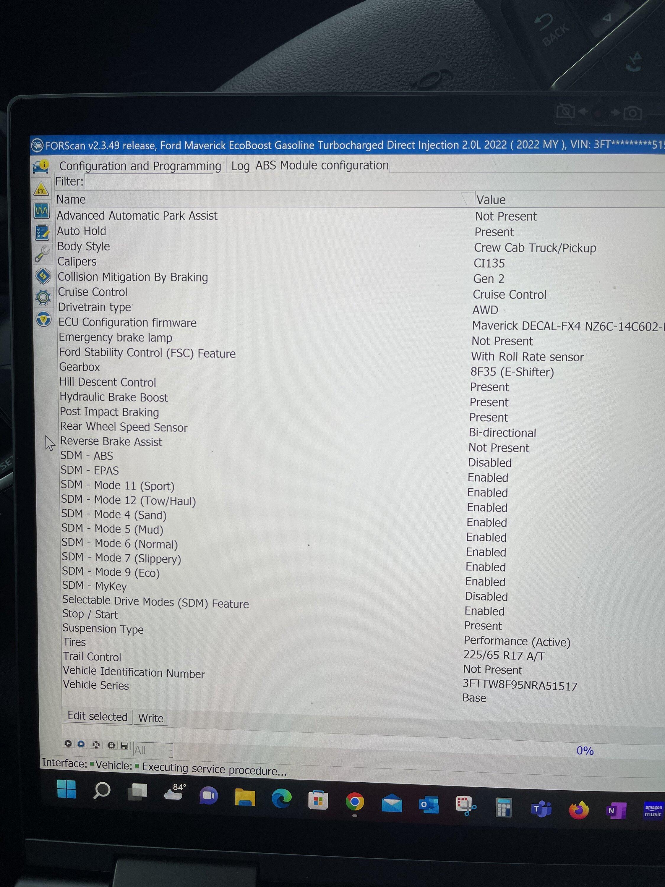

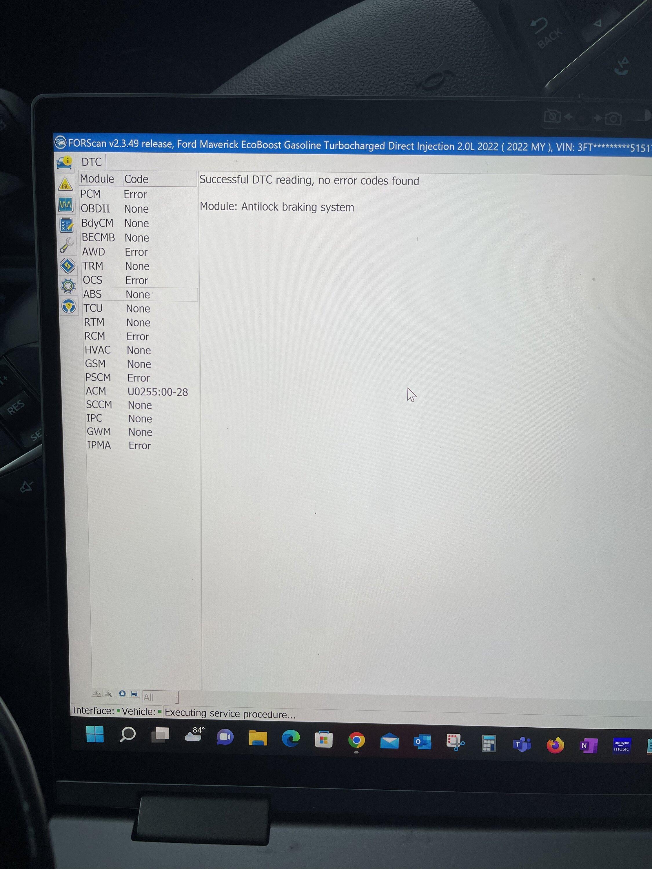

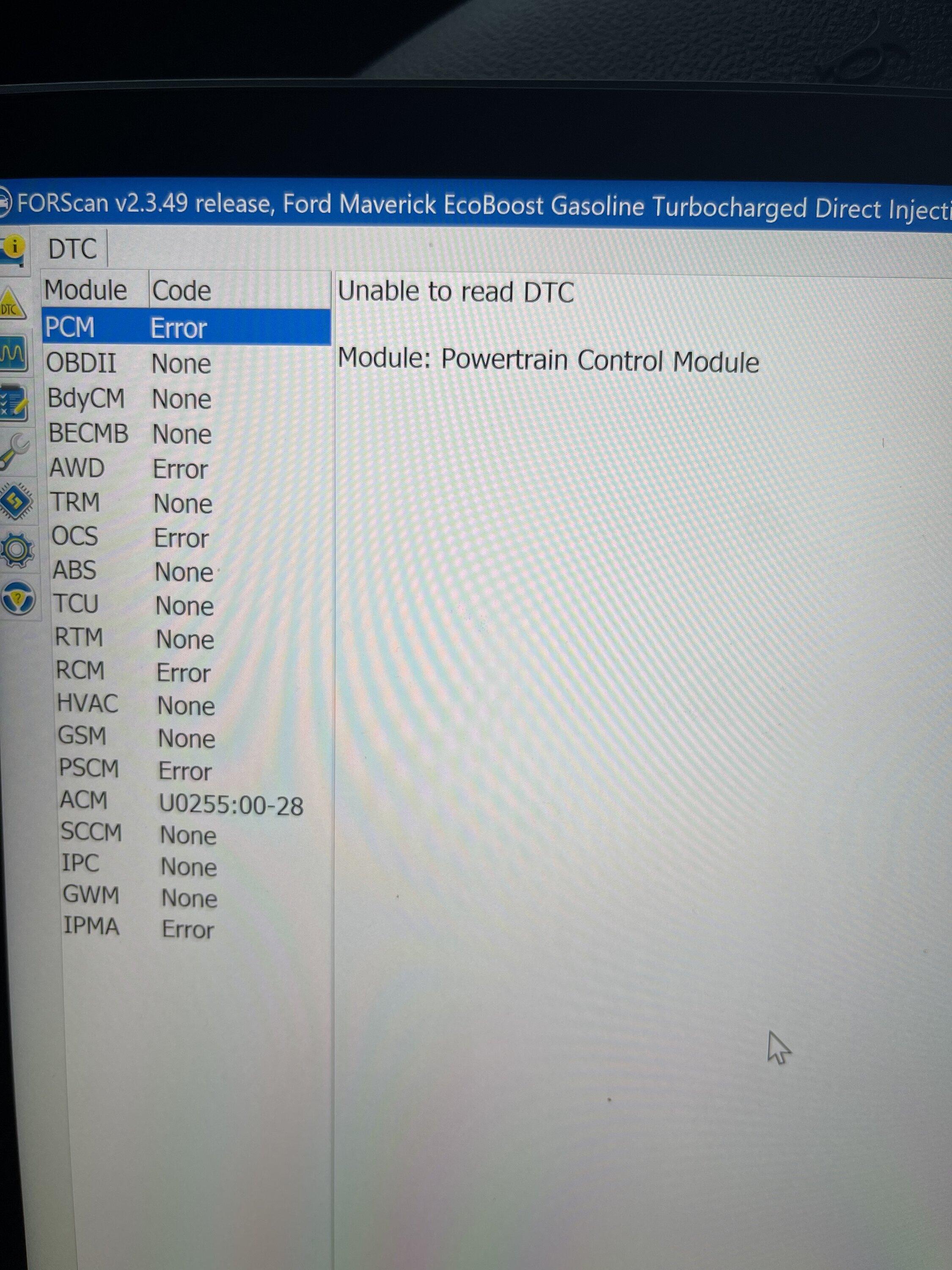

Hooked up, took some pictures as I’m not really sure what to make of it but the ABS has no DTC. Won’t show what DTCs all other modules are seeing. Eco and sport is still set up the same.
Only thing I can guess is you didn't have the key turned fully on with the engine off for the DTC not reading in the other modules. Your ABS settings all look good otherwise.
