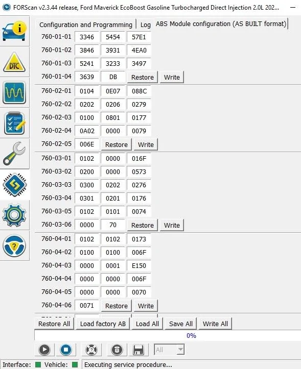

This assumes you know how to use Forscan. Also make sure you back up your ABS settings before doing this. If you screw it up badly a simple restore of your back up settings may not be enough. You might also have to do an ABS module reset afterwards.
There are 2 ways to go about this.
Method 1 - enable either the FX4 package or non FX4 package.
To switch between both
ABS
760-02-01
xxxx-xxxx-x*xx
For non FX4 package and eco / sport drive modes enabled change to xxxx-xxxx-x1xx
For FX4 package and mud / snow drive modes change to xxxx-xxxx-x8xx
Next you need to enable the selectable drive modes for the package you want active. See SDM section for drive mode selection.
Method 2 - This allows for all 4 modes to be usable at the same time
First you need to disable ABS as a selectable drive mode. This will bypass register 760-02-01. You can leave that setting to your vehicle's default setting.
ABS
760-04-01
xxxx-xxxx-x*xx
change * to 0 to disable the ABS drive mode selector
This now allows you to use all 4 modes.
Next you need to enable the drive modes. See SDM section.
SDM (selectable drives modes)
This is required regardless of what method you use.
shortcut code - recommended for method 2.
760-04-03
0000 0001 EB5A
This enables all 4 modes - eco, sport, mud and snow
To enable FX4 modes
FX4 package - recommended code for method 1
760-04-03
xxxx-xxx1-E1xx
This enables both mud and snow modes
xxxx-xxx1-x1xx
xxx1 = snow
x1xx = eco and sport not present
xxxx-xxxx-E1xx
Exxx = mud / ruts
To enable non FX4 modes
non FX4 package - recommended code for method 1
760-04-03
xxxx-xxxx-6Bxx
6 = eco and sport present / no mud mode
B = eco and sport
xxxx-xxxx-63xx
3 = eco w/o sport
xxxx-xxxx-69xx
9 = sport w/o eco

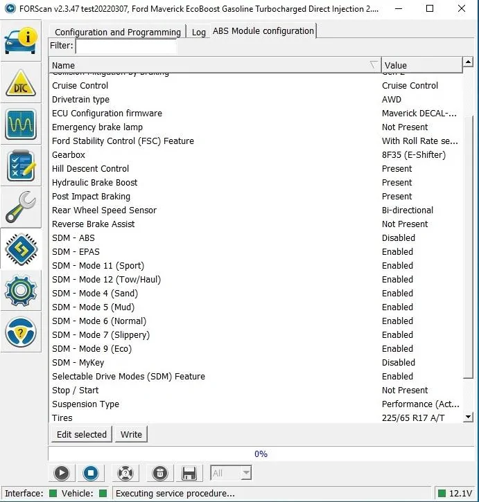

I found the instructions confusing and had to figure out on my own how to use Forscan. First make sure you have the latest version, as all the modes you need to change are in plain English. Then make sure to back up all the modules. I can't find where I wrote down how to do that.
Once I figured it out how to make the modifications, I tried to write down simplified instructions that (hopefully) I can remember next time I go into Forscan. Hopefully these make sense to you too :)
How to Add Eco and Sport modes with Forscan
- OBD & USB plugged in
- Connect Car first, vehicle interface upper left, OK
- Key ON
- Configuration and Programming, 3rd from bottom on left
- ABS Module configuration
- Run Service Procedure (lower left)
- Select SDM . . . ABS
- Edit Selected button (lower left), change to Disabled
- Do same with Sport and Eco modes, change to Enabled
- Write changes (lower left)
- Turn vehicle off
- Start car

Yes but you're not disabling ABS on your brakes. This has been asked and discussed in this forum before. Don't ask me what it does, but you have to do it, and you still have ABS braking, I've verified it. I cannot get my wheels to skid no matter what mode I'm in.

Yes, all done with Forscan. The instructions could be better. Tried once to figure it out with no success and posted here. Then someone told me you need the latest version, which ends in .147 and has specific features added for the Maverick. I had the .146 so upgraded to .147 and everything was in plain English, no spreadsheet needed and no mods to the "as built" files, which are all codes. I ended up figuring it out how to do it by trial and error. Basically you can back up each module using the "as built" files, then update the software in the module that doesn't say "as built." (example: you'll see an ABS file and another ABS AS-BUILT file). I'm attaching a screenshot showing changes in the ABS module for the drive modes. Keep in mind that when you disable "ABS" it has nothing to do with your brakes, you're just allowing a different configuration to the drive modes than what it came with from the factory. Here are the changes I made:
ABS MODULE
disabled ABS
enabled Sport, Eco modes
BCM MODULE (BODY CONTROL MODULE)
disabled BMS / Auto Start Stop system
IPC MODULE (INTEGRATED CONTROL PANEL, OR INSTRUMENT CLUSTER NAVIGATION)
disabled Auto Stop Start
disabled Chimes - Driver Belt Minder
disabled Chimes - Passenger Belt Minder
disabled Chimes - Vehicle running with door open (2-Manual Transmission)
