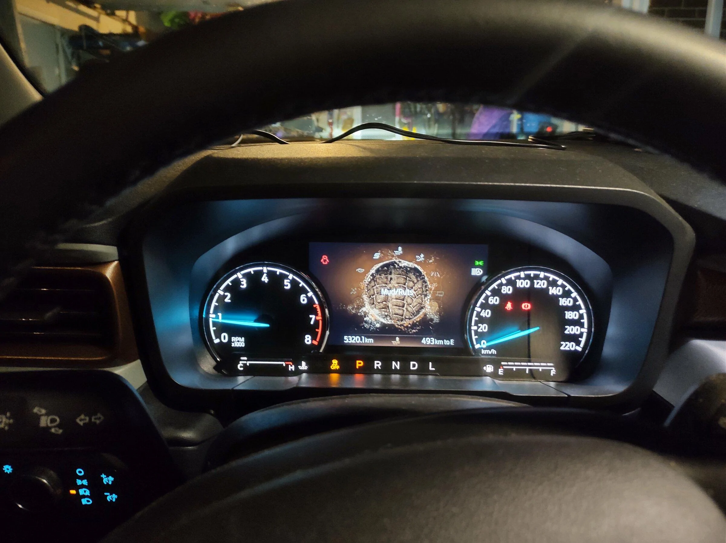

!!!NON FX4 LARIAT INSTUCTIONS!!!!!!
Alright so I got the extra off road modes working on my non fX4 maverick.
- got this obd2 adapter: https://www.amazon.ca/dp/B07MQ8GHG3/ref=cm_sw_r_apan_glt_i_14CF8KYJA9D325QCYEHC
- pluged in the USB on my laptop and installed the proper driver following the instructions (CH340)
- Downloaded this version of Forscan:
https://forscan.org/download/FORScanSetup2.3.47.test20220210.exe
- after install right click on desktop icon then properties then select "run as administrator" and "run in windows 7 compatibility mode" then click OK
Launch
installed the software then loaded the 2 month free license:
https://forscan.org/forum/viewtopic.php?f=5&t=836
Went to my truck and DID NOT PRESS BRAKE and pushed the on button
connected the OBD2 adapter to the truck then plugged in the usb cord
**note** if you have the 400w plugin inverter, it will NOT power the laptop till the engine is running. Might want an extension cord if you have a bad laptop battery
- relaunch Forscan then click on the connect icon (bottom left) and follow instructions.
- After all the modules have loaded, follow these instructions:
https://photos.google.com/share/AF1...?key=N3NQVExhUFpxeGNxUVRuNU4weGRTN1dkRnRPOEV3
- after you have entered in all the modes you need, press the start button to turn off the truck and open the door then close it and wait 30 seconds.
- start the truck and see if you have all the modes LIKE MUD/RUTS AND SAND
Ford Maverick ForScan mod - enable all drive modes: eco, sport, mud and snow (confirmed working) maverick off road modes

I have an XLT AWD on order. No lux pac so it has the basic screen. It doesnt have FX4. So what your saying is I can enable all the drive modes the FX4 has on my regular AWD by using Forscan and my laptop?
Yes
