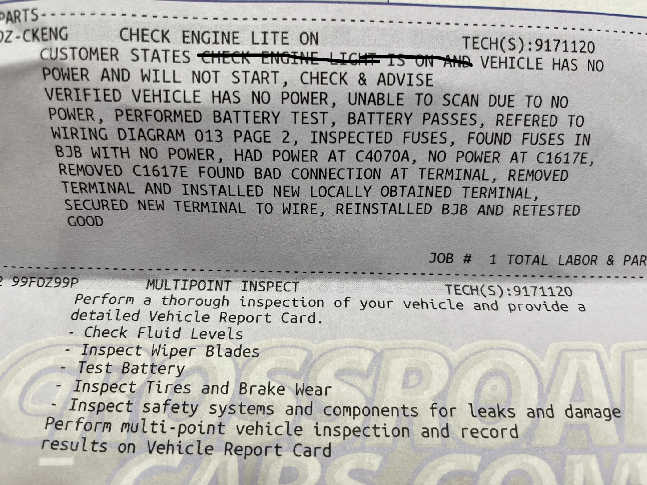

Got my Maverick back with fix. Some of you Edward Mechanical Hands might decipher this and determine if this is the same fix, or different in any way?
minor note: I never told them I saw any CEL, dunno why they wrote that.

Looks like they just replaced the lug on the cable end. Not sure if 1617 is the front cable end or the harder to access one behind it
