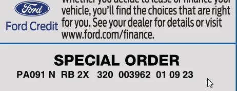

Do you know where's the best place to check my truck's build date?
My Window sticker had the build week 1-9-23. Ford email on 1-18 said it was built.
Ford Maverick Hybrid Dead XLT Window Sticker Build 01 09 2023
