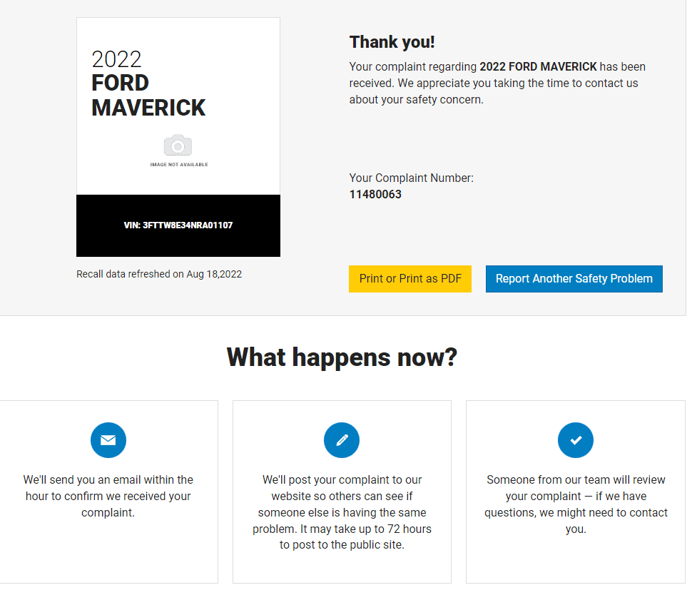

STRANGE NOTE ON NHTSA WEBSITE AFTER FILING REPORT. See the bottom of my report confirmation, where it says that my complaint will be filed on their website so that others can see it in case they are having the same problem. When filing my report, I had no opportunity to review other Maverick complaints.
Ford Maverick Tracking DEAD HYBRID Mavericks Reported Dealer Solutions / Fixes ... 1660861761205

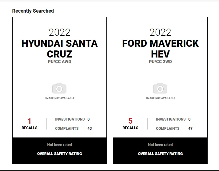

02.02.22 I purchased a Hyundai Santa Crux Limited - expensive, perhaps quality build comes with a price? I was willing to pay that price, then wait for the 1st Edition AWD, 4k Tow loaded Maverick, and I also have a Alto Blue Lariat Hybrid on order, which is not yet "in Production". And again I am willing to have and pay for the comforts... Not arrogance, just what I value.
It genuinely seems that the cost of the SC Limited and safety is also to be an added "plus" with this Santa Cruz - check out the NHTSA comparison:
Ford Maverick Tracking DEAD HYBRID Mavericks Reported Dealer Solutions / Fixes ... 1661116795576
I believe there are more than 2x as many Mavericks sold, but similar number of complaints… not a great argument.
apparently providing information is the establishment of an ARGUMENT? Hahaha...
Have a good day - oops did I create another argument?
