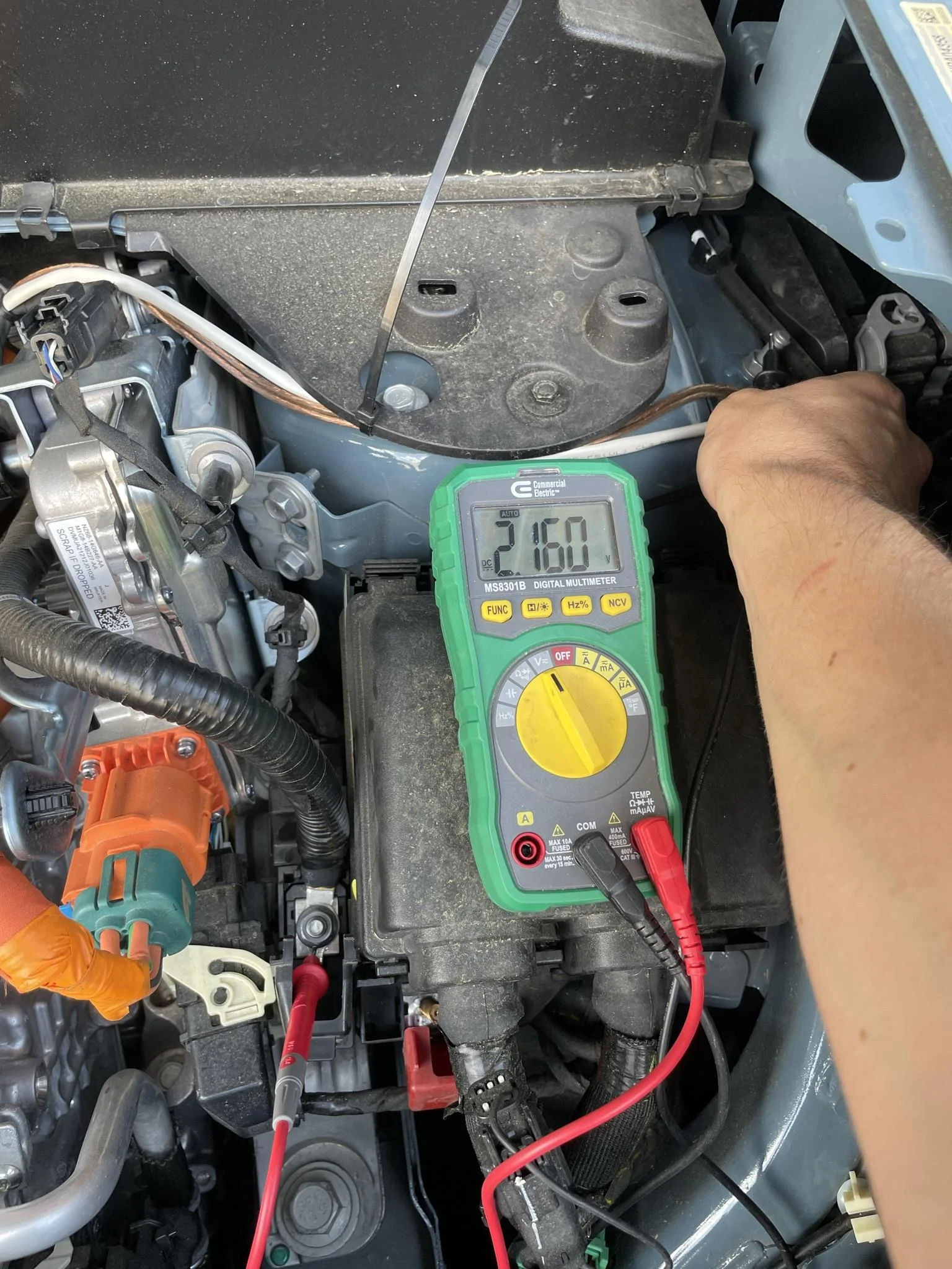

Welp mine just bit the dust. I'm at the office, I got back from lunch, hit the button to turn off, and it immediately went dead. Tried my little vehicle jump charging brick on both the battery and the jump terminals under the hood but nothing happened. Jiggled and pressed the wiring harness connection but it seems solid under the safety wrap but that might just be a tight wrap more than a tight connection, I dunno. Waiting on a tow to dealership.

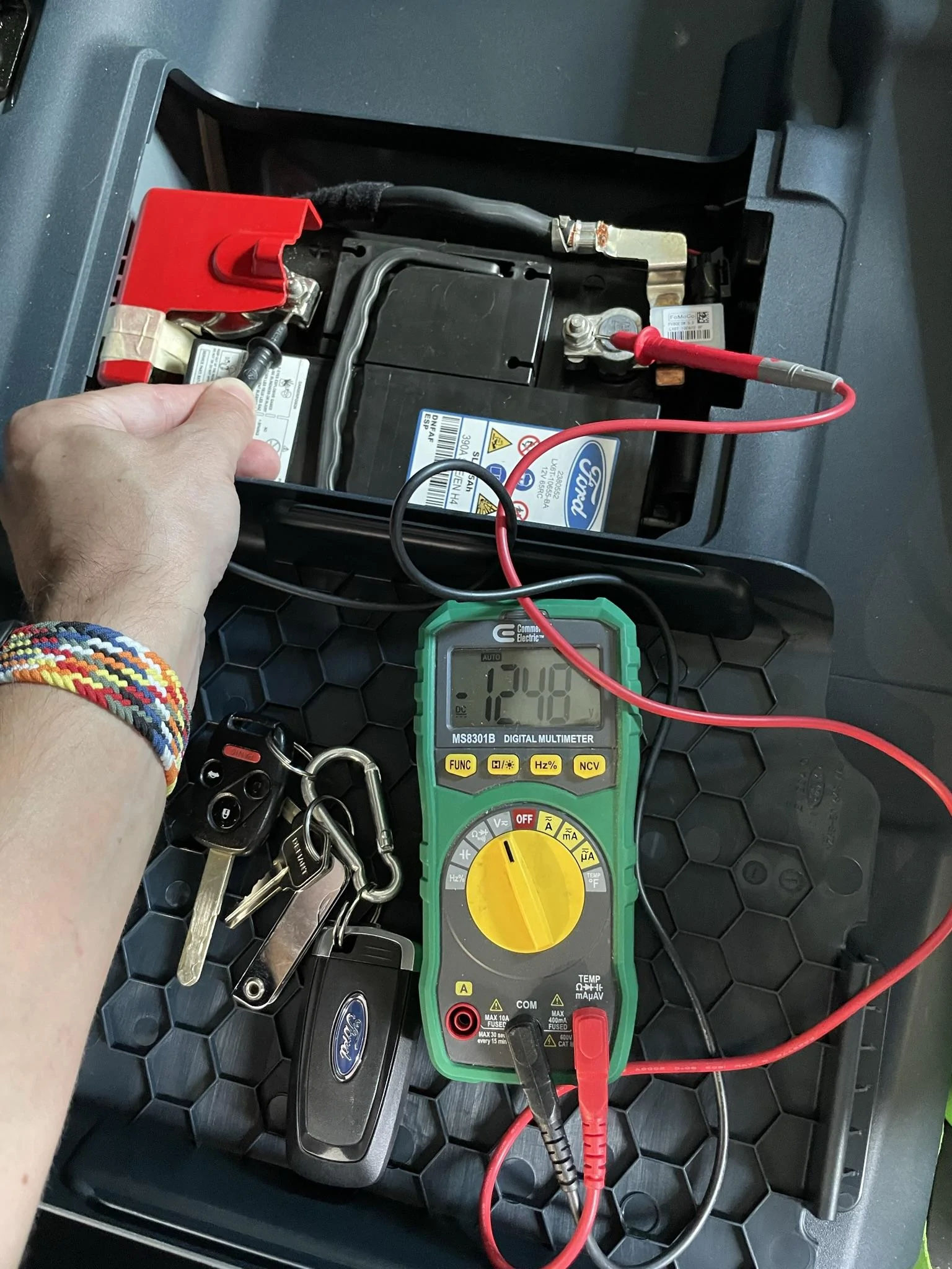

Got a ride home to get a multimeter. Battery looks good at 12.5v, engine bay connection point is 2.1v or so if I'm reading this right at the correct points. (EDIT: Also same 2.1 voltage at the red-cap jump point, and not just the lug terminal there in the picture. I tried to access some other hot point along that harness but I wasn't able to figure out another location to poke.)
Sure looks like the typical bad harness issue...
That honks. As per Miskomd's posts, is the cable termination behind the one you are checking solid? I believe that's the termination from the positive harness, and the one in front supplying the DC/DC inverter.
Good luck!
Good luck!
I didn’t really see a way of accessing the lug behind/beneath the one in my pic unfortunately so I can’t say. Was that the one people are having the solder issue with? If so I have misinterpreted a lot of pics!
I got the Mav towed to the dealership. For science I first asked the tow guy to help me jump the car just to see, and it booted up immediately when he connected the cables (I guess the HVB contactors close and the dc to dc converter takes over at that point and provides a solid 14.something volts to the system?).
That was convenient to drive it into place on the tow lift. When I powered it off the poor bastard immediately dropped 1000% dead just the same way again, unfortunately, but as expected.
Most of the pictures show the forward cable termination as the failed one, but it seems like the one behind it would be more likely to give the symptoms you describe.
I think you are right about how the jump brings it up, and the HVB keeps the relays pulled in until the truck is shut off again. That would explain why the hybrids don't seem to be dying on the road. At least that's a good thing.
Hopefully the dealer gets you sorted soon!
