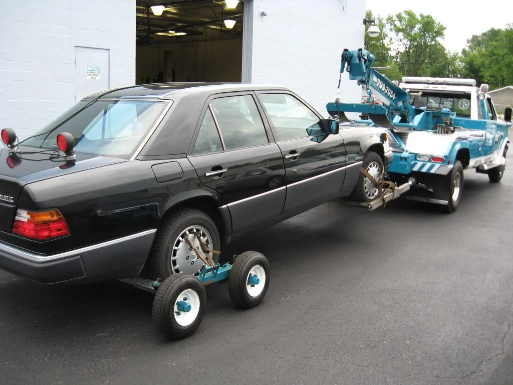

Last resort: jack up the front wheels and place a wheel dolly under each wheel. then push it out of the spot so the tow truck can get to it
