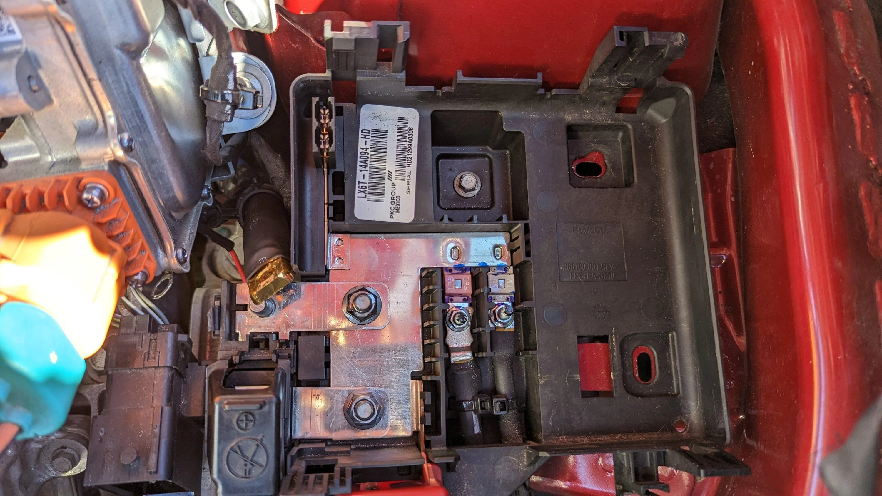

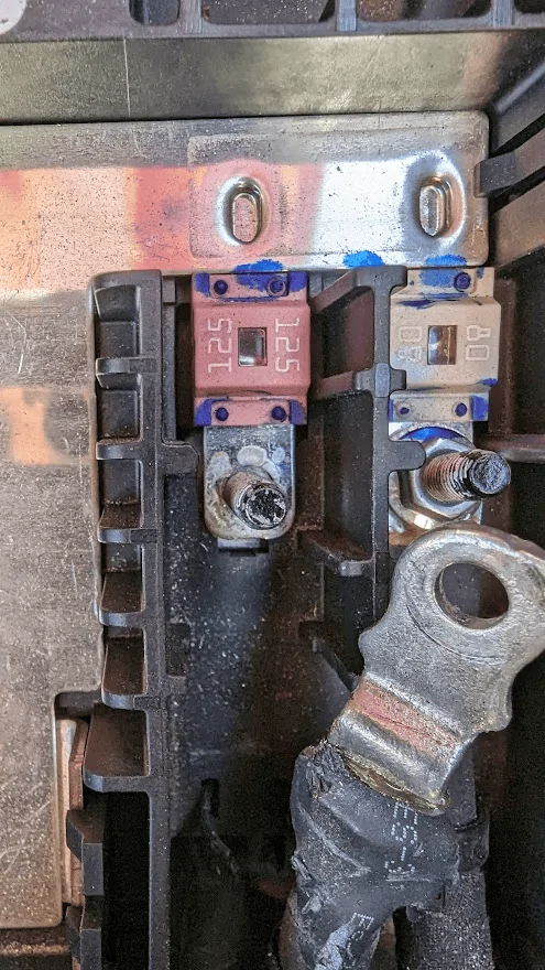

Here is a new one for you. I am dead in the water right now too.
I did the "fix" in February already. As you can see in the first picture. All good since then. Recently I noticed that the screen reset some time while the truck was off. It happened a few times but never a dead truck. Then a few days ago after leaving a restaurant the truck was dead but came alive after a few minutes cusiing at it. Then this morning it was dead again. This time for real. Got the meter out and sure engough I got 3.6 volts under the hood. I figured I check my cable again. Once diconnected I had 12 volts coming from the battery. When connecting back to the terminal it dropped to 3.6 volts again. I figured I follow the path of flow and started to disconnect the cable that goes to the 125 amp fuse. Once disconnected I had 12 volts all across the distribution plate. So I connected the small cable with a short wire to the cable coming from the battery and the voltage dropped to 3.6 volts. I took of the wrap all the way to the bare wire until I had a solid connection and tried again. Same result. I don't know what that cable coming from the 125 amp fuse is for and where it goes but it prevents the truck from even taking a jump. We are towing the truck behind our RV and it now sits at a Ford Dealership in Las Cruces, NM. They have never even heard of the first issue, let alone this one and only 3 technicians that are hybrid certified. God only knows when they will be able to look at it. I am suspecting a loose connection somewhere down that cable or a related failed ground connection. But where to even look for it.

Consider that wire could be involved in closing of hvb relays and also there could be a bad ground within or of the box. The wire with 3.6v which plugs into the 125 amp probably needs to have at least 6/8/? Volts to trigger relay. Does the wire have the 12v when it's unplugged and drops to 3.6 when plugged in? You may be on to something here.
That's the power connection from the Underhood Junction Box to the Body Control Module.
Darnon informed me that that's the power connection from the Underhood Junction Box to the Body Control Module.
Once you apply 12 volts to the cable, it drops to 3.6 volts. So, either some bad connection somewhere within the cable itself or ground or maybe a bad BCM.
It's definitely an interesting one. And it's sad that we must do all the digging for answers. Dealers really should be updated by Ford on well-known issues. At least this dealer was really interested in what I had diagnosed so far. You don't get that too often.
Or something connected to the BCM is overdrawing/dumping current to ground as it's functionally the passenger footwell power distribution fusebox.

And don't forget the Smart battery junction unit under the hood. Mine was causing issues and was replaced -
